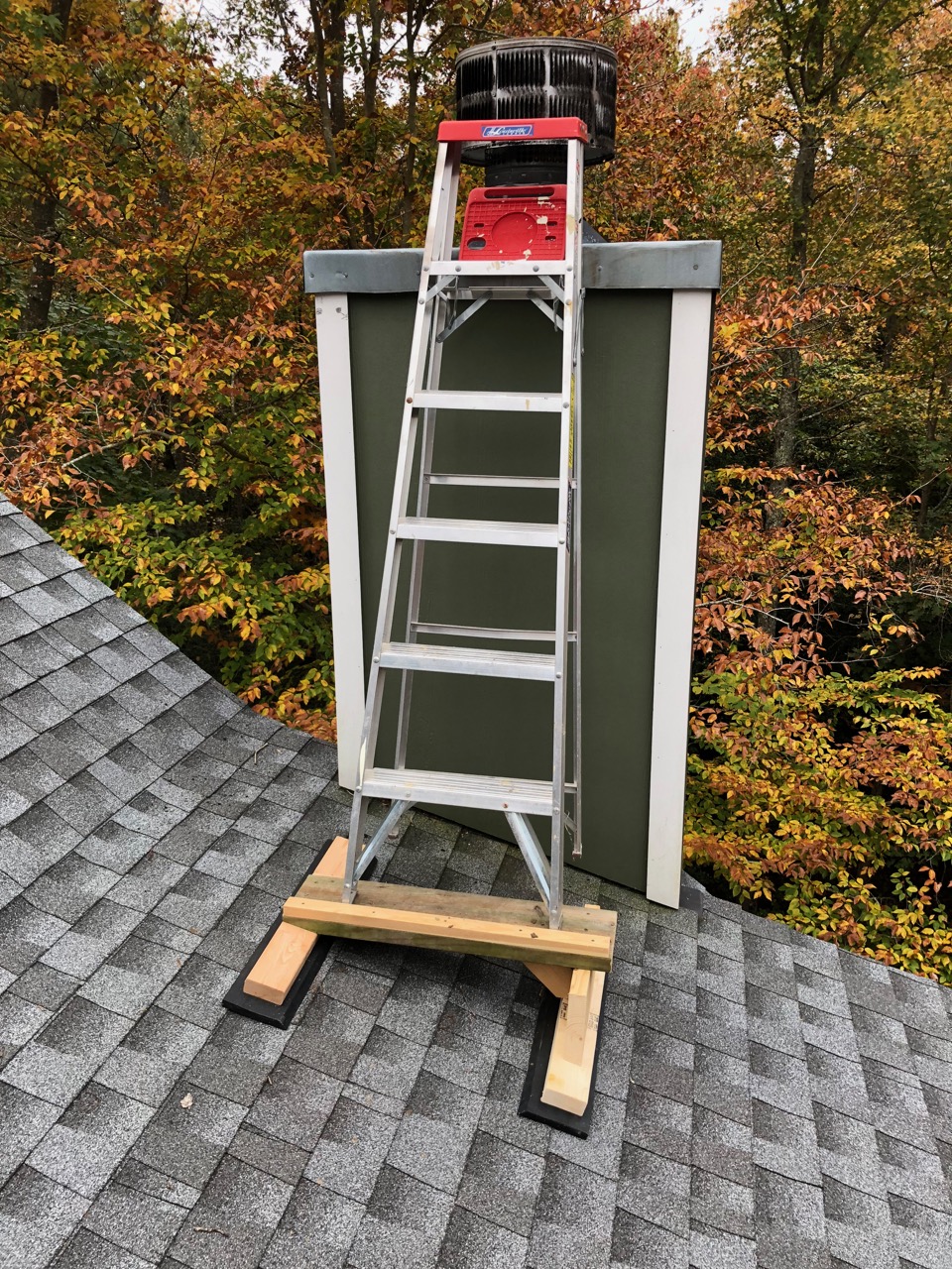

Curious why you are not cleaning from the bottom up. We have a 32ft flu. Chimney guy comes every other year and cleans with a drill, brush, and extensions. Runs a camera up when done to check the work and flu condition. All done from the ground at $150 per cleaning.
I could do that every other year and I may take that approach next year, but I definitely want to get up top periodically to wire brush the louvers on the chimney cap. They accumulate ash over time and close up the area which will start to restrict flow. And it's good to periodically inspect the ran pan, collar, etc.
