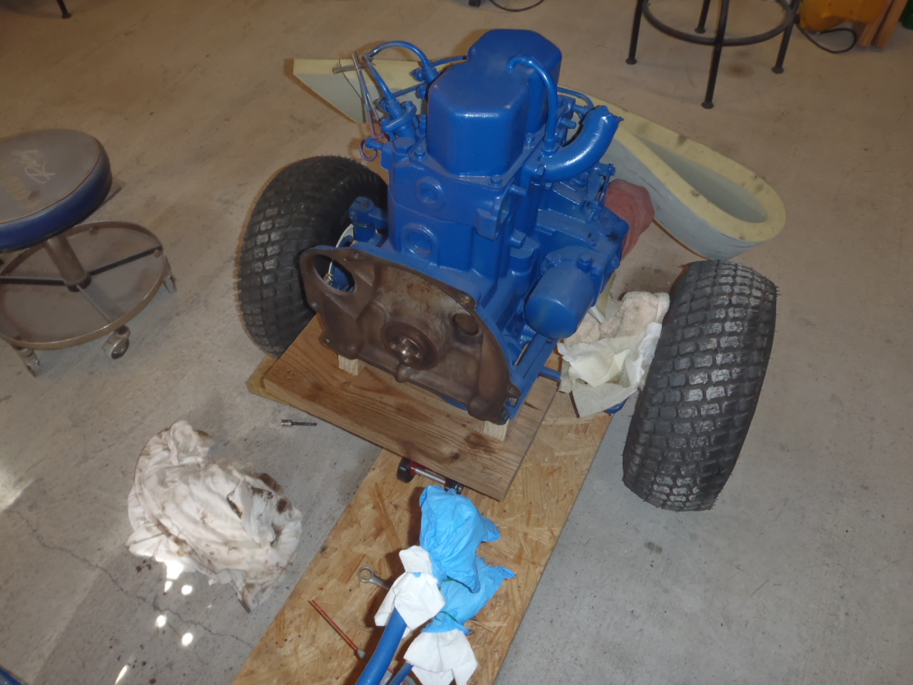

I am in the process putting my satoh back together got the wheels on went to move it pushed the clutch down did not release? I put the same clutch linkage back on it when I finished painting it. any help would be great. thanks

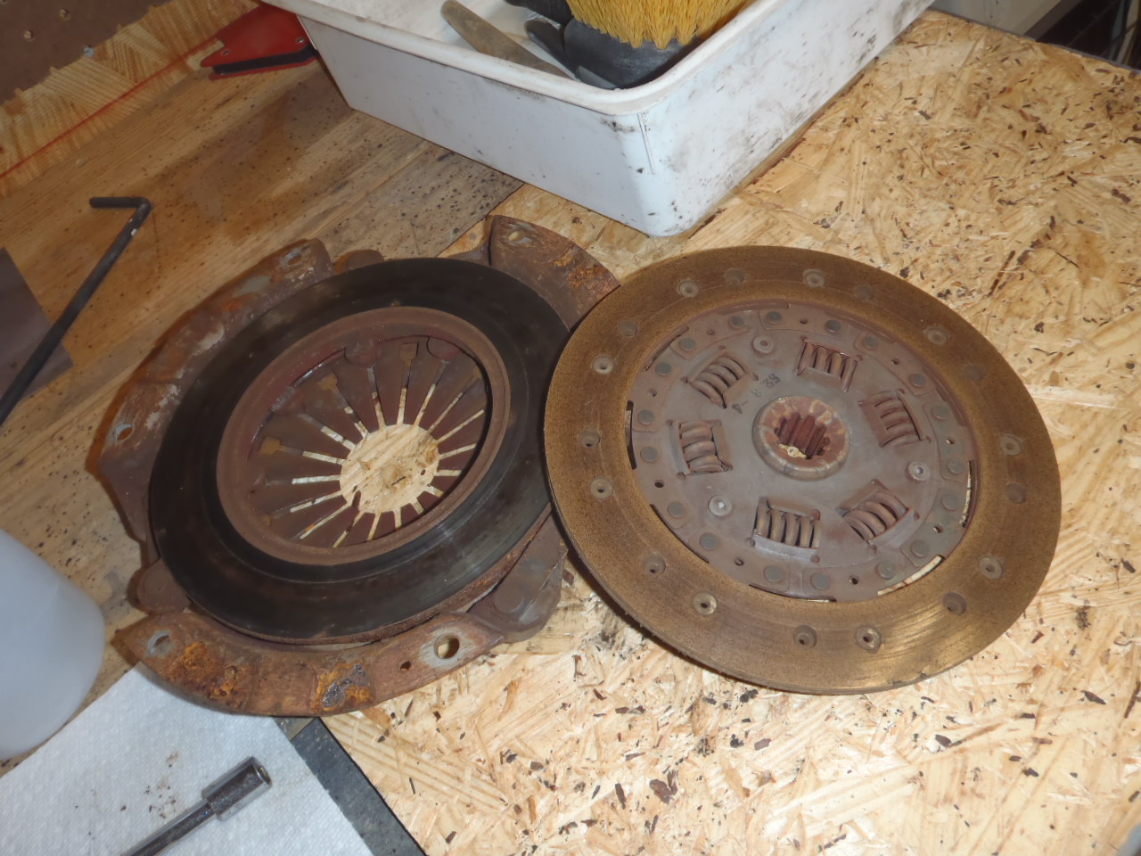

Pretty sure there is lots owners that have had stuck clutches. My S373D did it. They just stick themselves together with rust, and do not disengage. Tried going through where the steering box mounts, no access. Ended up splitting to fix.

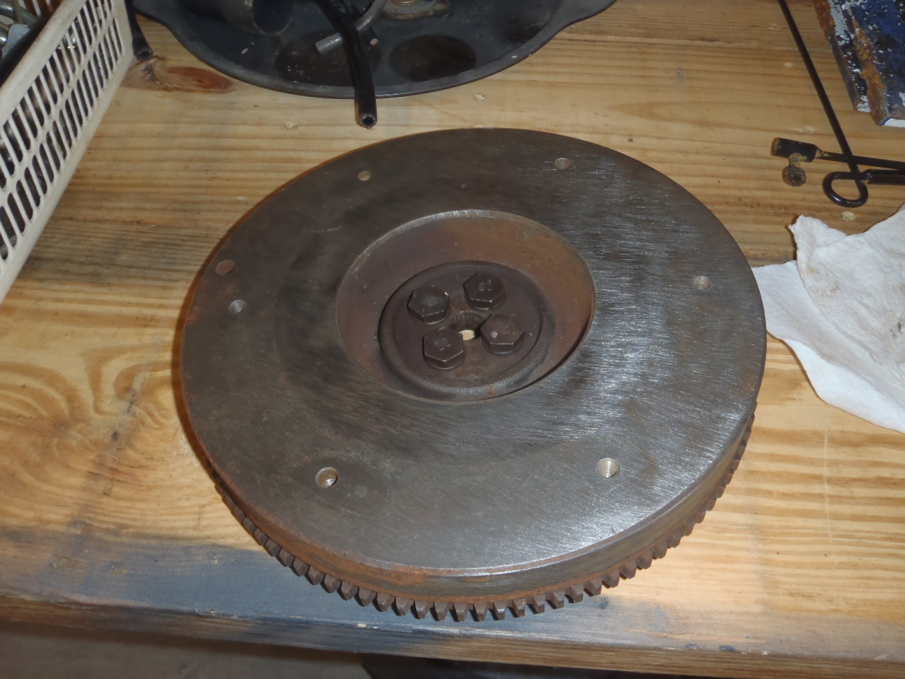

it is mechanical was working ok weeks ago when I took it apart for painting. will separate and check clutch psi plate an all not sure when it was last changed good time as any to check and fix now.thanks

have new clutch psi plate release bearing and new pilot bushing installed now
