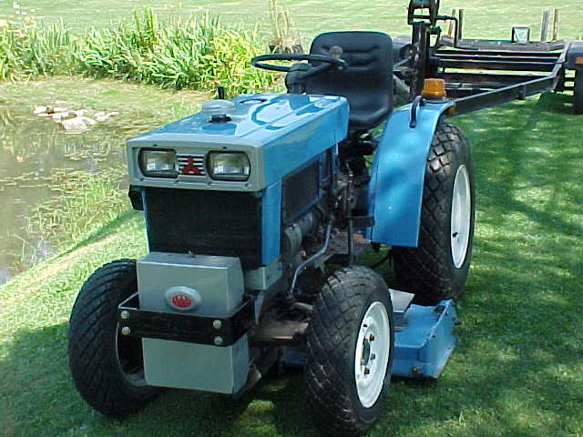

Ford used two different blues for their engines. The dark Ford Engine Blue is almost a perfect match. I've used it on my S470D. Bill - satohparts.com
   / Satoh dark blue paint? #7
I used Ford Grabber blue to paint the sheet metal on my Mitsubishi MT372D. Very good match, But, I think the Satoh frame blue is a different shade/hue.

Grabber Blue is a good match for the Mitsubishi gray market such as D1850, D2350, Etc. It matches Al's MT372 because his is one of the last produced and they changed the color scheme. The dark Ford engine blue is still the best match for the Satoh blue. BIll
