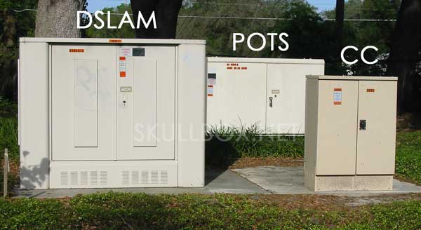

I don't know but I'll try to give a quick summary. Sorted from best to worst:
Fiber internet: Google fiber, etc. Almost never available in rural areas. Requires fiber optics to be installed. Speeds up to 1 gigabit per second. Usually unlimited data (no data caps)
Cable internet: Seldom available in rural areas. Requires coax cable to be involved, only available where cable TV is also available. Typically speeds up to 30-50 megabits per second. Usually unlimited data though some of the scummier cable companies are starting to impose limits. Which reminds me of another drawback, you're dealing with cable companies, which have some of the lowest customer satisfaction ratings in the world.
DSL: Uses existing phone lines, but does not tie up your voice line. This is the most commonly available option in rural areas, but still not widespread in rural areas, lots of gaps in coverage. You have to be within a certain distance of a DSLAM (which is a certain type of telco box, see picture below). Speeds available depend on how far you are away from the DSLAM, right next to it you might see 20 megabits per second, down to 1 or fewer megabits at the far edges (like 3-5 miles). Typical customer speeds are around 5-10 megabits per second. Typically no data limits.
WiMax/LTE: Uses cellular data services. Can be fast, over 10 megabits per second, but expensive and usually comes with data caps, the more you pay the higher the data cap. $100/month might get you a 10-20 gigabyte per month data cap. Unreliable, speeds and availability vary widely throughout the day. Usually requires a 2 year contract with the cellular carrier.
Satellite: the absolute last resort if you can't get any of the above. Usually can't be used for telecommuting because the propagation delays caused by the distance between you and the satellite mean employers' VPNs don't work. Usually with data caps. Speeds 5-10 megabits per second but usually don't provide advertised speed. Unreliable, can go out in bad weather. Often use dial-up for the upload leg. Usually requires a long-term contract
Dial-up: the worst of the worst. Speeds of about 56 Kilobits (i.e., 1/100th of a 5 megabit connection). Unacceptable for anything except simple web browsing (no graphics) or simple emailing. Runs over your phone line and ties it up while you're dialed in.
note: A DSLAM: dslam.jpg

Thanks for that pic Geek. About 7 years ago, ATT had fiber optic cable run on county road 1/2 mile from my house in Georgia. Those DSLAM boxes are 1 mile. Still not connected!
If there isn't a high enough concentration of customers per mile of line, they won't put in a tap to connect a customer or two. I have a BIG fiber backbone runs 35' from a house and can't get connected to it.
