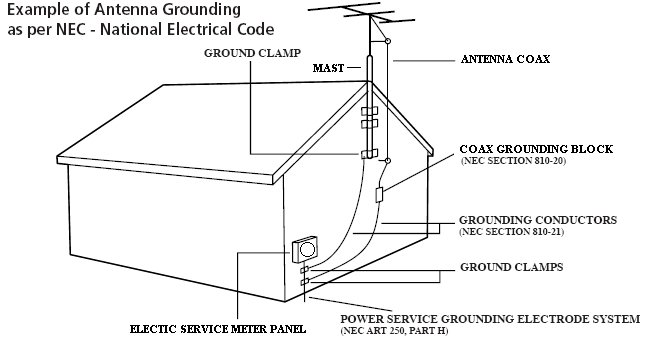

How is attaching it to the chimney "self grounding" ? The messenger wire is to attach the cable at the pole and the house, not really for grounding.
The chimney is masonry, concrete, brick, rebar, metal liner.. If a separate ground is run to the chimney is it usually just connected to house ground?
If possible, back to same point with outside panel. You'd normally have a ground block before it enters the house, that is grounded at panel.
If its in an attic, not required. I will say that mine comes from the attic into wall mounted cabinet that is all grounded. The house amp (Coax shield) is grounded though the cabinet power. So mine is all tied together.

The chimney is not a ground source in any way shape or form. Ground is metallic usually a copper wire all the way to a ground source, typically a ground rod or electrical source single point ground. Some newer homes will have a ground block outside by the meter but not in all cases, depends on the builder and local code.
That is a good diagram. My antenna will not be like that, it will be on the side of the chimney, below the top of the chimney and below the peak of the roof. The metal flue liner and metal cap are the highest points of the structure. I never expected to use the chimney as an electrical ground, just mentioning it was going to be sort of grounded virtue of the fact that it is on a mansonry chimney.
