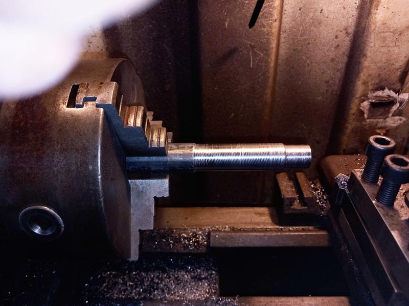

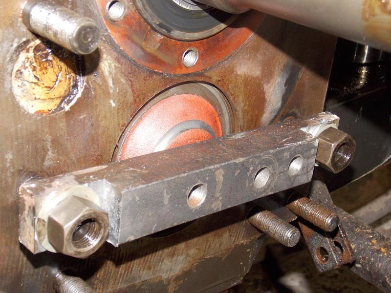

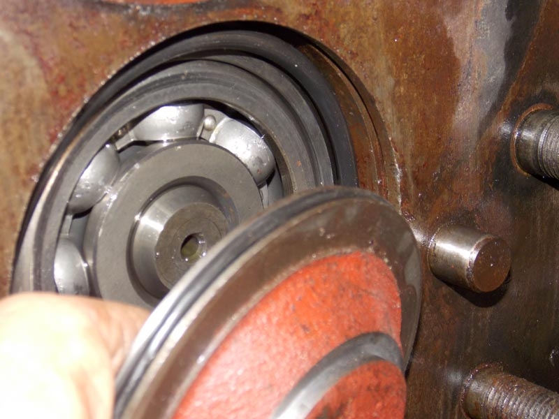

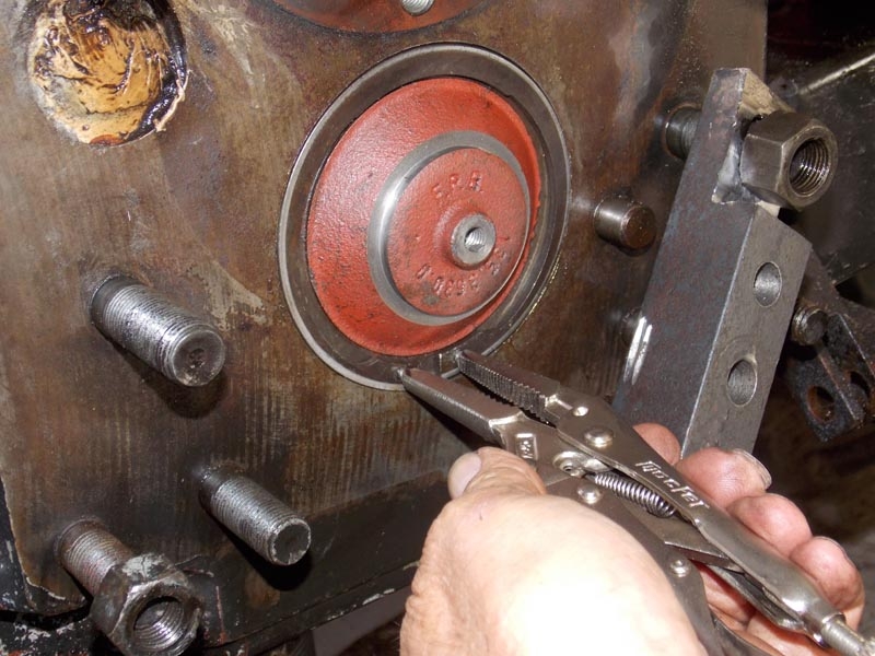

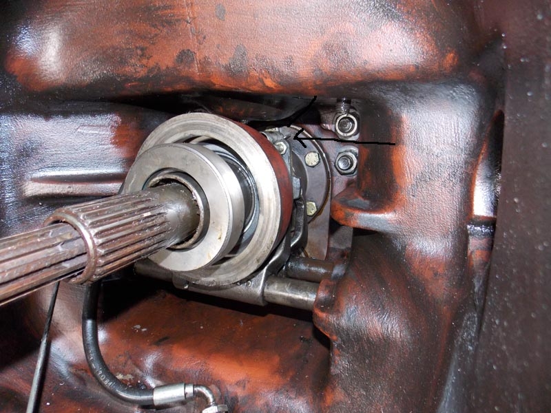

the inner Oring is 5mm and the cover needs to be pressed against it with some force before the big circlip can go back. So I made the press bar from 30x30 stock I found in the workshop.
I made a test fit first, then pressed it in with the extra Oring.
The local bearing shop didn't have a big enough Circlip tool, so I bought needle nose vise grips and ground the tips down.
throwout bearing collar reinstalled with new seals, 2 of the 4 diabolical bearing return springs are on there too.

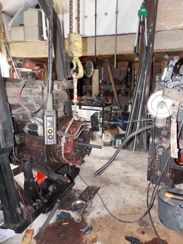

Bell housing hanging from the hoist for reinstallation.
I managed to reinstall all 4 diabolical return springs in just 1-1/2 hours. only one can be partially seen.
I should have the rear main engine seal tomorrow, so I can get it all back together.

Those springs do look like a lot of fun indeed in that little tight area. Great job holding that thing plate on the lathe to cut the groove.

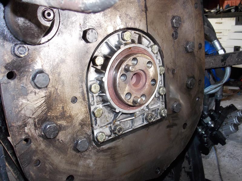

The rear engine seal finally turned up, so work could continue.

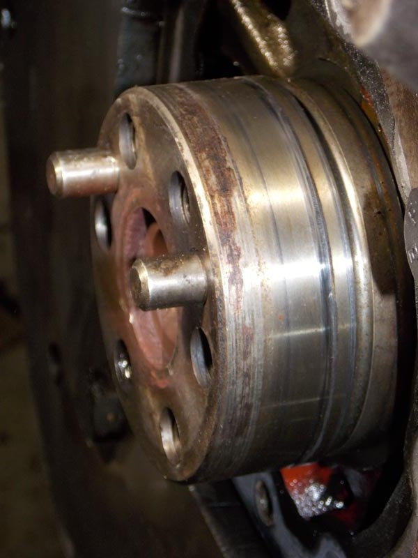

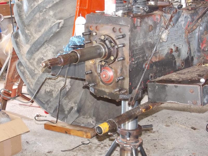

There's a pretty bad groove worn into the crankshaft journal, so I set the new seal on the outer edge of the housing, about 3mm out from the seat, so the new seal rides on undamaged metal.

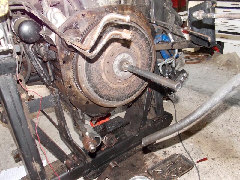

I made an alignment tool for this tractor 6 years ago; I think I used the metal for something else. Anyway, it's quicker to make a new one than to find the old one.

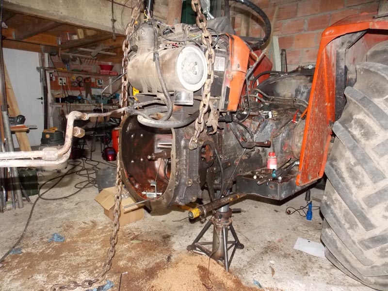

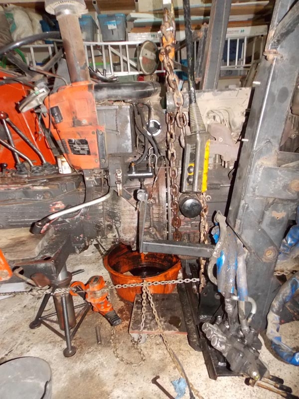

The double clutch assembly is a bit heavy to lift be hand; and why should I when I put all that work into putting in the gantry hoist?

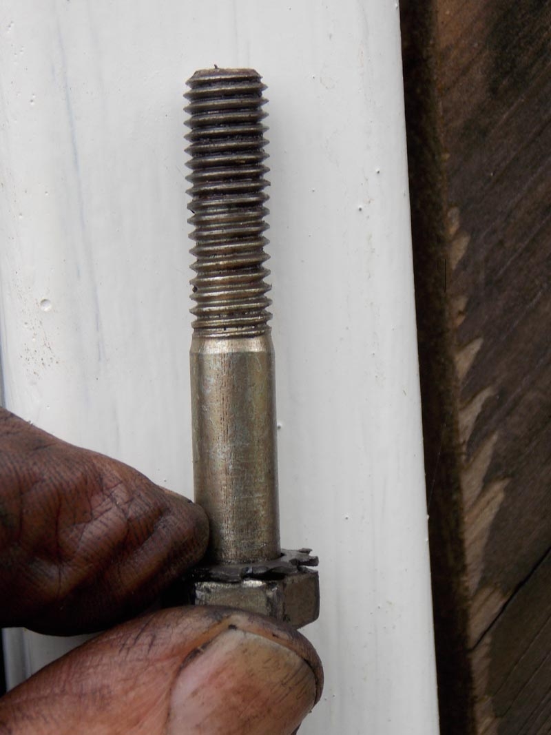

2 of the clutch bolts are stretched; can you see it? I felt it continue to stretch when torquing, so pulled them out and replaced them.

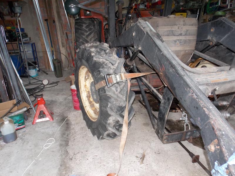

To get the halves in alignment, I needed to steer; that was done with a ratchet strap.

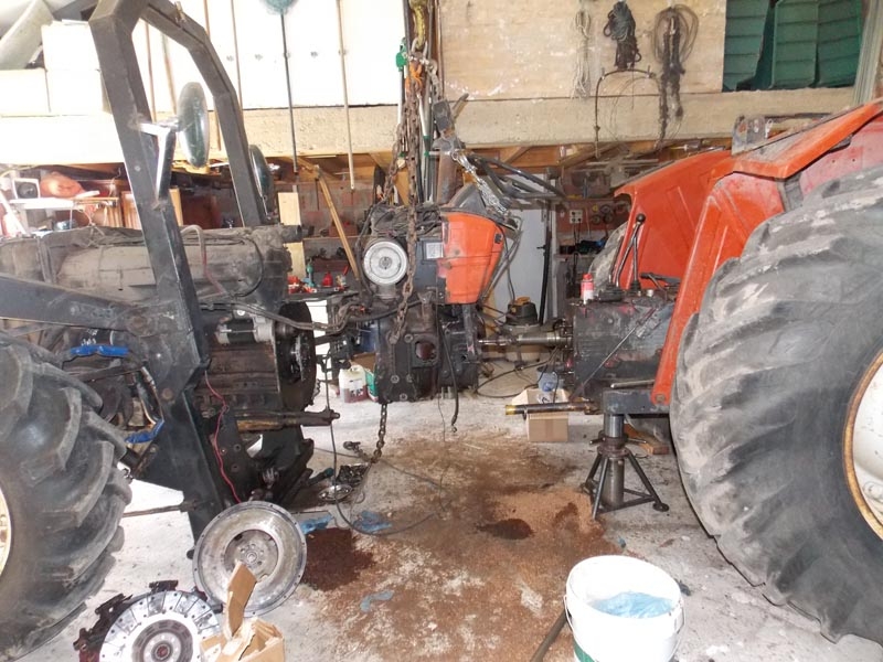

slowly coming together again. This is actually fairly tricky. 2 spline shafts, lots of linkages and tubes to worry about, and getting it all lined up.
A little twist on the PTO shaft to get the PTO spline into its clutch plate.
The tractor is one piece again, but there's still a lot of reconnecting to do

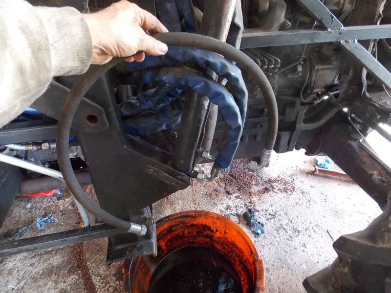

All reassembled; while checking the hydraulics, I found a leaky hose.
This tractor has 10 hydraulic hoses that are all the same (after my modifications), so I have a few spares in stock.

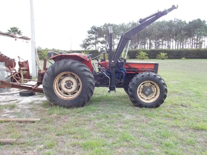

And ready to work; I have some tractoring work pending by now.
   / SAME Mercury 85 oil leak in the bell housing #16
And ready to work. Great job on the repairs Mark.
