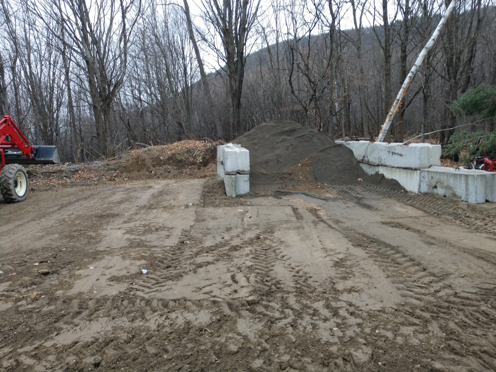

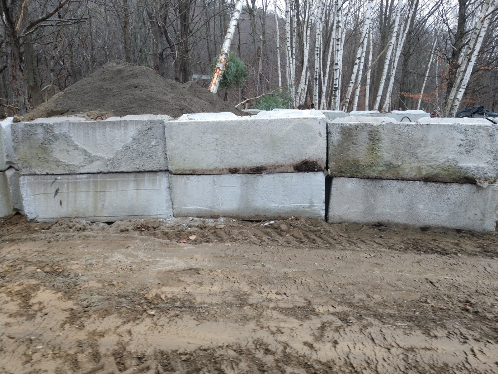

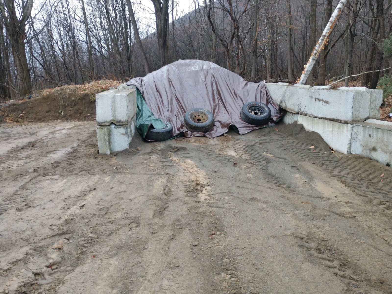

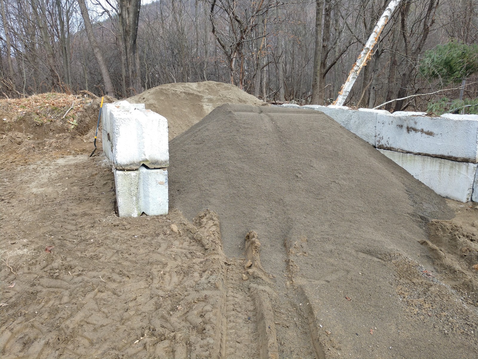

I did a bunch of work to my sand pile this year,
this coming year I want to redo this work and add a cover all type building to it.
Even just an 8 or 10 foot tall one will clear my tractor and make it much handier I believe.

Haha. Your tarped pile looks like mine without the snow and ice. ;)
Yep, contained like it is it hasn't been to bad this year to clean the snow off of it.
I roll the tires out of the way and using the loader bucket back drag 90% of the snow of and out.
When it was just piled and covered it was more difficult to clear the snow.
My intent this coming year is to add one of these to the top of the blocks;
12'W x 2'L x 1'H (Barn Style) - Rhino Shelters
