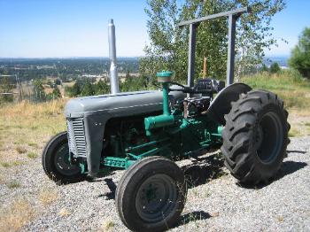

I put a ROPS, seat, and seatbelt on my Ferguson. All together it cost about $500. ROPS are available if the tractor was common. There are so many grays out there that you might have trouble.
