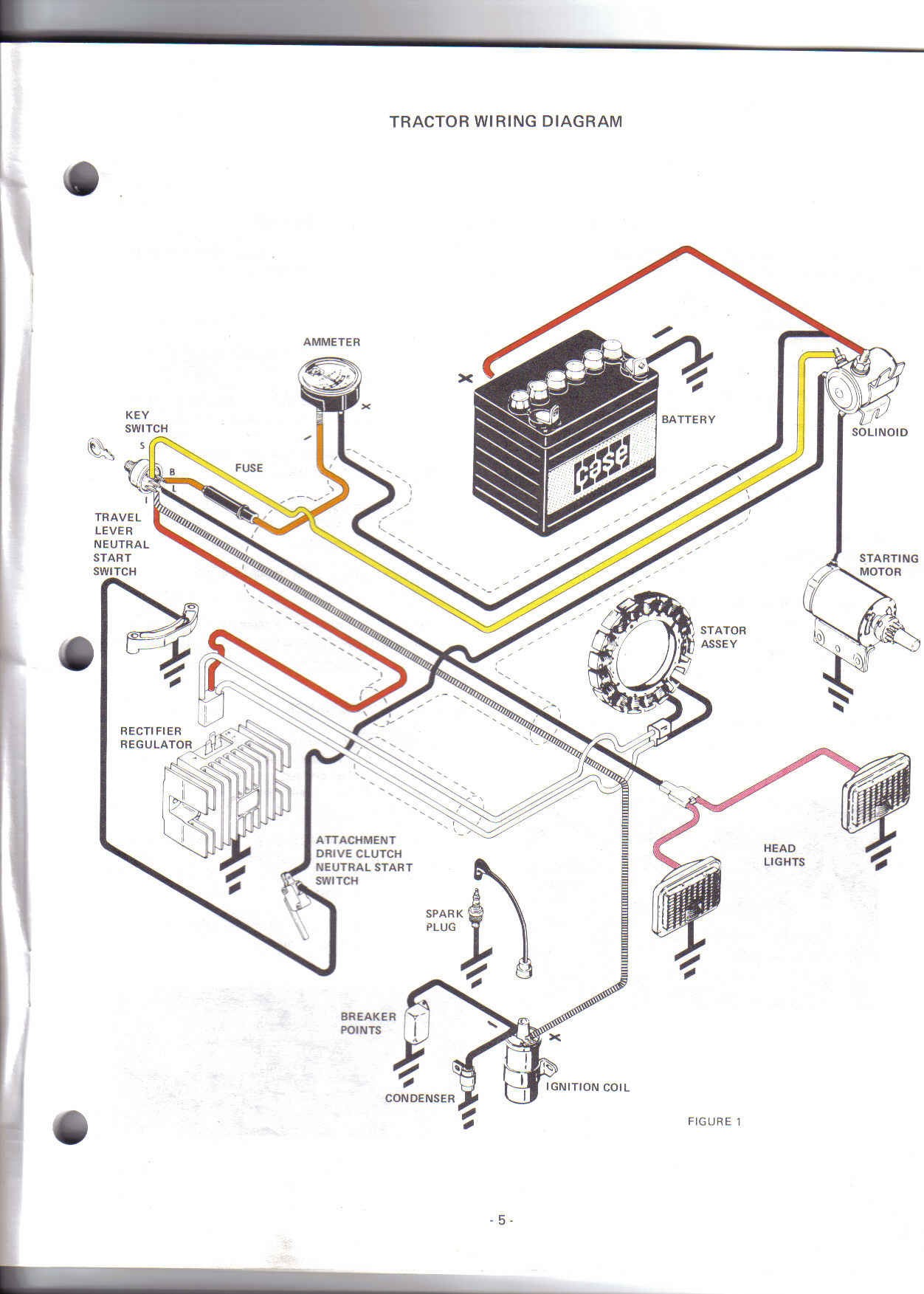

Apr 22, 2009 / Safety Switch On Case 446 HELP!!!!!! #1 L LionsFan815308 New member Joined Apr 22, 2009 Messages 1 I need advice and a wiring diagram on how to fix the starting problem. Please send any info to Lionsfan815308@gmail.com THANKS!!!!!!!!!

Dec 2, 2009 / Safety Switch On Case 446 HELP!!!!!! #2 brother777 New member Joined Dec 2, 2009 Messages 2 Location KC, KANSAS Tractor CASE 446 (made in 1975) I have your wiring diagram. Am having trouble with the same thing. I think it's the only "plastic" on my 1975 446. See wiring diagram attached. Attachments wirediag.jpg 263.8 KB · Views: 8,423
