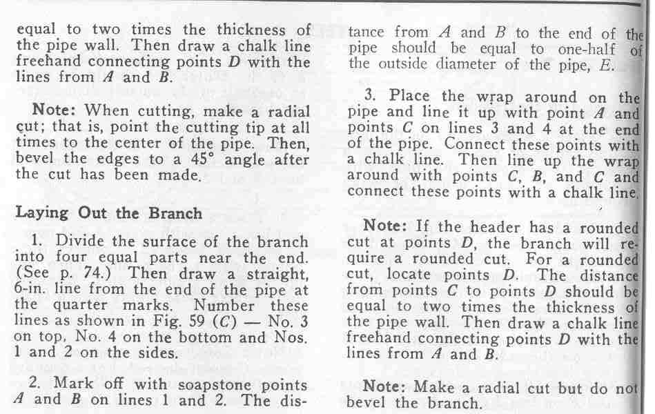

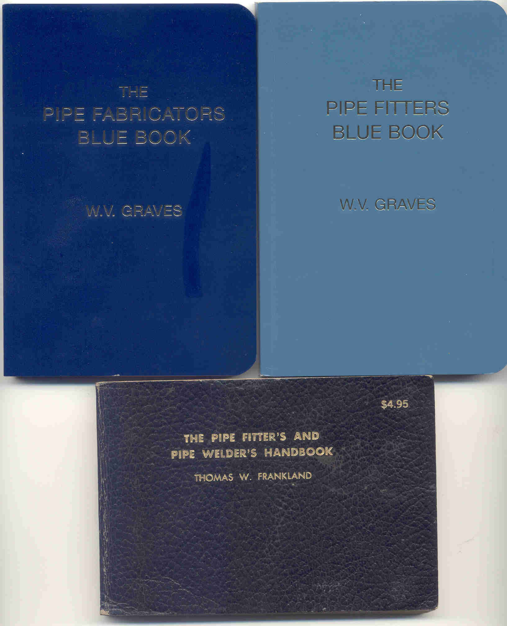

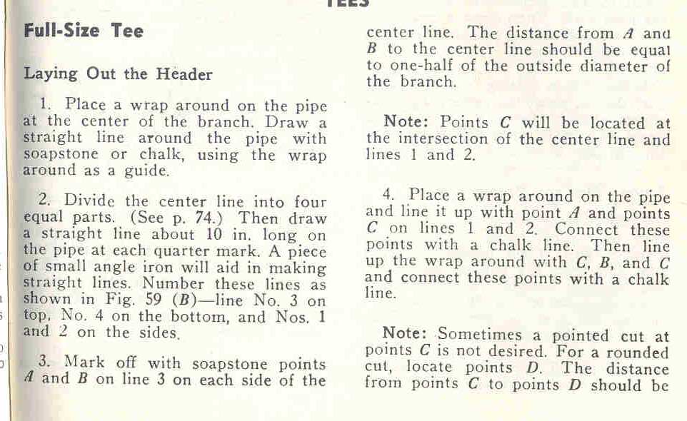

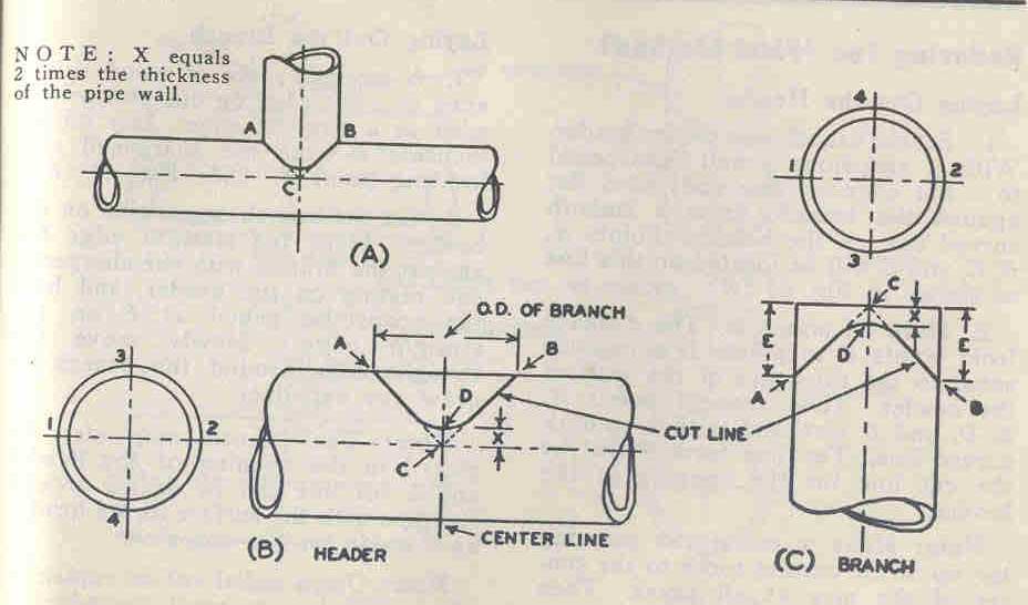

How do you make saddle joints in a 6 5/8 pipe
   / saddle joints #2
if you google arround a little you should be able to find an old program called 'tubemiter'.
you tell it what angle the pipes intersect, the pipe OD, the pipe wall thickness, and it will create a cutting template that you print and wrap arround the pipe.
   / saddle joints #3
A pipe wrap can do it also. Kinda a speed square for pipe. Not expensive but takes careful math.
   / saddle joints #4

   / saddle joints
Thank you guys Your help is greatly appreciated
   / saddle joints #6
Shield arc to the rescue! You have one of the best welding libraries of anybody I know.
