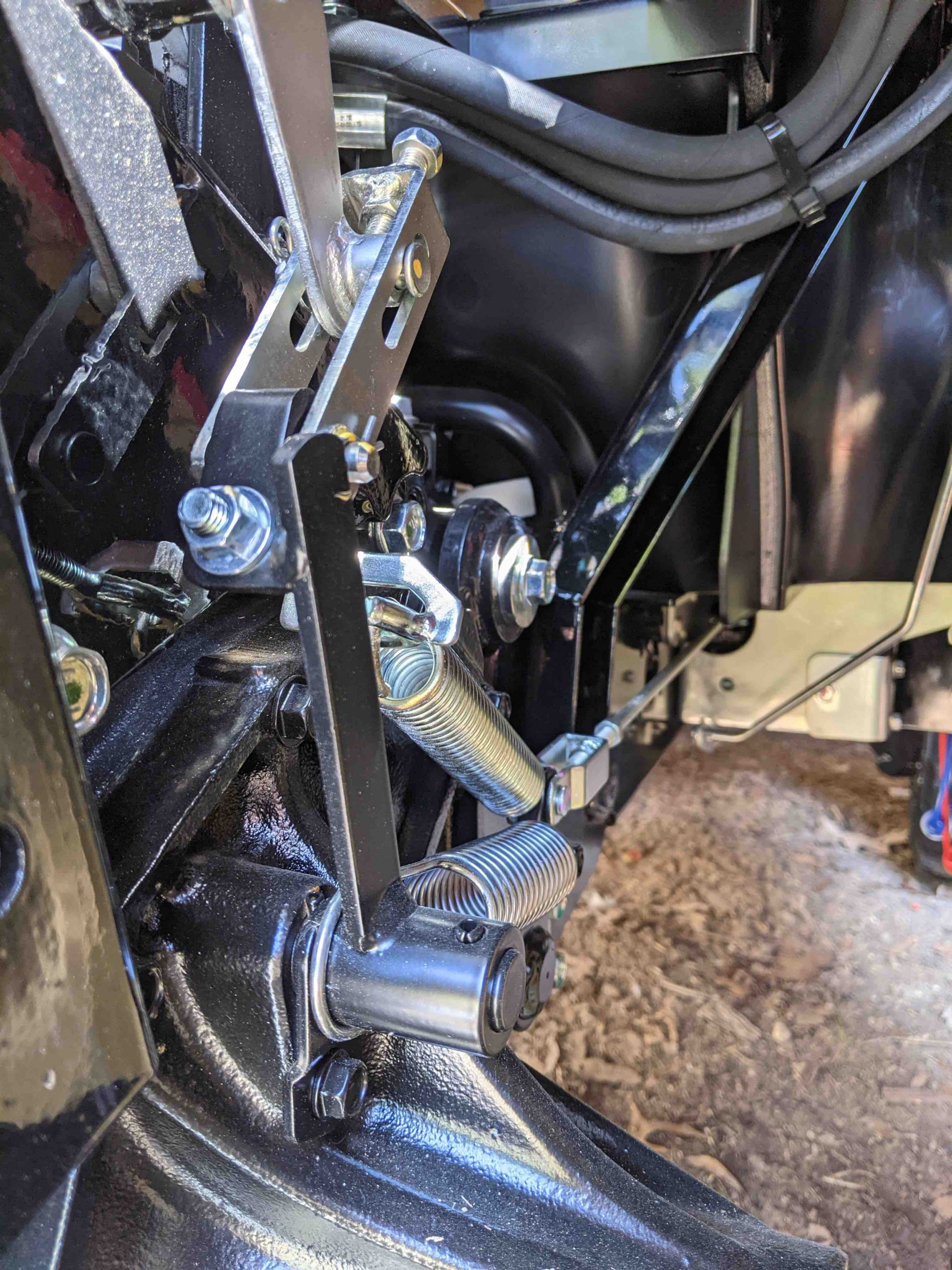

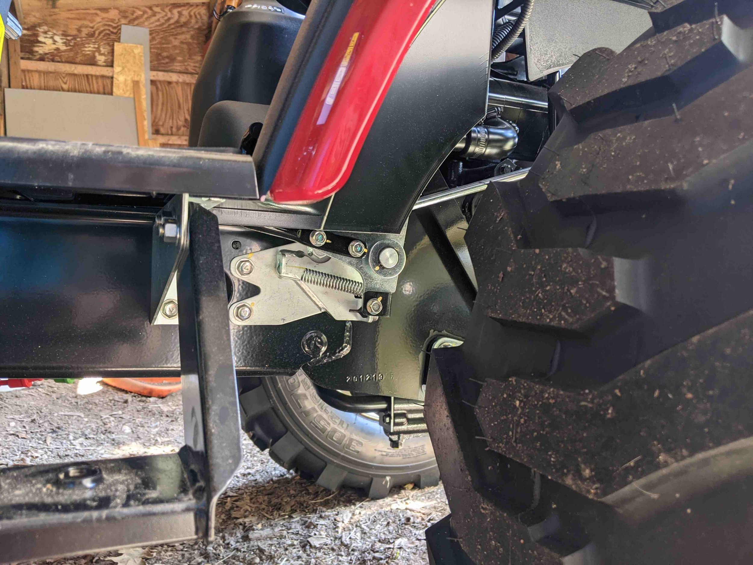

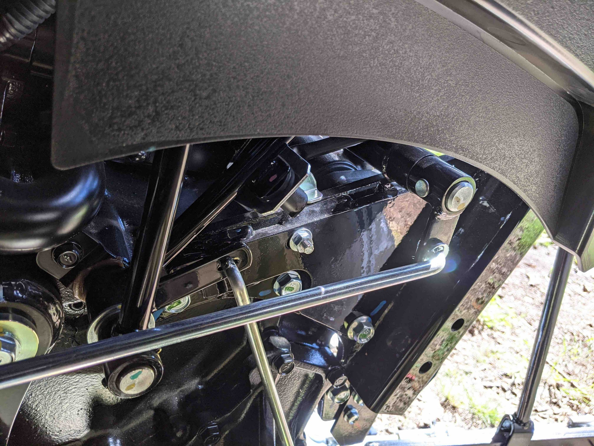

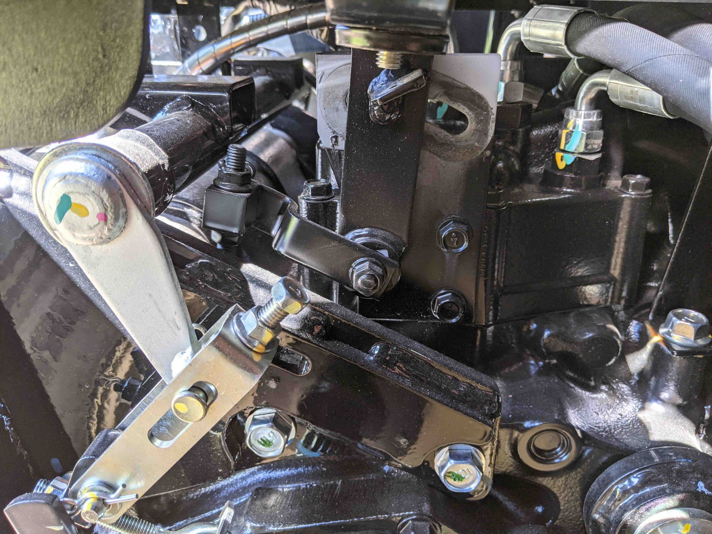

Thanks! Below is a sequence of photos showing the diff lock linkage, which goes aft from the pedal, up over the transmission to the right side, and down into the differential. It sure is a lot of levers, rods, springs, and tubes! Not as efficient as the custom lever that sa324owner built, but probably what most people will want:
Awesome! Thank you for those details and pictures!
