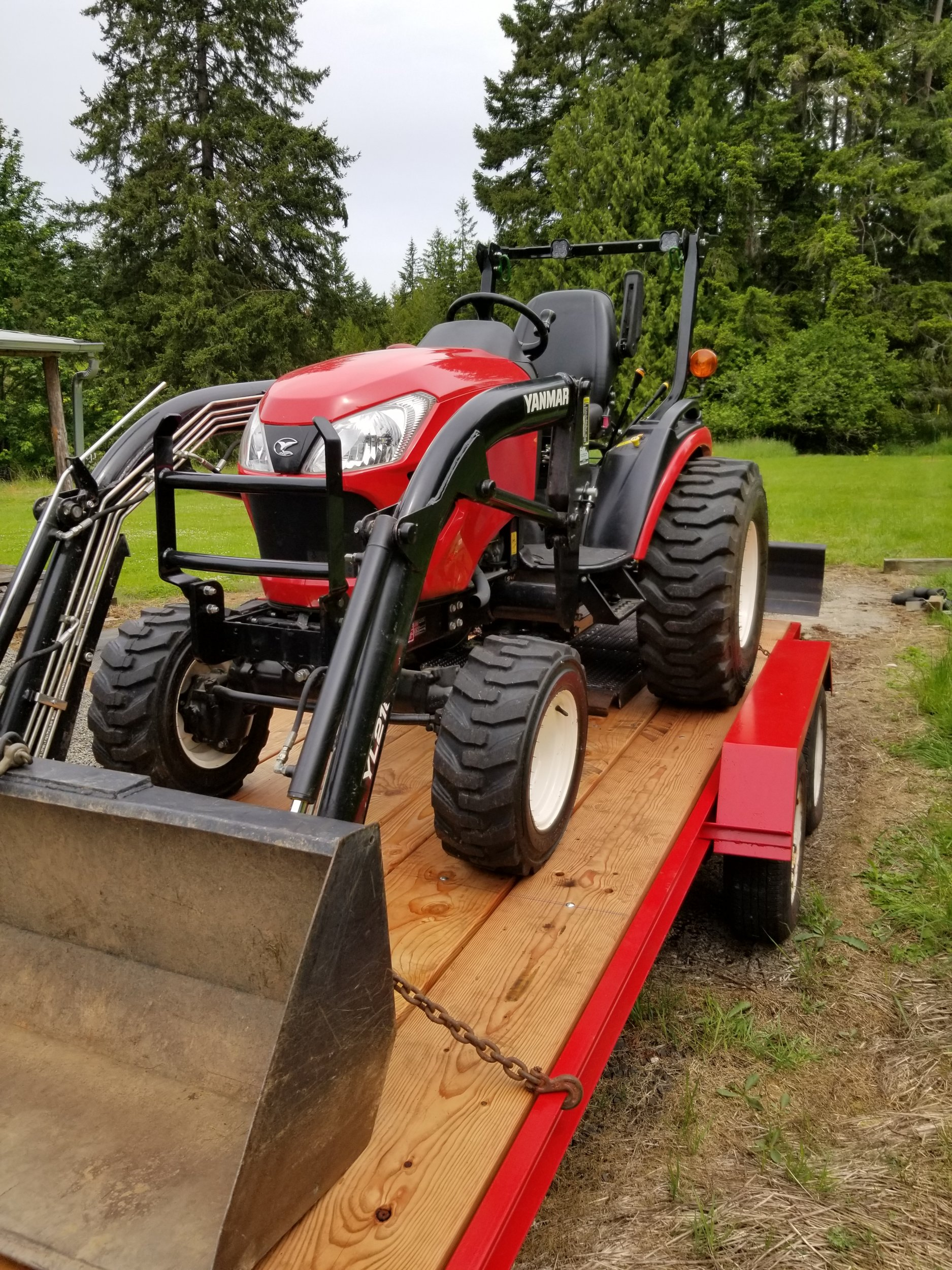

Just a quick question for the guys who have been there, know better and such.
I'm looking to increase the height and stability of my FEL on my 2015 SA424.
The hydraulic cylinders are cheap enough, and even just a foot higher is fine. It seems very doable, there is a bit of clearance between the cylinder and framework now, and most tractors in this class elevate much higher. Just putting out that idea. I'll try and post a photo of her from my phone, just joined tonight. Thanks in advance!

In case anyone is curious with the slight mods already: 4in rear wheel aluminum spacers installed only on rear, Diode Dynamics SS3 offroad floods for nighttime work, and can rotate to the rear with ROPS up for the backhoe, front bumper adapted from a newer model, and magnetic John Deere pins for ROPS. They put up a fight to remove for a magnet, but hold tight.

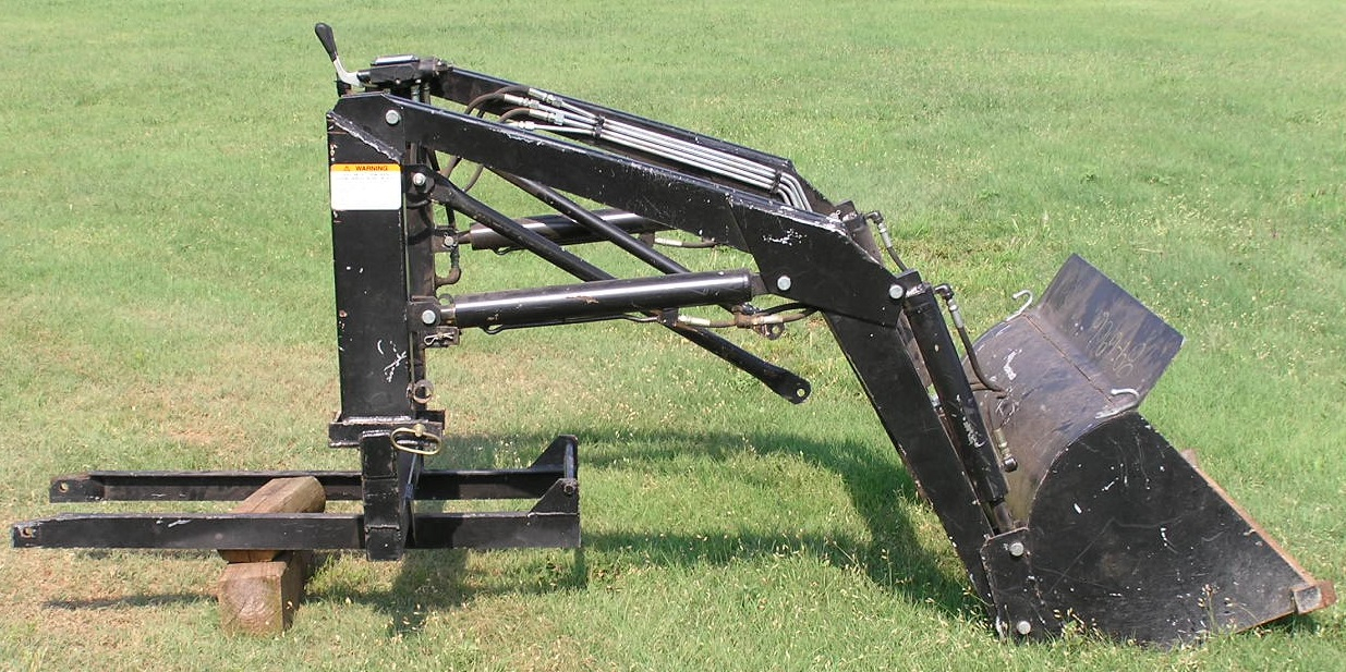

Need a straight on side view picture like this one showing the cylinder mounting points on your loader:
You might be able to use a longer cylinder with new mounting points.
