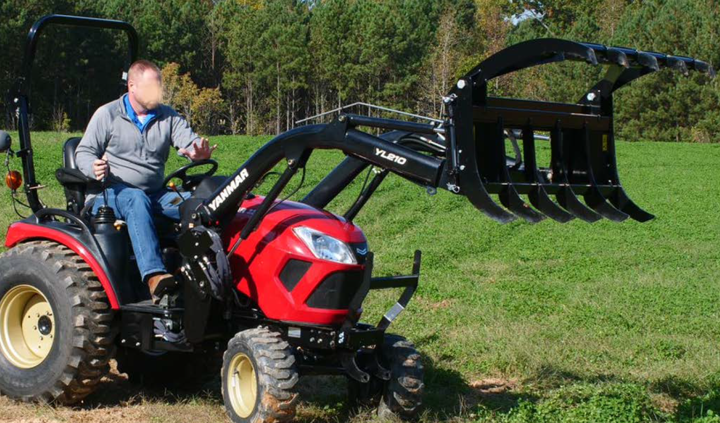

- No Grappler option from Yanmar - was looking at FEL conversion kit to skid-steer quick standard so I can open up this world - anyone done this ? (I understand I need 3rd function up front as well)
Any comments/thoughts/information appreciated.
Jimbo10,
I have been in contact with Yanmar about this and here you go:
These should be available by June:
GRAPPLE-SAP - $1800
TVK-YL210 - $575 (third function kit)

Thankyou Bogey-1. That's encouraging to hear. I couldn't open the attachment you posted (says its been removed or deleted..).
