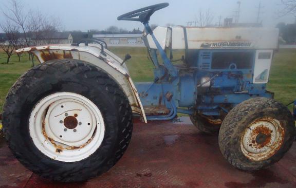

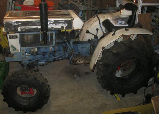

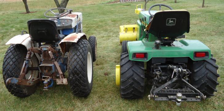

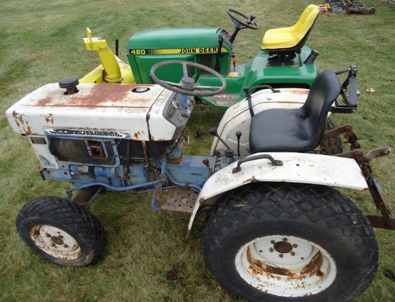

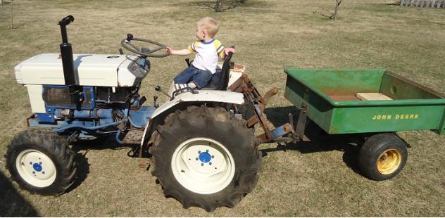

This is my 422 hour tractor I bought that had sat outside for 10 years.
Everything mechanical works fine, but it does not look nice.
Just changed the engine and trans oil, and have a set of bar tires for front and rear on the way, so its time to start cleaning the tractor up and painting it.
Sandblasted the rear rims, took 2 hours and 2 bags of sand, but they are nice and clean. Will do the fronts next, then its on to the white sheet metal. Not sure how far I will go initially, the blue will be a lot of work with all the parts needing cleaned prior to paint.

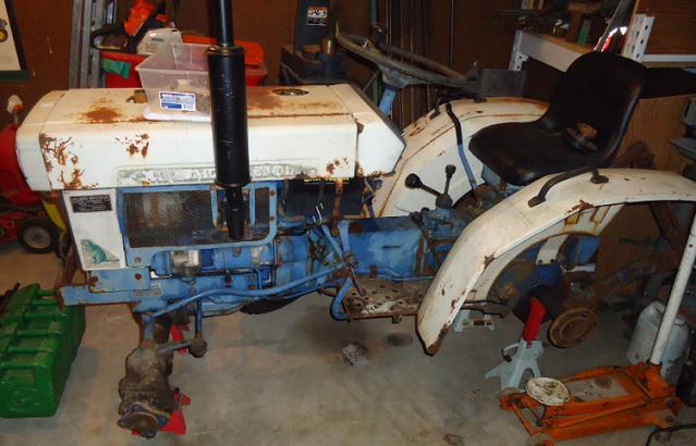

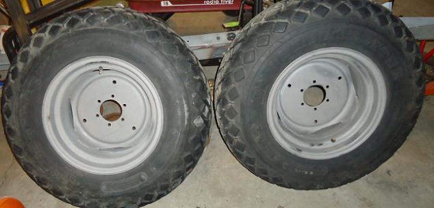

Got the bar tires today. Rears are Firestone R1's, fronts are some off brand but are practically new.
Going to take the rims in tomorrow to get the turfs taken off so I can continue to clean them for the bar tires.
Also stripped the hood with a disk in the angle grinder. I will still sandblast it, but this will make that go quicker.

Back two rims are now in primer ready for tires, finished blasting one front and got it primed. Hopefully I will get the other done this week so I can get the tires mounted next week and shoot the rims with IH white.

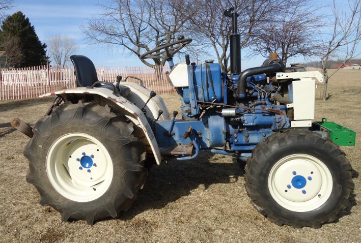

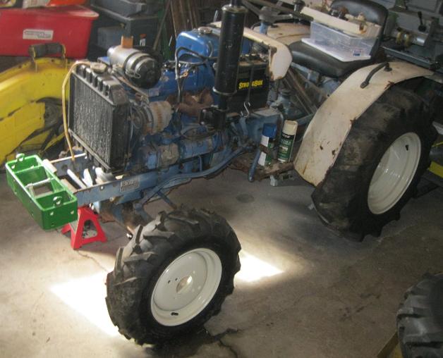

Wheels are done, tires mounted. Hood supports painted. Working on sandblasting the hood. Will bolt up the wheels after the paint has a week to cure.

If you haven't had the radiator rodded out you might as well do that while it is easy to get to. Don't let them paint it. I had one of mine done, cost about eighty bucks I think. Then I made radiator screens for both. I had some quarter inch plywood cut down to 12" by 14.75, used a hole saw in the corners and cut in between with my sawzall. The plywood frame was an inch all the way around. Wrapped acreen around it and stapled it to the plywood. It was a little tight. 14 and 5/8 would be a little better for width. Should be the same measurements for yours.

Tractor saw its first light in a while. Just got the radiator side panels on today which let me run it again.
Hood is blasted and in primer now. Have some dents to pound out then its just the dash and fenders left for white!

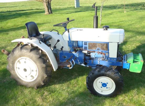

Hood done. Just the dash and fenders left for white!
/ S-373D Refurb #17
Looking good! What kind/color of paint did you end up using for the white and blue?
/ S-373D Refurb
#18
Ford Blue
Case IH White
Doing it again I would have gone with a more "white" than the creamy IH.
But, I had already done the wheels with IH white (as someone on here recommended) and didnt want to redo them. I actually like it, but now the headlight part doesnt match as well.

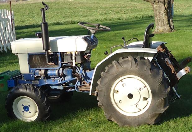

Done for now. All the white was sandblasted primed and painted. Check out page 1 for the before pictures. Its no show tractor, but a dramatic improvement from what I drug out of the weeds last fall.
/ S-373D Refurb #20
Nice job - slap some stickers on and it's as good as new :thumbsup:
