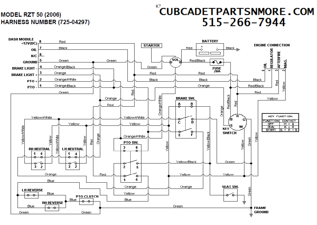

If everything EXCEPT the pto is working correctly, then the pto contacts almost HAVE to be on the wrong switch side - I.E., the two wires/terminals at the switch that control the pto clutch should NOT have continuity when the switch is in the down position, and SHOULD have continuity with the switch in the UP position.
Sounds like you're getting more familiar with the beast, it's definitely easier to troubleshoot ANY piece of equipment when you understand what's SUPPOSED to happen - I'm thinking your latest plan (post#13) will get you there... Steve

I haven't made any changes yet, but I did just now get out to the garage to investigate a bit further and now have more info about the wiring.
This is how the PTO switch is wired, with conditions tested while switch off...
Orange/White Strip-----No Slot-----Orange/Black Stripe (Normally Closed)
Yellow-----Yellow/Black Stripe-----Empty Slot (Normally Open)
Red-----Empty Slot-----Blue (Normally Closed when switch)
Both switches tested that way, but according to the wiring schematic it should be NC/NO/NO? Diagram is attached to this reply.
The blue wire runs right down to the PTO clutch, bypassing the original wiring. This was done by a previous owner and I don't yet know why.
The PTO clutch has two wires coming from it, one blue(currently running directly to PTO switch for that bypass) and one green(disappears in to main harness, should be ground).
The original blue wire in the PTO switch harness runs to the nearby RH arm reverse switch, then from the reverse switch down to the PTO(currently cut for the above bypass to be possible) according to continuity tests. According to the wiring schematic there should be two reverse switches in this circuit but I didn't confirm the other one or its status, and these are normally closed but the one I tested is worn so sometimes I have to tap it to get it back to NC after pushing its button so this may be why they were bypassed.
My guess here is that a previous owner had an issue with one or both reverse switches not fully closing after they stopped reversing, dude to the switches being worn out, so they ran the blue wire directly from the PTO switch to the PTO clutch to resolve the issue. Or they did it so they could mow in reverse.
Unfortunately I'm still not entirely sure why my PTO is engaging when the switch is down. The only explanation is that either both my switches are bad somehow and only for the part that closes/opens the PTO power circuit, or I have two of the wrong type of switches, because according to the attached schematic the bottom poles of that switch that control PTO should be normally open and if they were I don't think I'd have this issue. Thoughts/advise on how to proceed? The switch on the mower looks OEM, and the new switch is a new OEM style from hdswitch on ebay.

Needed to get the mower going so I pulled the red/blue leads off the PTO switch and moved them to a covered toggle switch. Now the mower starts and you can flip the toggle to turn the PTO on/off, PTO switch just stays in the off position. Not entirely thrilled about this setup, or the fact the reverse switches were bypassed, but it'll do until we decide to pull the trigger on a newer and more sturdy zero turn.
