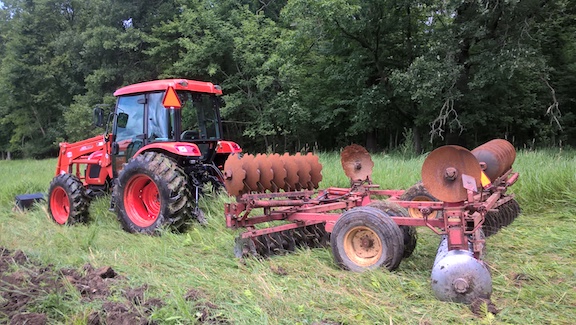

I haven't pulled a chisel plow or any other type of plow. I can say that I used my RX7320 to pull a 12' transport disk through heavy clay soil with lots and lots of sod. Didn't want to spray so we just ran the discs over and over it for a few weeks. You could stall the tractor if you dropped the discs all the way down in some really wet stuff but I think overall the tractor did a great job.
I don't see why this machine couldn't pull 3-14" plow. I'd love to have a set of those.
