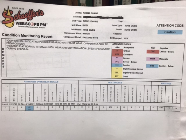

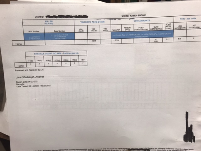

OK here is the sample on the Kioti 4HT4 DAE Dong engine in out RX6620 at 56 hrs.
"Copper high indicating possible bearing or thrust wear. Copper may also be from cooler. Resample at normal interval. High wear and contamination levels are common during break in."
