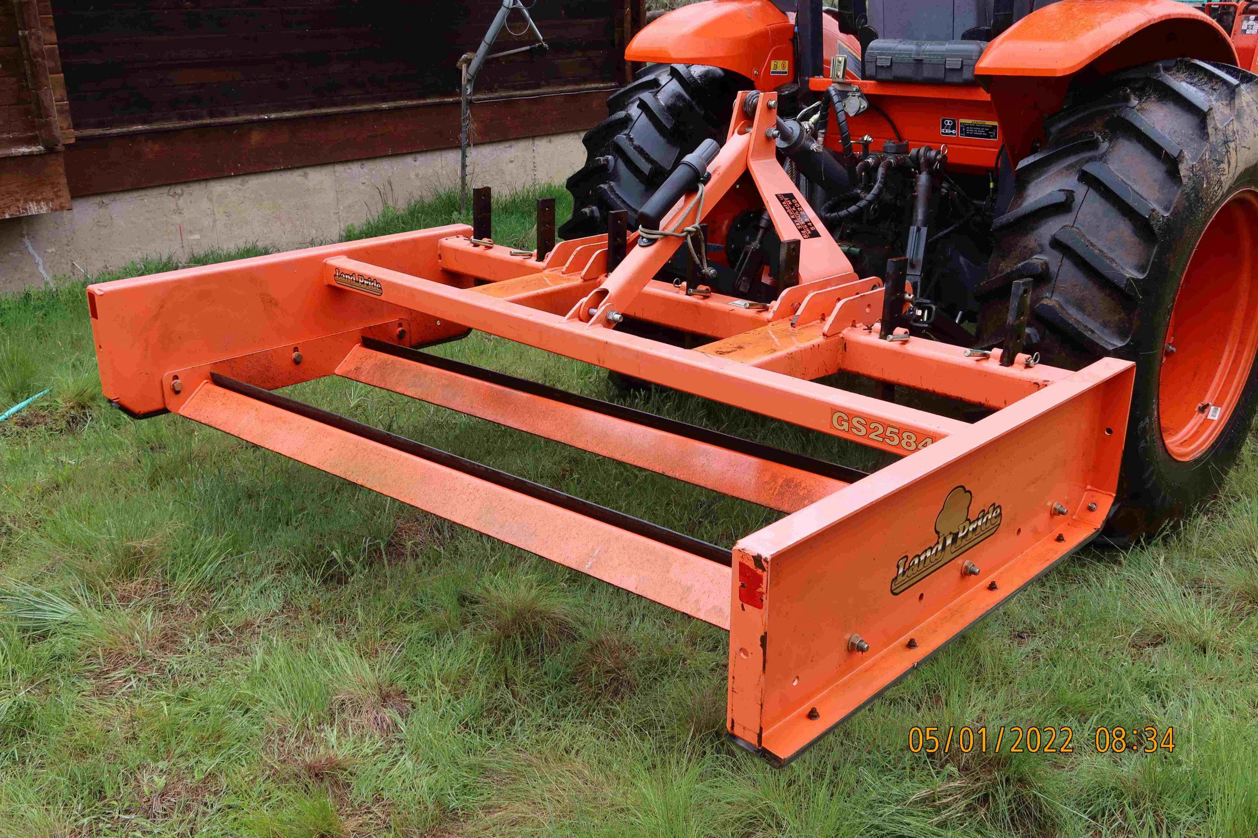

I do all the surface work on my mile long, gravel driveway with my land plane grading scraper. I've tried with my uber heavy rear blade - no joy. If the ruts, washes, riffles, etc get real deep - drop the scarifiers and the situation is rapidly fixed.
