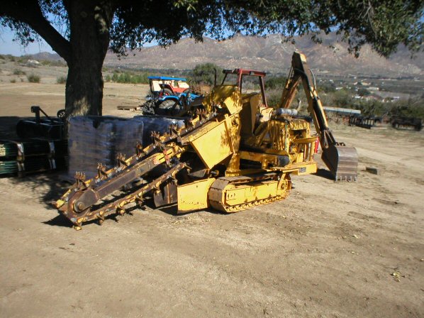

/ Rusty cylinder rod #11
We have an old trencher that we did the same to the boom lift cylinder. That was 8 years ago, still working. :D
