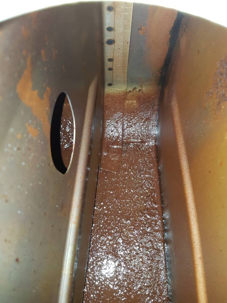

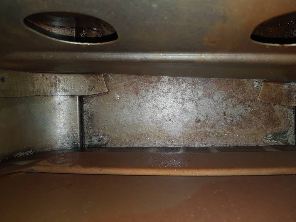

Thanks for all tips and advice. I had a try cleaning It, but not really successful.
The photo shows how it looked. I threw 3 hands of gravel / small stones in the tank, then tied it to my concrete mixer, and had it spinning for 1.5 hours. The result is not what I expected. This problem is bound to come back.
The good thing is that you will find an ursus in every second house in the many villages here in Poland. So it should not be a problem to find a replacement for less than 50 dollar/Euro.
It was a fun project though...
