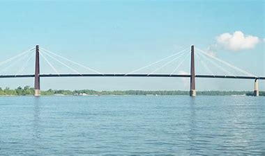

A bridge not far from home is made with rust protective steel.
The Hale Boggs's design features an unpainted weathering steel towers and superstructure, an orthotropic steel box girder superstructure, and two planes of cables in a fan pattern. Weathering steel exhibits uniform oxidation or "rusting" that results in a uniform protective patina and reduces maintenance requirements. The bridge's weathered bronze color is intended to blend with the muddy waters of the Mississippi River. "Wiki"
