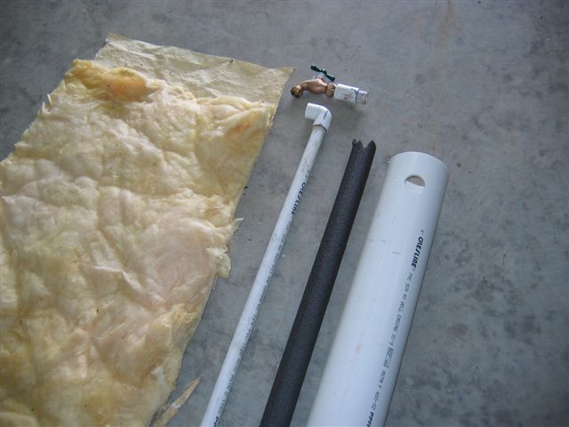

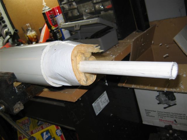

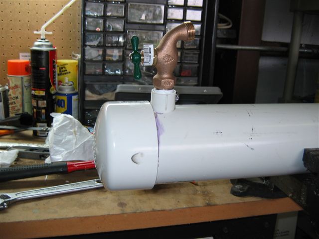

Based on Eddie's design, I made 3 Frost-free (hopefully) hydrants. Used 3/4 PVC and standard bibs, inside 4" schedule 40 well casing.
On all three I used that black foam insulation around the 3/4 pipe. On the first one I try to fill the void with spray in foam insulation. However, I'm not sure I was able to fill up the whole thing because it would back up on me. Hopefully I got enough on that one.
On the other two, I put first the foam insulation and then I wrapped the pipe with some 3.5 inch vinyl back wall insulation I had from my building construction. I taped it in place only on the top and let it fill up the void loosely.
Something I did really stupid. On the first two I cemented the 3/4 slip to thread union in place before screwing the bib in there. Of course both of them want the faucet pointed to the side or straight up no mater how you start threading it.
My wife mentioned that perhaps I should screw it in there as tight as it will go, then cement it into place. Duh....
The only thing I worry about is the weight of the thing sitting on top of that little skinny 3/4 PVC. Of course once I cement it into the water line and get dirt around it, it should be fine. The total length of the outside casing is 40", so I figure maybe 18 inches will be above ground.

The insulation is not fun. And, it was about 90 in the shop with about 80% humidity.

The pieces layed out.

The spickets look great!!! No way you'll have any freezing issues with that setup.
