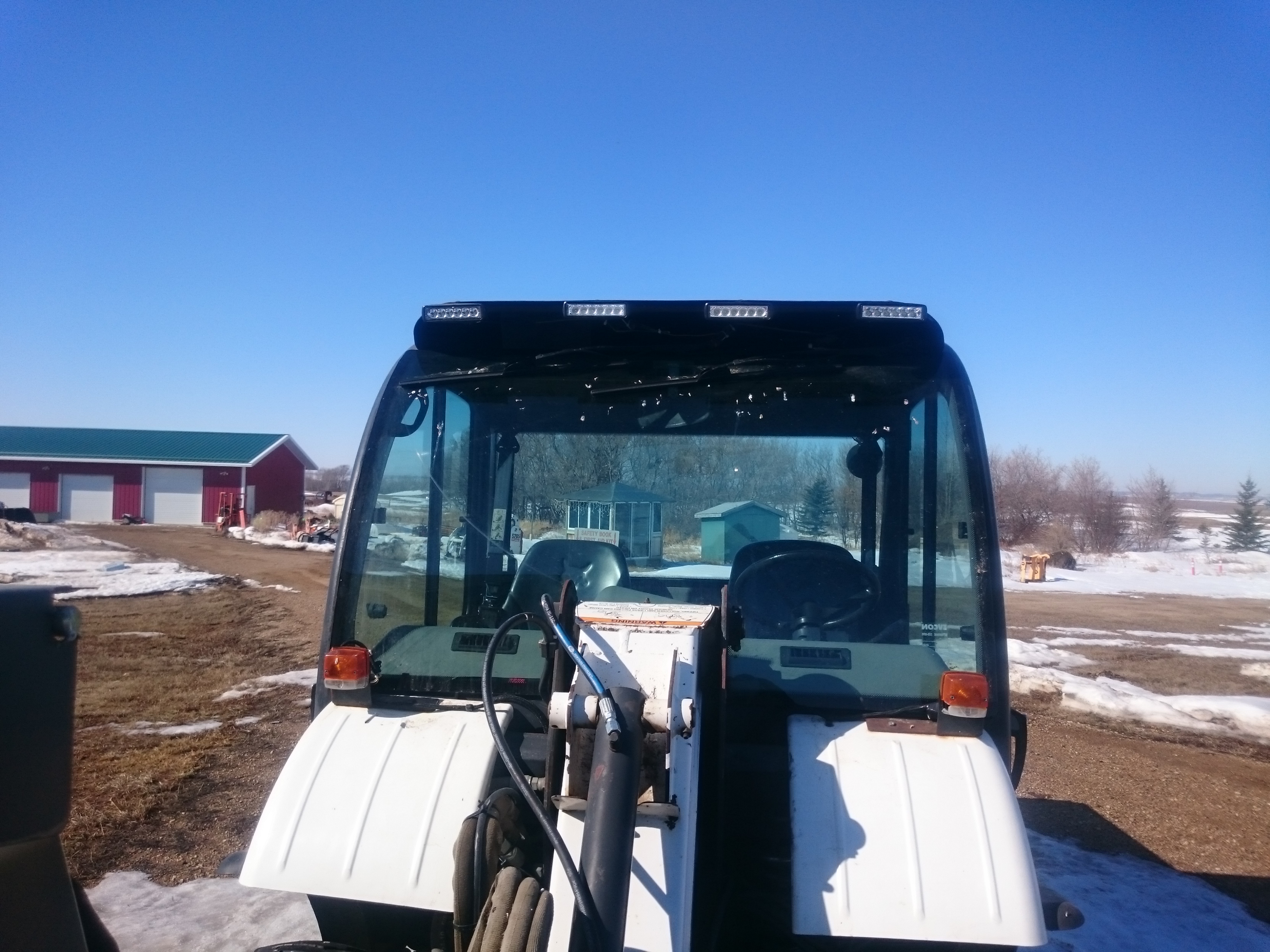

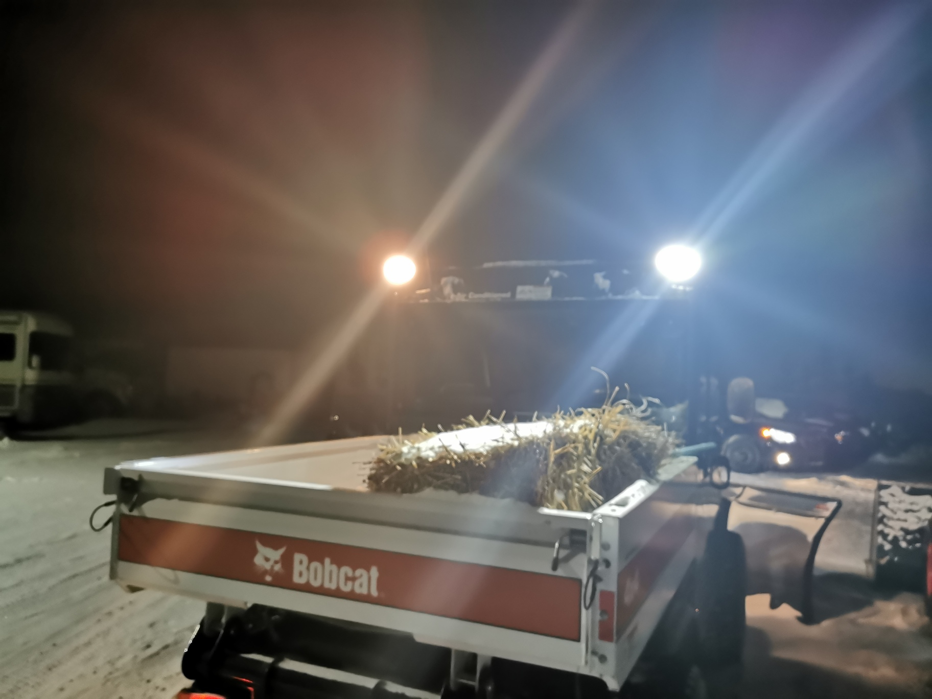

here is a picture of the lights installed, they are easily 3X more light than the factory ones, I looked for the connector same as the factory bulb with no luck, for these lights I wired them together, bared a half inch of the wire, tinned them with the solder iron and simply pushed them into the connector that the original bulb attached, keep in mind the LED lights are polarity sensitive and only work connected one way,
for the cost of these lights I purchased a couple for the mower and tractor, they use less power than a single bulb on the Toolcat, this summer I will purchase another 3 and fit them between the 4 pictured, I also mounted 2 on the rear

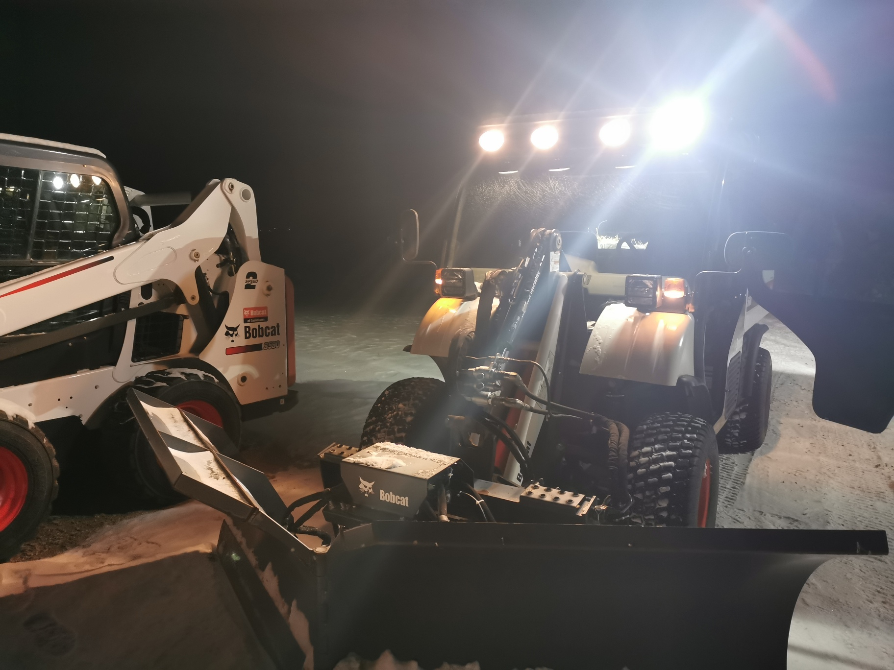

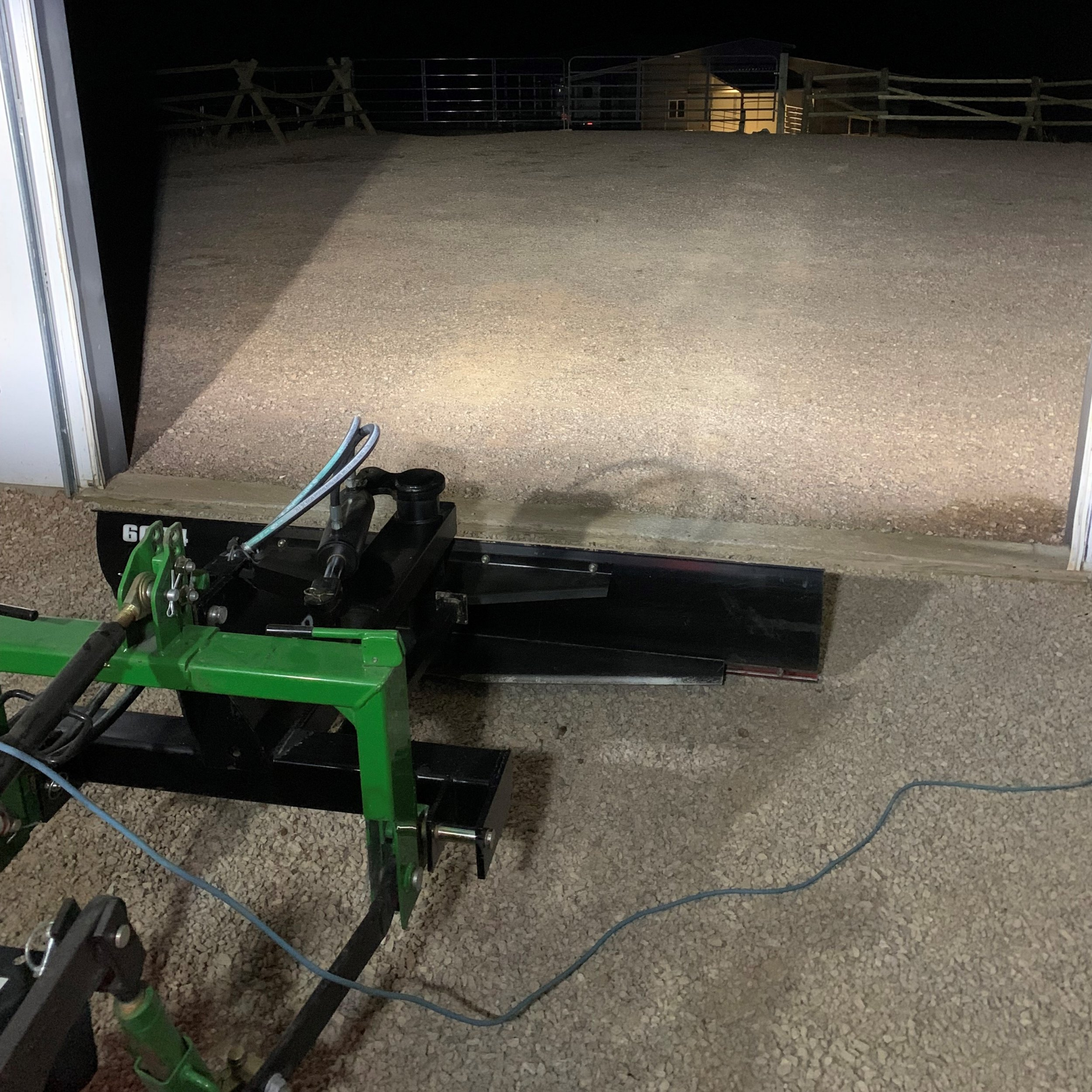

after the install of 4 led lights on the series A toolcat wanted to go LED on the new one but keep the original lamps, got a couple on Amazon, they were easy fit but not much different than the halogen, after some looking local found a couple 880/881 bulbs said to be 5000 lumins, they fit direct into the rear but as the connector is a 90 degree offset same as the rear halogen the connector has to turn up, by rotating the housing down you can get the bulb in then rotate the lamp back in place, here is a picture of the install, only one replaced front and rear in the picture
given the bulbs 5000 lumins with 4 thats 20,000 lumins, a light bar we were considering was 10,000 and it keeps it original

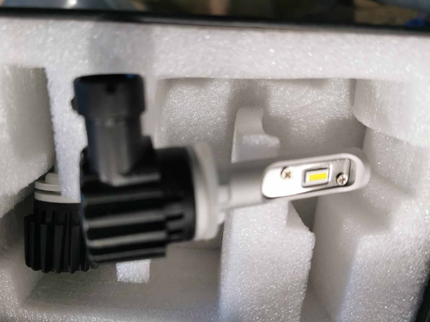

I will be picking up 4 more today to install now I know they will work, I will take some pictures of the bulb and part numbers at that time, the light off the one front one is brighter than the headlamps, quite a improvement
/ Running LEDS for Toolcat #18
Yes please! Pics and info on front and rear bulbs?
/ Running LEDS for Toolcat #19

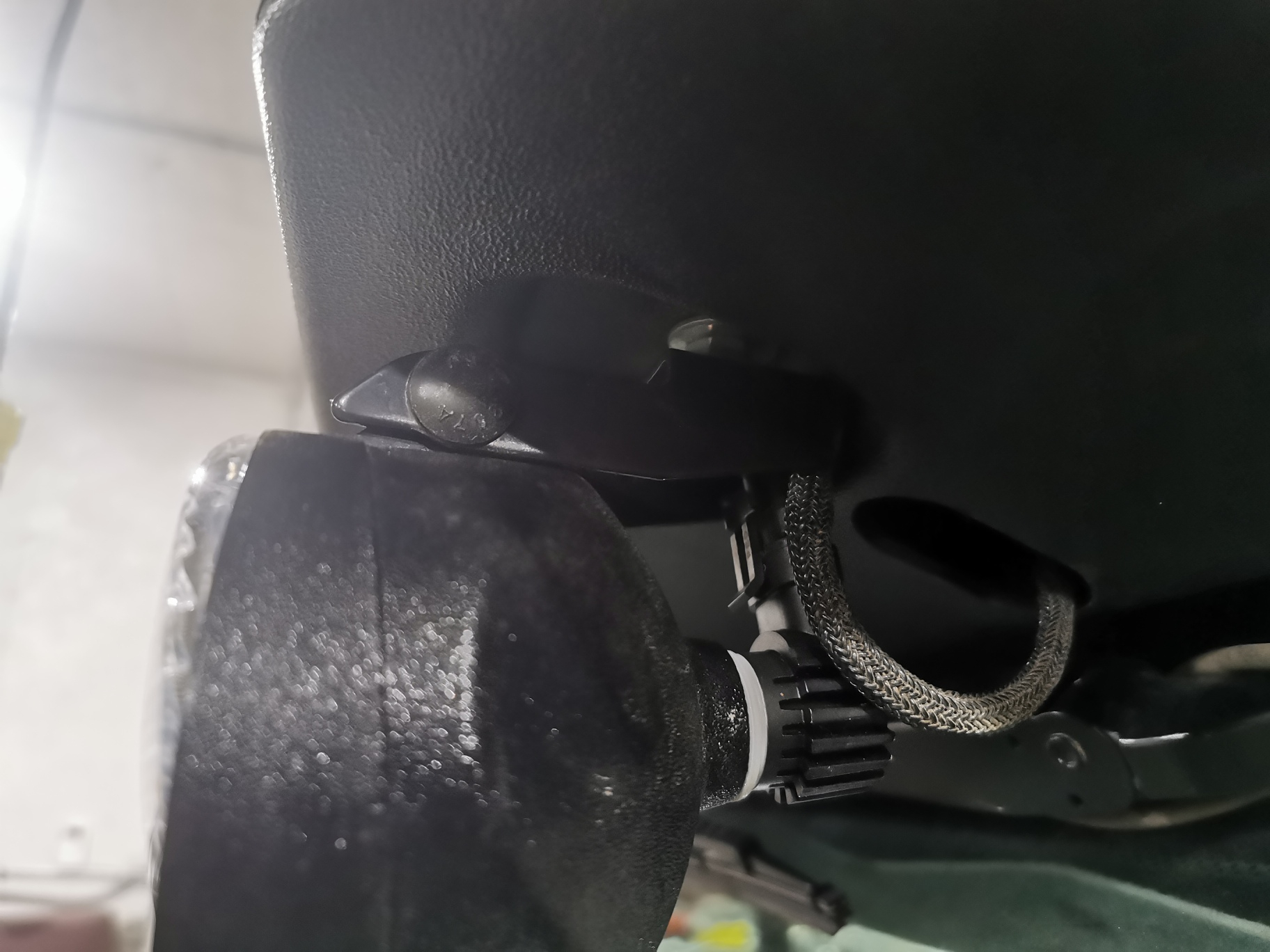

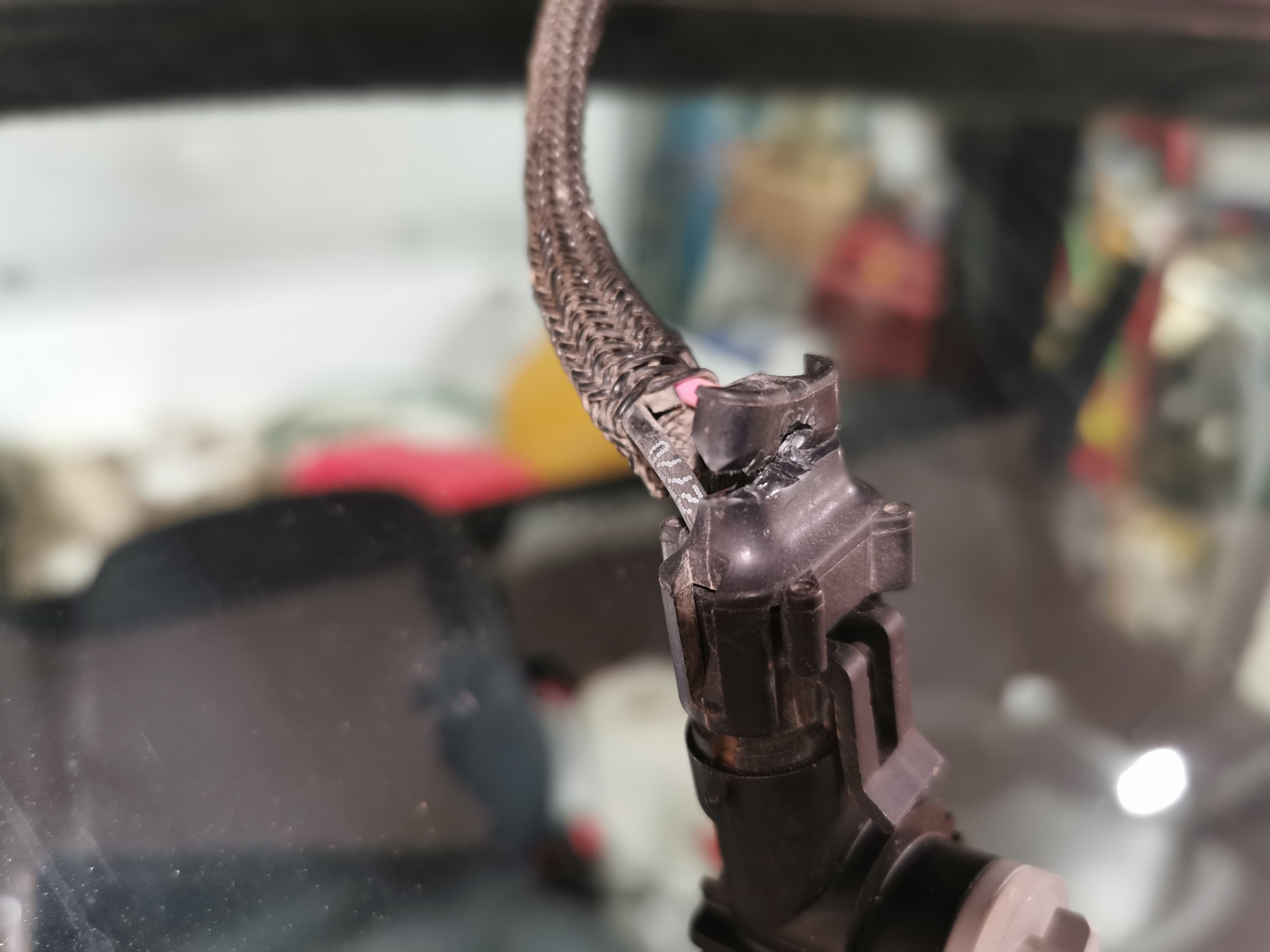

this is where I ended up, the bulbs have to rotate up to function, if you rotate them down and they will as no physical stop exists on this bulb unlike the halogen the issue is it will get hit by the wipers when operating so the bulb has to be vertical
with the bulb in the vertical position the wires hit the plastic deflector the lamp assembly is mounted to so the easiest fix is space the bracket down, this was done by using a longer bolt, nut and a couple washers, the unit was then mounted and had enough vertical rotation to aim the lights
next issue the second from the left will still get hit by the wiper, the other 3 clear so I removed them, went back to the original mounting bolt and shortened the connector where the wires are entering, there is a good 1/4 inch you can remove and no effect on the connector, this gives the clearance to aim the light

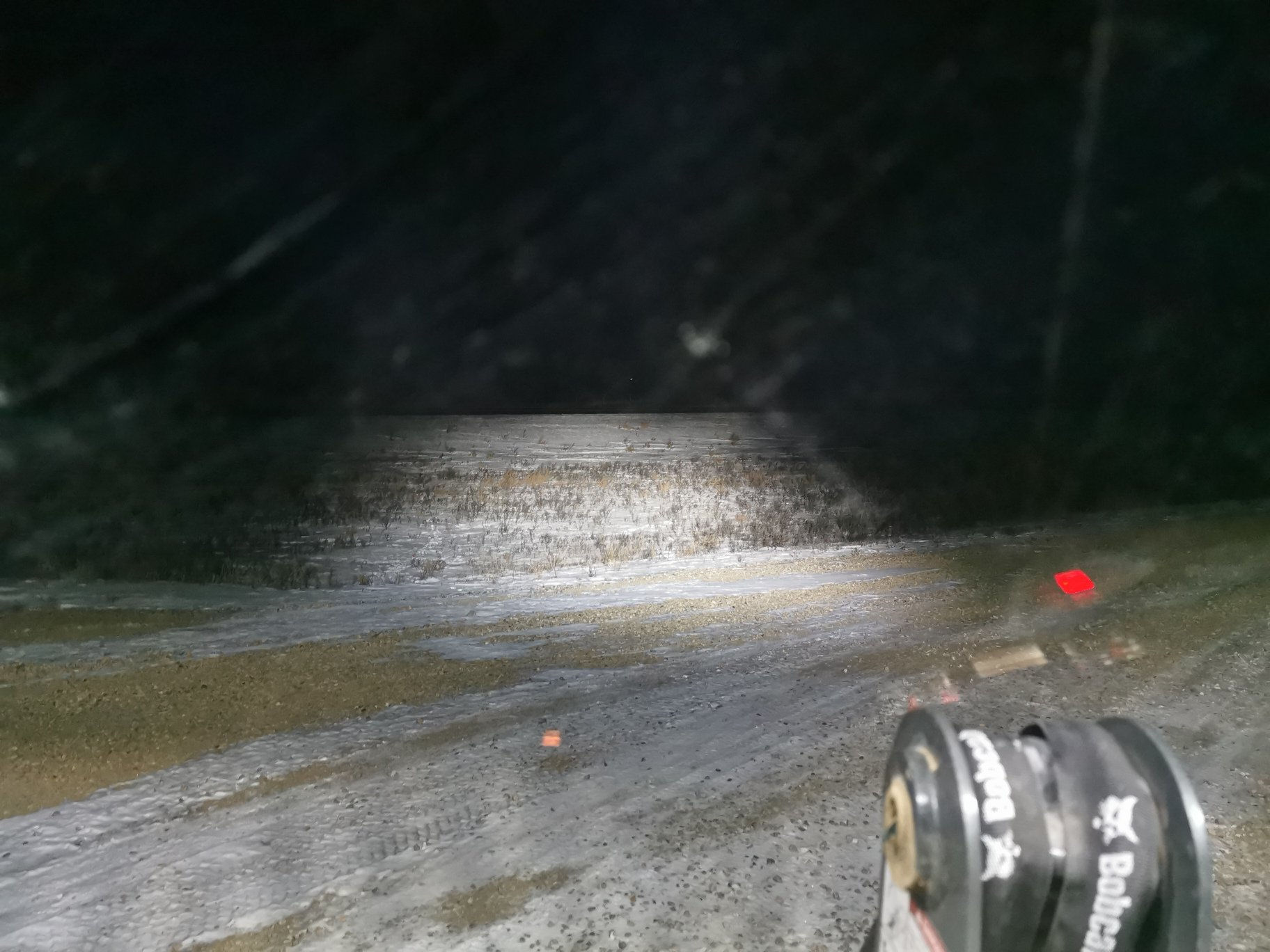

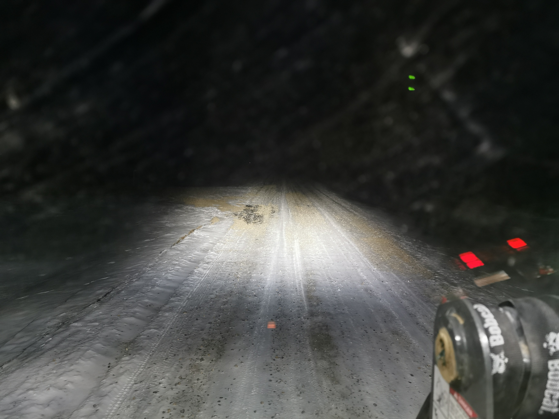

tried them last night and its night and day performance, it makes the headlamps appear yellow, other than driving on the roads the headlights are useless in comparisonIMG_20211212_131144_resized_20211213_084855361.jpgIMG_20211212_131420_resized_20211213_084855034.jpgIMG_20211213_071730_resized_20211213_084855222.jpgIMG_20211213_071811_resized_20211213_084854814.jpgIMG_20211213_071824_resized_20211213_085900328.jpg
/ Running LEDS for Toolcat #20

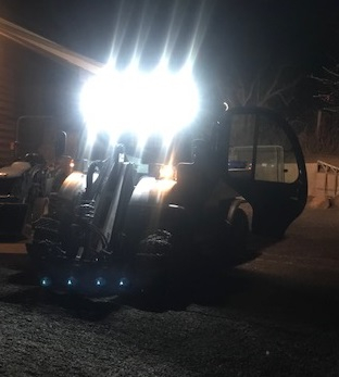

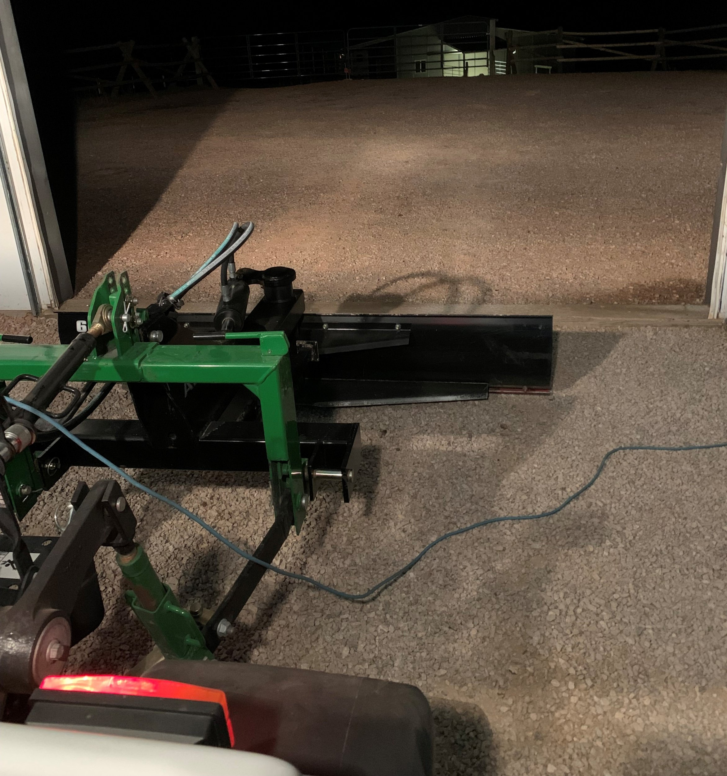

this is the lights last night, its a vast improvement, also a shot of the connector showing amount to remove, its about 1/4 inch, without it the lights can not be rotated down to get a good beam, after actually trying them I think I may rotate up a little to get more distance
