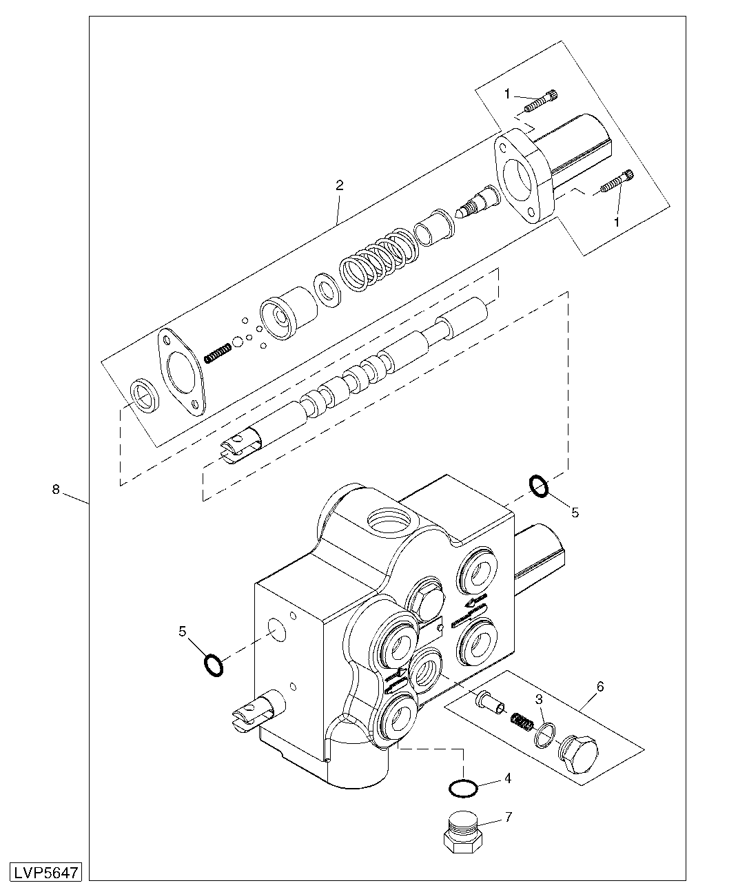

I need to run hydraulic lines from rear to front for a new grapple on a JD 5525. The dealer quoted me $450 for parts and installation. Is this reasonable? I'm not sure of what the parts would cost (?) Thanks, SB

You should also look into adding a true 3rd function to open / close your grapple. We added the WR Long kit to our New Holland TL100A. It's more money but well worth it. You end up with a rocker switch on your FEL joystick that opens and closes the grapple. I think it's is much easier that moving your hand from FEL control to the handle for your remote. The WR Long Diverter plumbs into the power beyond port on your loader valve. Plus you don't lose the use of your rear remote.

I did that on our JD 6200. Nice arrangement. Hard Lines down the loader and a rocker switch on the joystick. I forget what it cost, but it was more then the four hundred something dollars I seem to recall. There is another spool to add to the block (not cheap), oh and I installed it myself. Probably did a much nicer job running the hoses. There are special valves up front at the couplers to bleed away pressure as you can't operate the valves when the machine is not running.
I would always opt for another totally new hydraulic circuit over a diverter. You can never have enough circuits IMO.

JJ i disagree about it being too much. Flat face couplers are about 40 something a piece. Plus you have to get 25 feet of hose and the quick couplers for the scv. I put it all together myself and had $375 and that was all made locally. A third function would be my best option but the kit from jd doesn't just add a spool it completely replaces the valve block and some hard lines and its clsoer to 2K to have a true third function.

Does JD mid mount loader valve not include a power beyond port?
