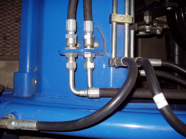

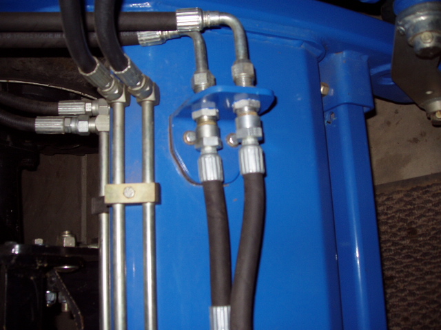

Not meaning to jump La Voie, here is a photo on my tractor of what I think you are asking about.
A bulkhead mount is made up of two pieces:
The first being the bulkhead (wall). In my application the (3) are cut from 4"X4"X1/4" steel 90 degree angle plate.
The second being a hydraulic bulkhead fitting (compatible with your choice of QCs and hose diameters) that is placed in a bored hole in the angle iron bulkhead plate and screwed down with a provided hex nut.
The three bulkhead mounts that I have are at:
One at the FEL disconnect-straight through (not shown).
One at the FEL arm 90 degree turn.
One on the FEL crossbar 90 degree turn to the grapple.

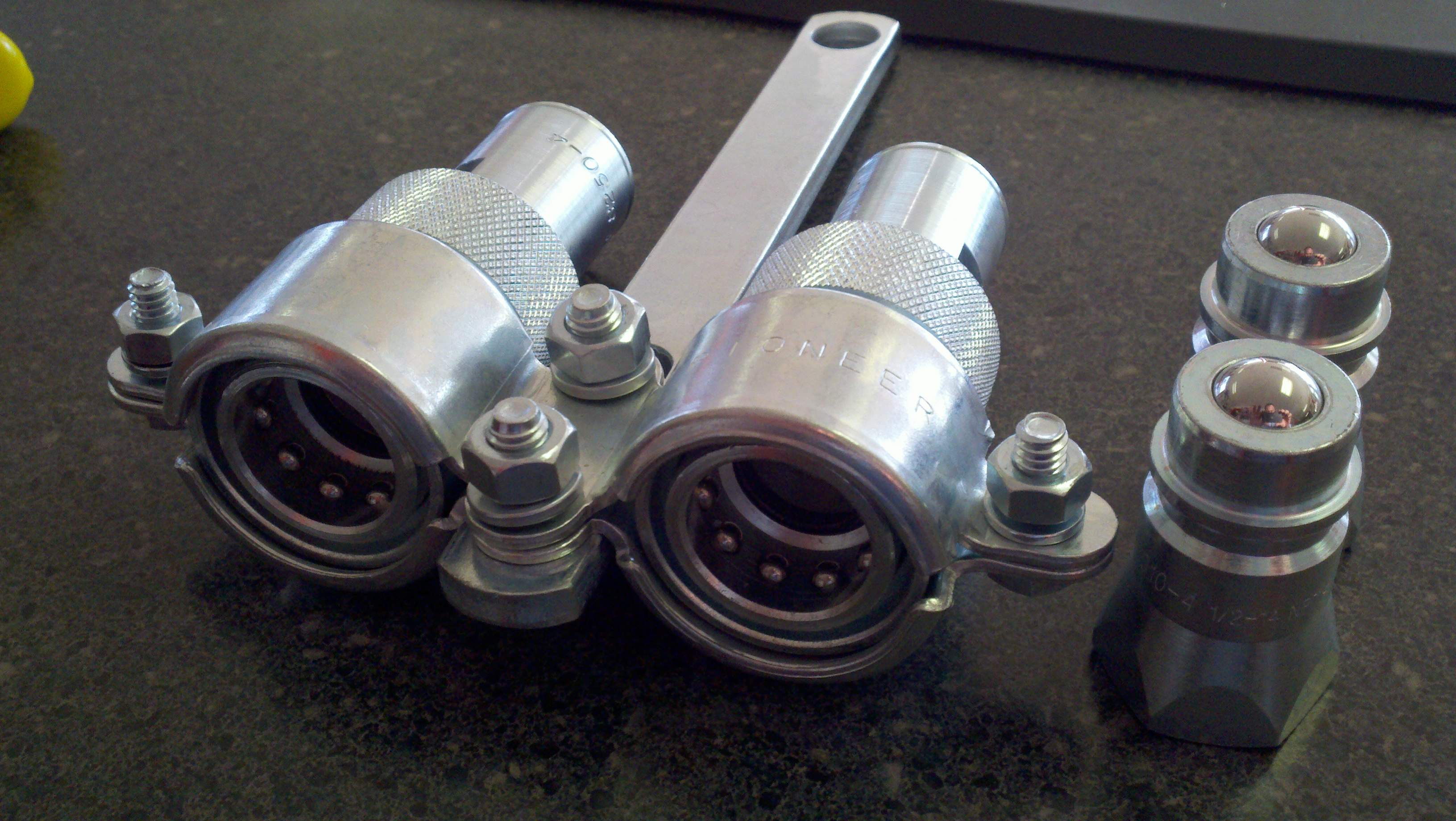

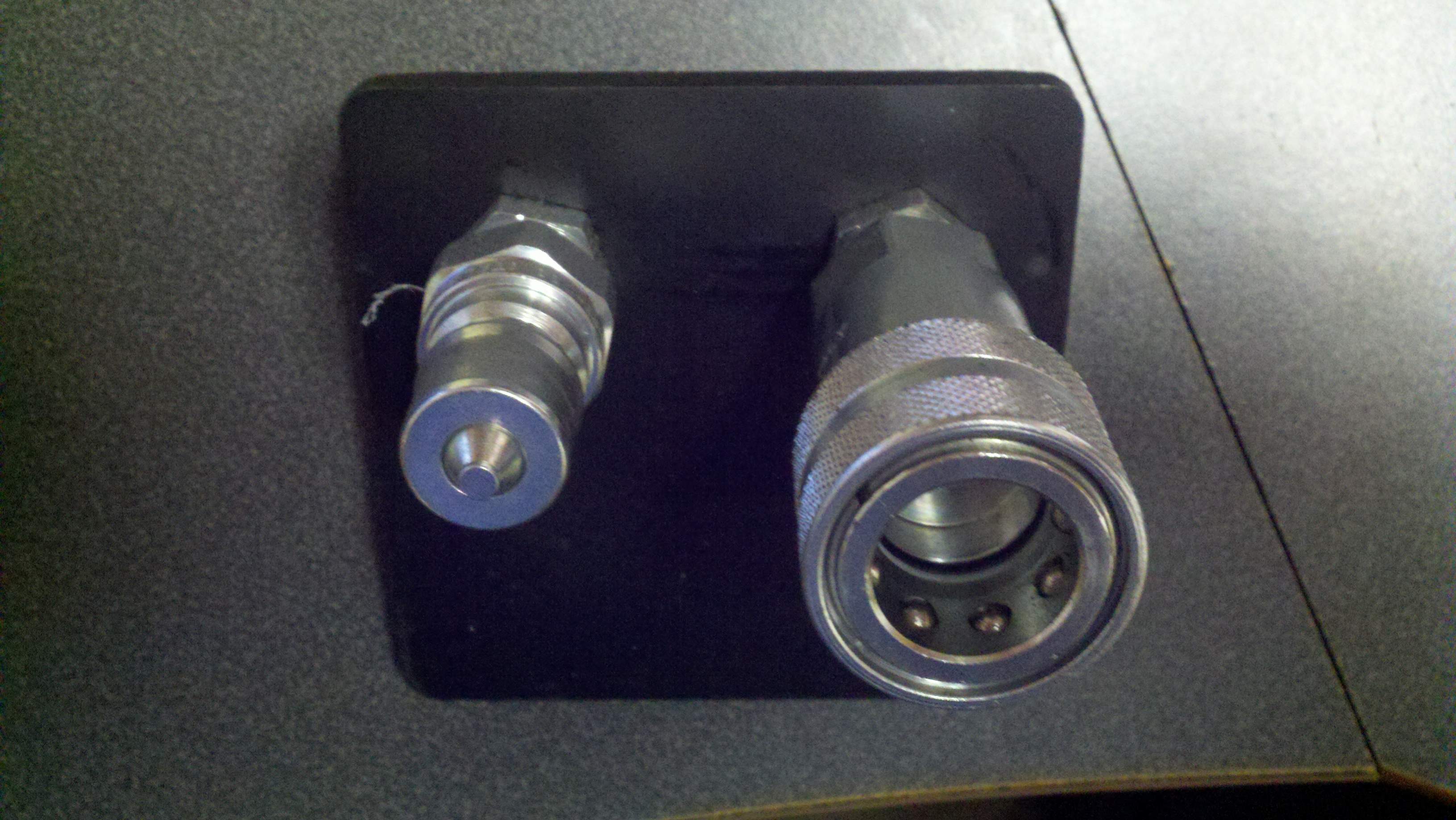

Quick Disconnect - I sell three different ones.
W R Long Bulkhead Mount -
- contains weld on plate, one male & one female QD, 2 bulkhead unions
- any hydraulic shop can get you all fittings, you maybe able to make cheper yourself. i sell as courtesy to go along with W R Long Valve
- Hard to get hooked up if pressure on attachment hoses!
-GOOD
TISCO 8500 Break-Away Kit -
-contains two male and female fittings and mount bracket, thread size 1/2 NPTE, easy one handed connect and disconnect when clamp mounted, **must release valve pressure
-BETTER
TISCO 9500 Break-Away Kit -
- PRESSURE RELEASE INCLUDED - No awkard hooking up because of pressure on either piece. Also Higher flow for Hydraulic Auger drive on front loader (like skid steer!)
-BEST
I am going to try to attach pictures. Email or call if you want more info. EVERYTHING IN STOCK!
Tony

/ Running hydraulic lines for grapple #8
Picture 1 - W R LONG
Picture 2 - TISCO 9500
Picture 3 - TISCO 8500
