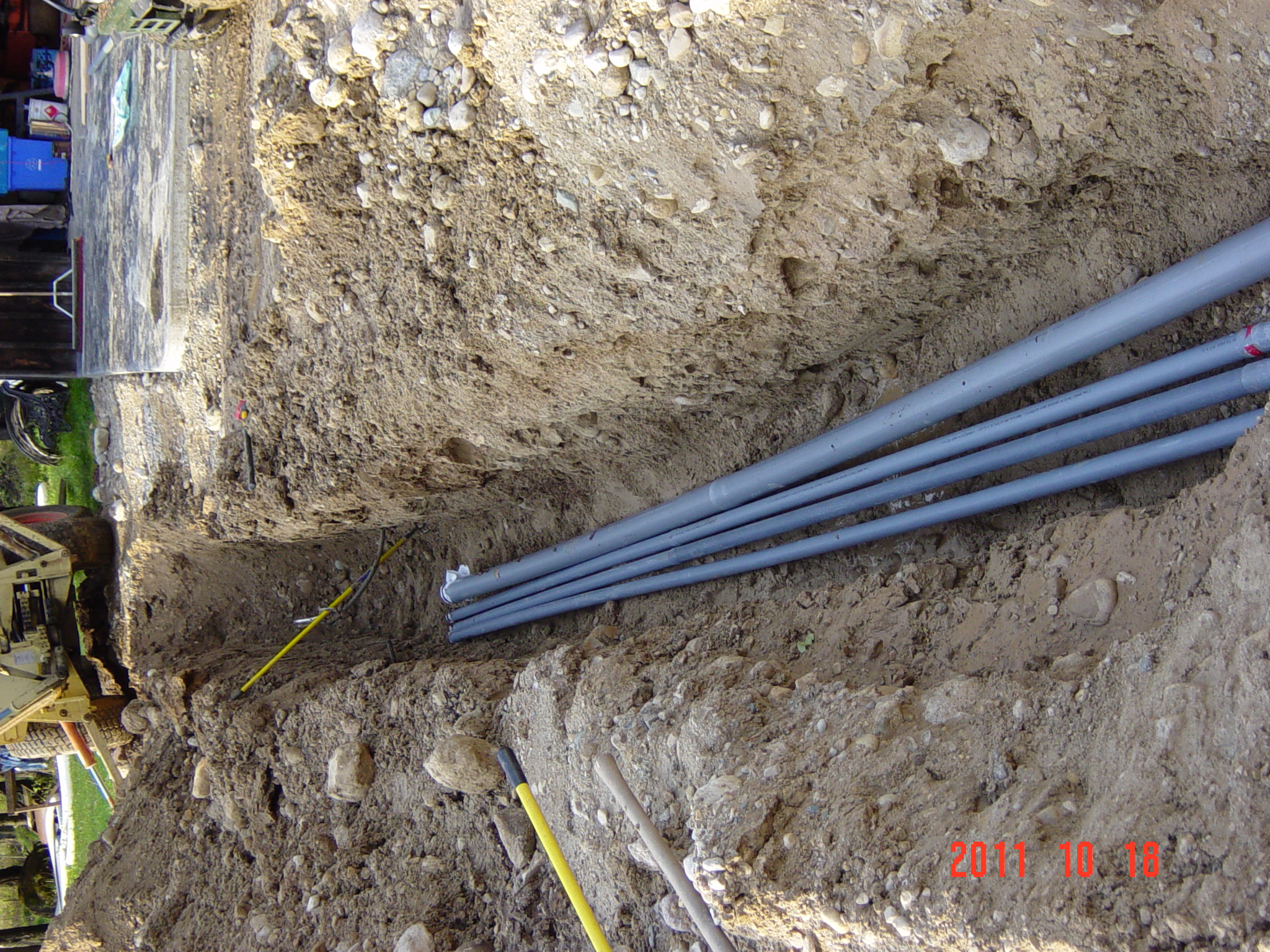

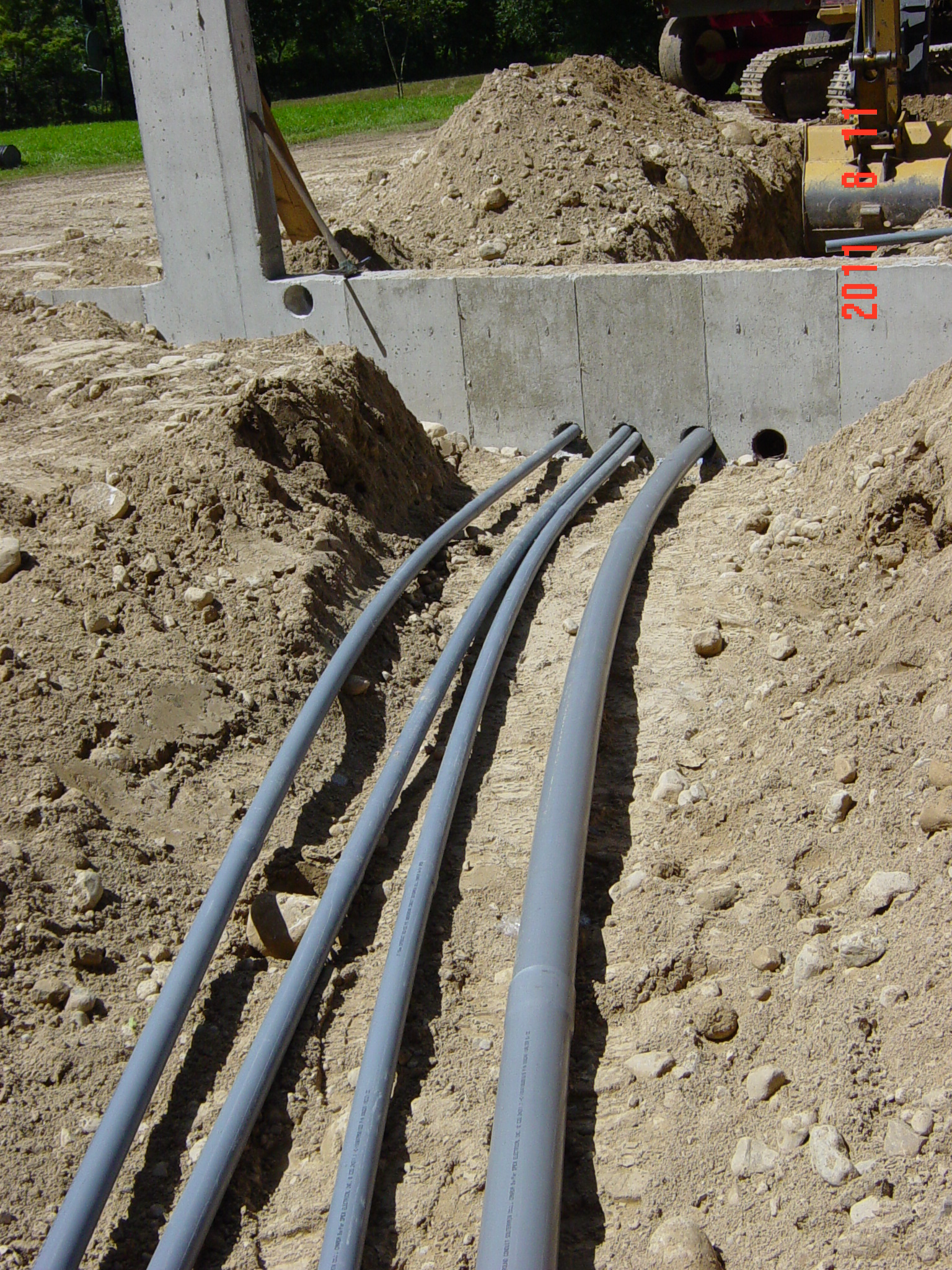

Absolutely!
Lines to my Drive shed.
3" Superduct: Communications, Low Voltage, 110/220V, 600V 3 Phase
6", for pulled in 200 PSI 1" Air Line.
