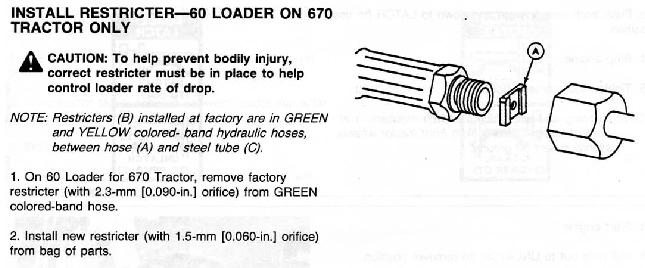

If you are trying to slow a hyd motor, find a washer restrictor or a fitting with a small orifice and insert it into one of the motor fittings.

The washers are cheaper and you only need one.
The fluid has to pass through the orifice coming and going.
Select the orifice for the speed.
Can also use a needle valve to adjust flow.
Style is irrelevant, function isn't. I disagree on the quantity required for the reason I stated. Your mileage may vary, but I'm not going to risk an orbit motor for the price of a one way restrictor. You can choose to do so.
