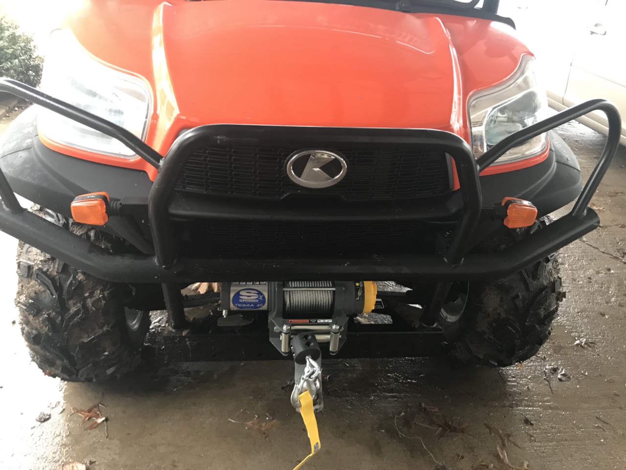

I recently purchased a new 1120D and wanted to install a Superwinch Terra45 like I had on my RTV500 I had traded in. The 1120 has winch Mount bolts already predrilled but the it was unclear by fit charts what would work. The factory winch kit from Kubota is a Superwinch rated at 4000 lbs. Just so everyone knows the Terra 45 mounts fine using the predrilled holes with no adapter plate needed

Those are good winches for the price. Makes me feel better that those are the OEM aftermarket ones selected by Kubota

I looked at a bunch of winches for my RTV-X1120D back in 2015 and they all would have fit. I think there are standard hole patterns and all the winches seem to use them and Kubota also setup their mount that way. I ended up with a Warn because I got a good deal on it, but there are a lot of good options.

Yes, as I understand there is a narrow pattern and a wide bolt pattern. The Terra 45 has the large pattern and bolted up perfectly. I think for a machine that weighs as much as the 1120, the 4500lb winch is about right
