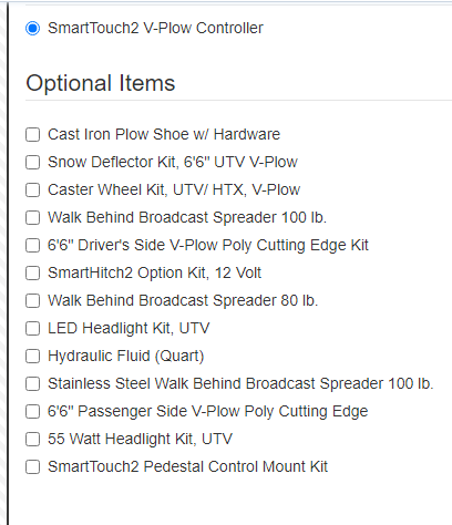

Hey guys I'm going to seal the deal on my X1000C order tomorrow with the BOSS RTV V-Plow, what options would you recommend for the V-Plow? Here's a list I found on the BOSS website, wasn't sure if the SMARTHITCH option is really necessary? thanks.

Hey guys I'm going to seal the deal on my X1000C order tomorrow with the BOSS RTV V-Plow, what options would you recommend for the V-Plow? Here's a list I found on the BOSS website, wasn't sure if the SMARTHITCH option is really necessary? thanks. View attachment 691109
Little late with a reply.
I have the 78" Kubota V Plow - I ordered spare steel cutting edges but they were the same part # for each side - curious why there're listed as passenger and driver side on your list - maybe they are the same part #. Also curious on how fast a poly cutting edge will last - seems to me it will wear a lot faster than steel. I'm not sure how long my original steel cutting edges will last but I wanted a spare set just in case when they do need replacement that I won't be faced with Kubota no longer having them available.
   / RTV - X1100C #137
The casters are fantastic for being able to roll the plow anywhere you need it in storage off season.
The poly edge is great but not poly... it is a hard rubber about 3/4” thick but works great to prevent damage to asphalt surfaces.
Everything else is not needed
