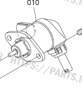

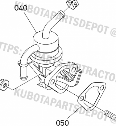

Thanks so much what exactly tests the solenoid? Is there a fuel solenoid? This is the fuel pump diagram and the stop solenoid.

The pump is called a lift pump and it is a low pressure pump that gets the fuel from the tank to the high pressure injection pump. The fuel tank is low so depending on gravity would not work...hence the need for the lift pump. Test it by loosening the fitting where the fuel comes from the lift pump and goes into the injection pump. Crank it over and you should get fuel.
The solenoid is bolted to the injection pump and depending if it is activated, allows fuel to be sent to the injectors. Some of them stop working and some get weak and won't hold.

The fuel stop solenoid was the problem. I replaced it and started instantly. Thank you very much RUFFDOG I didn't know what to do without your help. Thank you again! Took two weeks for the part to arrive at my local Kubota.
