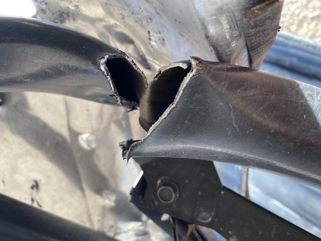

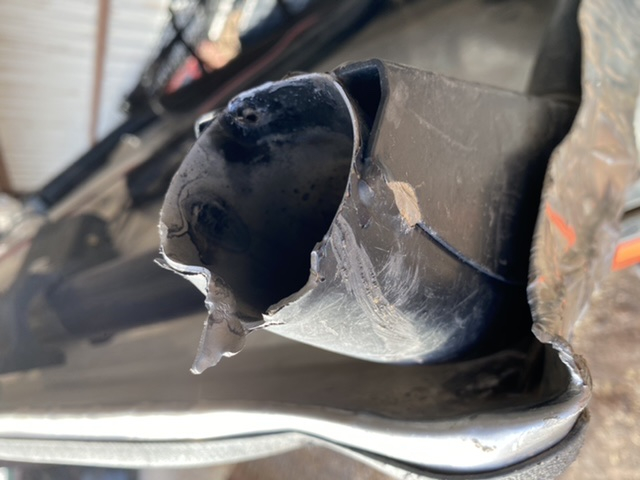

From where the RTV started sliding to where it stopped was approximately 200' horizontally and a drop of 90' -24 degrees or 45% slope.
I was looking at it in more detail and the frame is cracked on both sides. Attached are pictures.
I am in no way trying to bash on the RTVs. I own five and I will be buying another to replace this one. I just always thought of a ROPS as a place to survive a nuclear blast. It surprised me how thin and weak it appears to be.
So offhand, something that freefalls 90’ would be going about 52 mph at the bottom. The roll probably ate some of that raw speed but also some of it went into other motions that could be just as bad. Just ballpark, this damage seems about what I’d expect for that much speed and associated energy. Nobody would expect much from that ROPS if it was the front bumper in a 52mph crash on the highway.
Based on what we saw here and the ROPS standards that were posted, I think the real and valuable lesson here is that these things are not nearly as indestructible as many of us thought, me included.

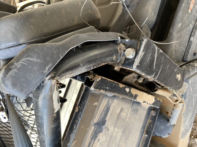

We rolled our 1120 today. Driver was not seriously hurt. He as thrown from vehicle which probably was best. The ROPS didn't fare too well. A buckled in passenger would be in bad shape.
Wow glad no one was hurt , I have a Polaris Ranger and now it has me wondering ! They do make a ROPS that bolts inside the bed so now wondering if it would be worth it or if it would just twist on the bed if rolled over . Can I ask if this was at a high speed ? Mine will only do 50 max on the open road and I usually always put the belt on if I plan on going more than 25 MPH .

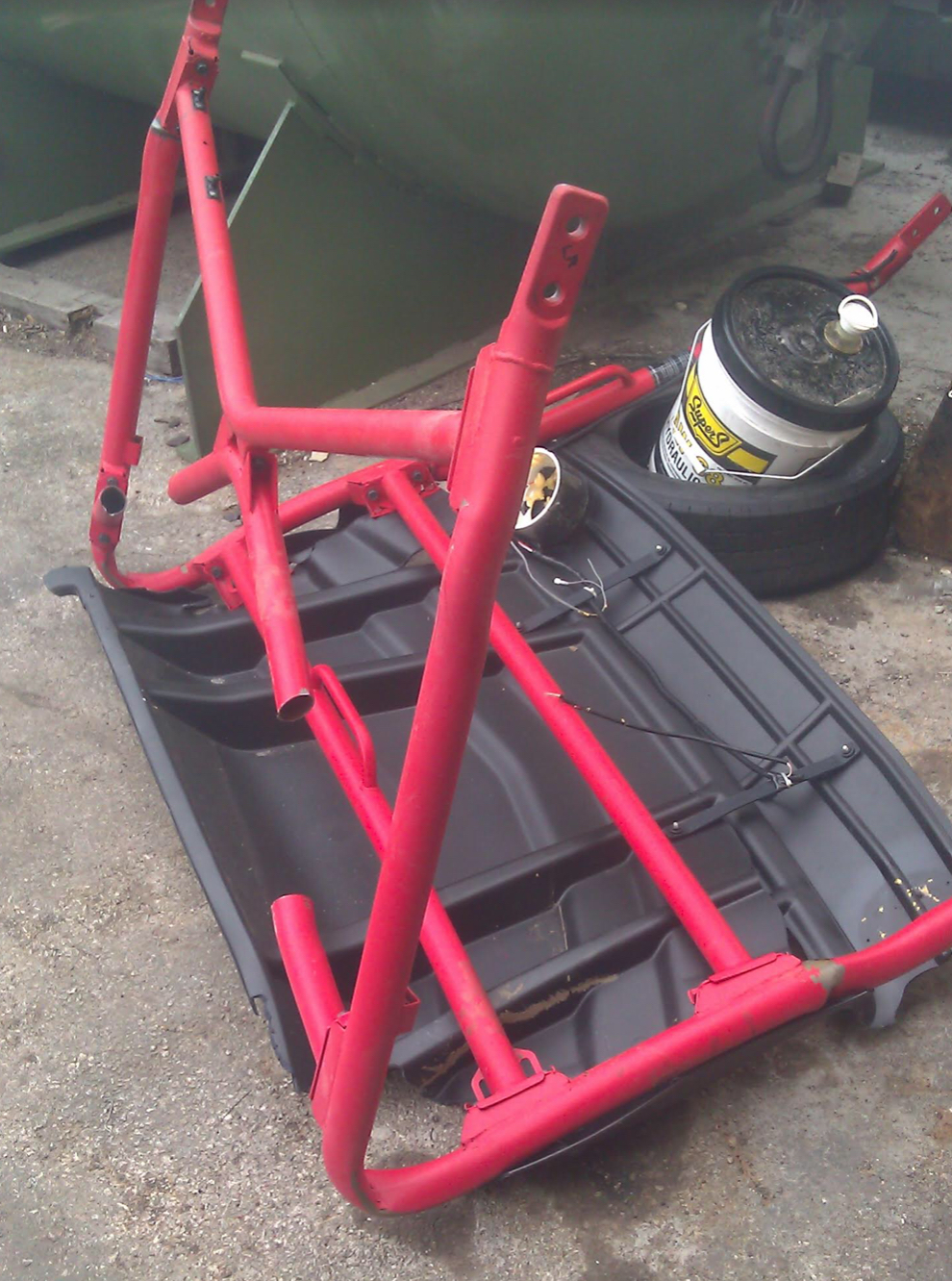

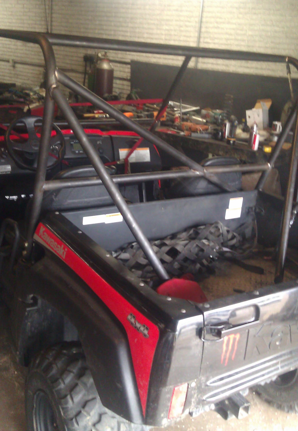

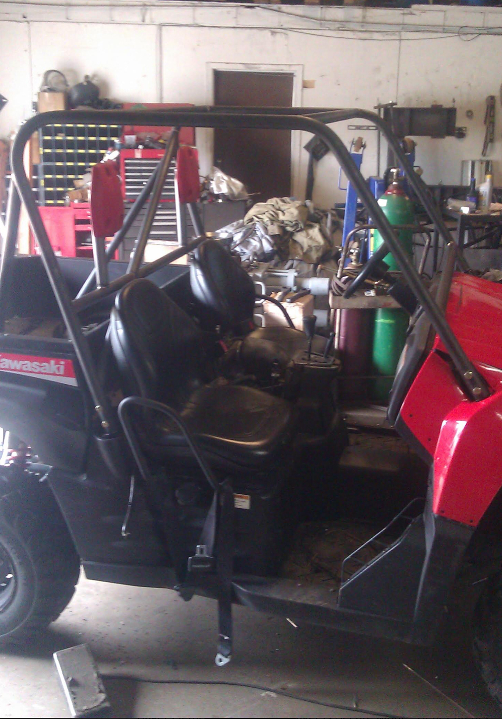

Found the photos of the little mule cage that folded up and scalped the woman. Funny it’s been more than a decade now and I never knew the story “from the horses mouth” but from this photo, I bet she got hurt from the speaker (?) missing from the roof, on the drivers side. I bet that’s what got her head.
The head rests have been cut out at this point but that is The rear section on the left, you can see where it folded up at the bend.
I followed the original structure as much as possible but non foldable. It’s all 4130 CM and takes up a lot of bed space but you can either avoid trouble or be better prepared for it.
