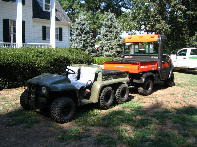

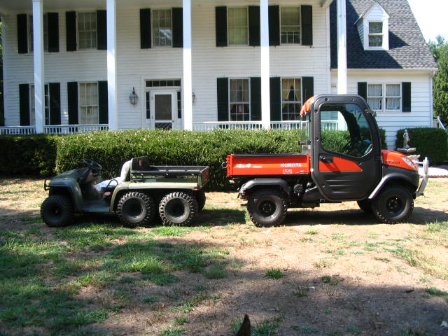

IMG_0841.JPGRTV 1100 & Trail Gator. Big Difference...
