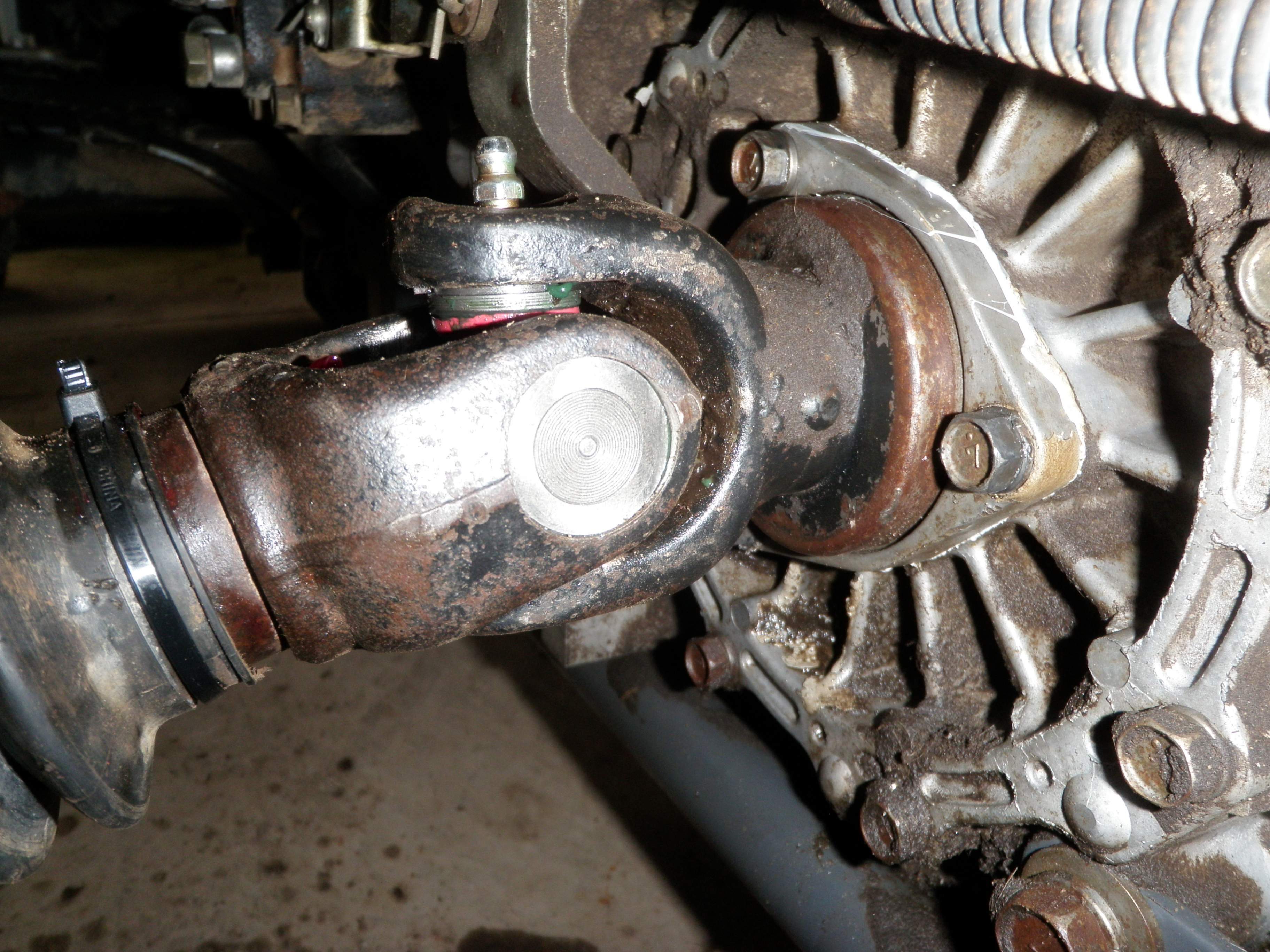

I found a alternative to buying the K7571-91320 / K7561-01220 Rear shaft U joints from Kubota for $60 each. Took machine apart to replace leaking shaft seal and discovered that the U joint were bad. Didnt figure that local dealer had them in stock anyway so I started looking around online and found that a lot of people are using the 397 precisions but grinding down the sides of there yokes but that didnt sound like a very good idea to me so I tracked down one that fits without modification. A 1-1557DL from Autozone(about $9) will fit and the 98-703 Transtar or a 5-1503X Spicer(about $25). All you need to do to get them in there is clean the paint and buildup off of both edges and they went right in for me in the vise. The spicer ones come with the wrong clips so you have to reuse your originals but the ones from autozone come with the right clips not sure on the transtars. They do sit a little bit lower in the joint so the cap is slightly recessed inside of the yoke but that doesnt hurt anything. :)

My RTV900 went down without warning on Friday evening on Labor day weekend, Saturday morning I found this post and went right over to Autozone, got the part (1-1557DL) and it worked Perfect, just as you stated. this saved me about 60 miles of driving and waiting a week for the part.... the $50 saved was just icing on the cake!! If you were in OKC I'd buy you a hamburger!! :)
PS. my RTV900 is a 2005 with 375 hours on it and this is the 2nd u-joint I've replaced, I think I replaced the same one about 4-5 Years (75-100 hours) ago. (passenger side rear, transmission joint)

Ok, so today I had to replace the U Joint again, this is the same one I have already replaced twice.
IN my previous post I stated that my machine had 375 hours, I Must have been smoking a U-Joint that day because today I looked and it has 613 hours and there is no way I have ran over 200 hours in the last 3 months. I would guess maybe 20 -30 hours at most.
Anyway.
For the first u joint (a few years ago) I replaced with a Kubota OEM @ $60 , a few days of waiting on the part to get in and 2 trips.
On the 2nd one (4 months ago) I used the replacement recommended above, (1-1557DL from autozone) @ $7-8? in stock at my local autozone. 1 trip.
I was pulling trees over to be cut up and split for firewood. (They were already cut down) I know I work machines pretty hard, but am surprised this same u joint broke so soon.
I decided to try and find a NAPA replacement (Precision Brand) u joint. They are made in the USA and I have found NAPA products to be much better than the other Three auto parts stores stuff. (O'reilly, Advanced auto, and AutoZone) I may be wrong but sometimes it seems that their "lifetime Replacement parts" are more trouble than they are worth?
Ok So here is what I found... The NAPA PUJ 398 in stock @ $21.99 works perfect, EXCEPT the clips are the wrong ones, this u-joint only comes with the "Outside Clips"
Here are 3 options.
1. Use your old clips, if you can retrieve them.
2. Try asking NAPA if they have any spare clips they can give you. I was able to talk to the store manager, and he was kind enough to give me some Spare Clips he had in the back, the RTV 900 takes the "inside clips" meaning the clips go on the inside of the yolk to keep the caps from slipping off.
3. Cut (Break) the little loops on the ends of the "outside clips" off, you can then use them the same way the "inside clips" work.
In the above picture, the clip on the left is how they come in the package, the clip on the right is one I have cut the loops off of.
I just used a pair of pliers and bent the loop back and forth twice and it broke of, on the 2nd loop I used some dykes and cut it off.
I then clipped the modified clip around one of the caps of the old joint to see how it would fit, it looks to work perfect except it is a little loose compared to the others, but they do clip around the caps and should stay in place to keep the cap from slipping off which is the intended purpose.
Option 2 worked for me and I installed the joint today, I will update this if there is another problem in the future, other wise NO NEWS is GOOD NEWS if I don't update then it is working good.
Vance.

The joint I have replaced (twice) is the passenger rear, by the transmission, it is not that difficult if you have the correct tools.
I just raise the bed (no need to remove it) jack the back up, both wheels off the ground, makes it easier so you can turn the shaft from the transmission to reposition the joint. remove the wheel on the side you are working on..
Get a ball baring press (if you don't have one) from O'Reilly or AutoZone they both have a free tool rental program where they basically sell you the tool you need, then you return it when you are finished with it. $130 from O'Reilly, $100 from AutoZone, but it doesn't really matter because you are going to get all your money back anyway. (btw, this is a program they offer, I am not cheating them, just ask them about it)
For someone who is good and has experience with u joints, it is probably a 1-1.5 hour job maybe less, I'm not that good so it took me about 2-2.5 hours? but this is from start to finish, including gathering up all my tools, then having to go find my pliers etc...
I don't do ALL my own service, but in my opinion the trouble loading it up, taking it to the dealer, waiting a week for them to do it, then paying them who knows how much to fix it.. If you feel somewhat comfortable doing it your self I would defiantly recommend doing it yourself.
$22 from NAPA (or $9) from AutoZone, and a couple of hours of "TINKER" time.
It's definitely not like replacing the transmission gasket or anything like that.

Also do you know which one needs replaced? If it is the one by the wheel, (not the transmission one) then it is much more difficult to get to because it is inside of a steal encasement, so you have to do more work to get to it.
you stated that it is making a faint ticking, if you can figure out which one is the culprit you will be ahead of the game.
