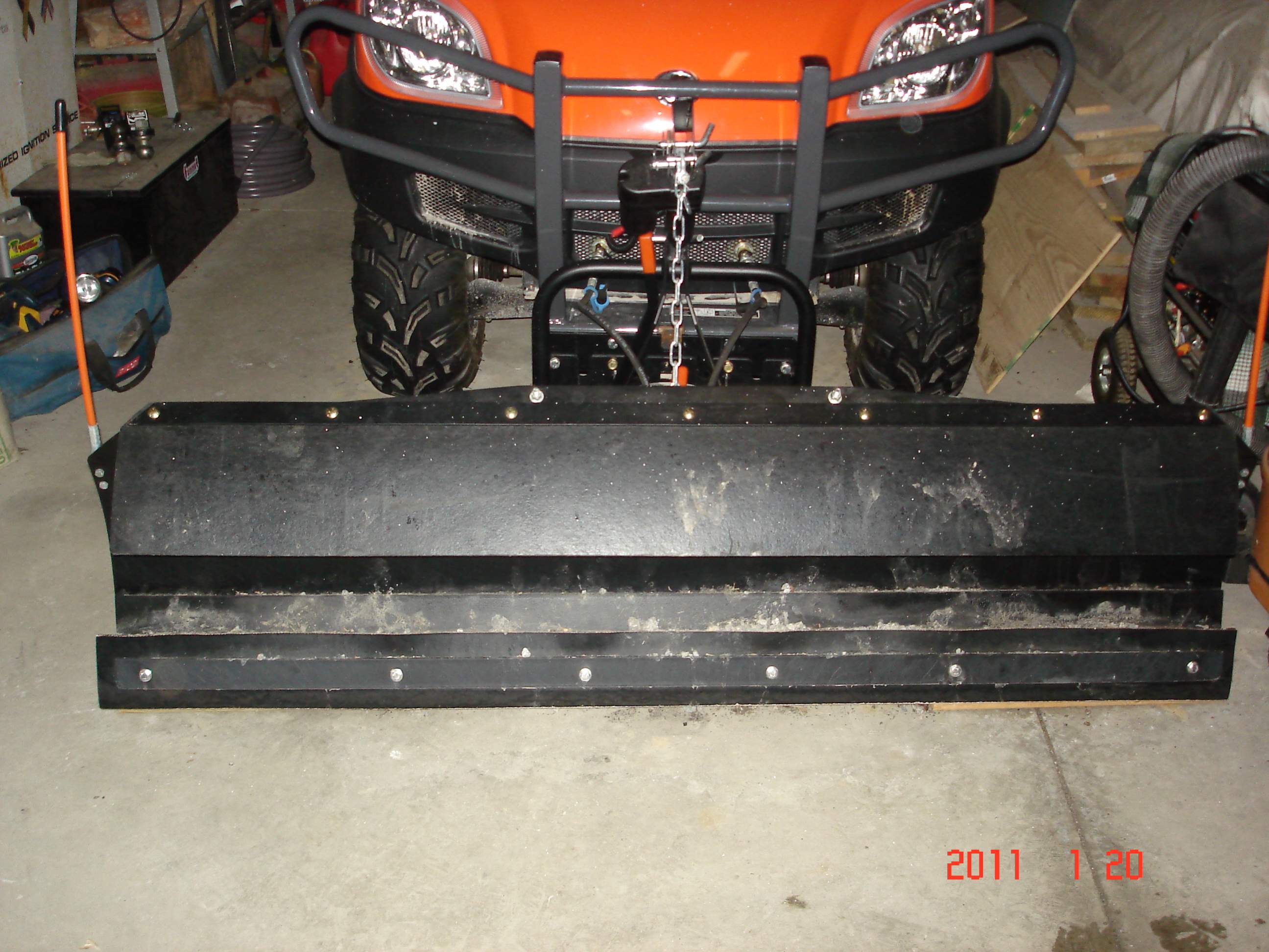

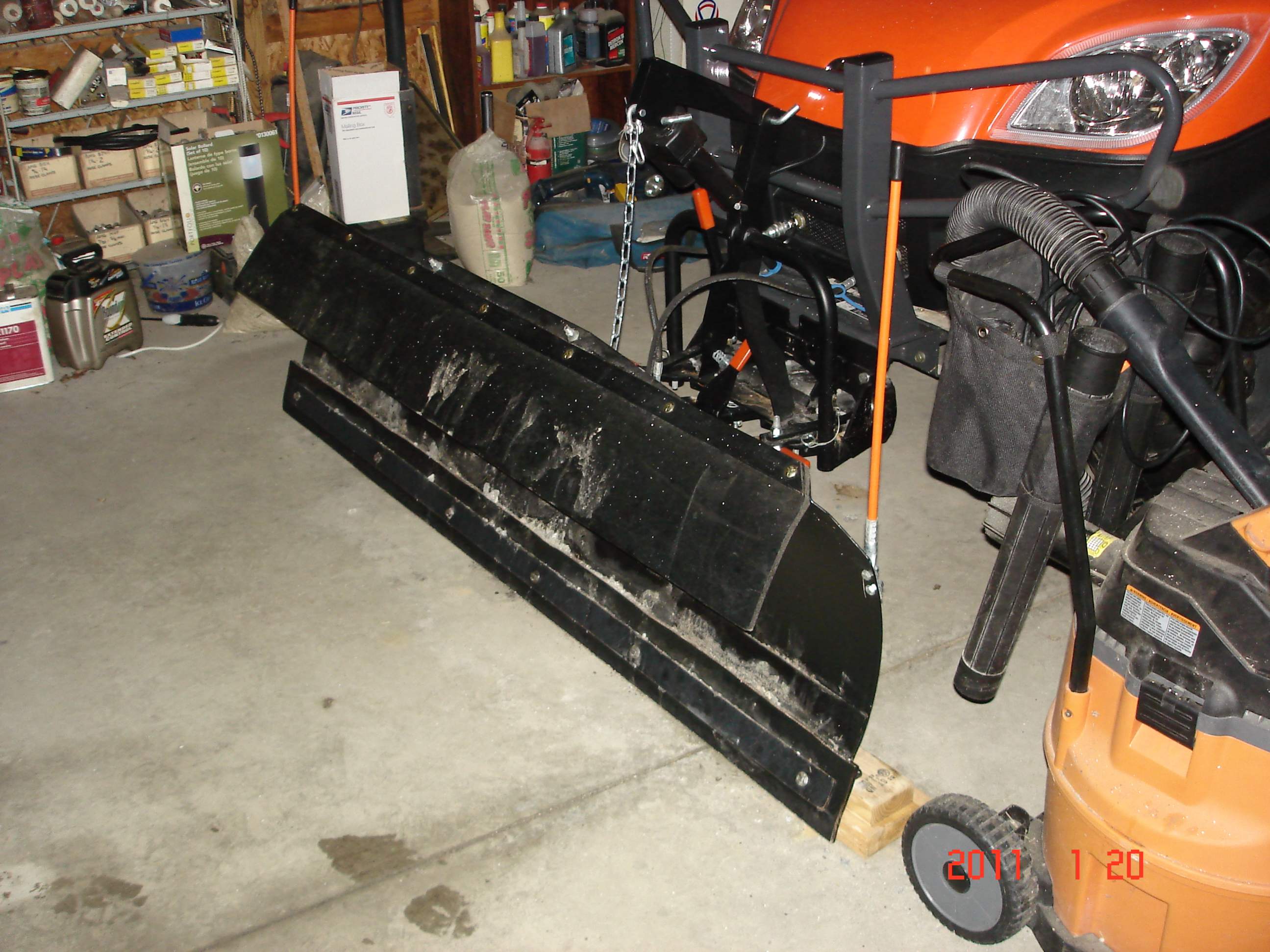

I also have lost my shoes on my Curtis plow and am interested how you put the mat on your plow. Did you put it on top of your wear strip or under it?
I can't see putting on new shoes as they dig in the gravel too much.
Randy
Randy, here's what I did...Posted on an other TBN thread:
I bought 2 piees of 2" by 4' 1/8" steel and welded them together.
Cut it to the width of the plow.
Clamped the home made piece to the cutting edge with the bottoms lined up.
Drill 6 hiles through the bar and the cutting edge (this will wipe out some drill bits depending on your cutting edge).
Cut a piece of 1/4" thick machine belt 6" wide by the width of the plow+1" on each side. The oversize allows it to be flipped over if needed for a fresh edge.
Use the home-made piece as a template to drill the holes in the rubber. be sure to center the piece with 2" top and bottom.
I used an angle grinder to slightly round the outer edge of the cutting edge and the bottom edge so it won't dig into the rubber.
Place the rubber on the cutting edge with the new bar on the outside and assemble with stainless bolts and lock washers.
I pulled the skid shoes all the way up and use them only for a resting point when the machine isn't in use. Place a couple of 2X4's under the shoes so that the rubber doesnt get deformed from sitting.
Done this with and ATV and 2 RTV's. Works great on everything. Doesn't dig up gravel once the ground is somewhat frozen. Won't dig into sod and won't scratch paved driveways.
Can post pictures of the final product if interested.

Timswi,
Thanks ,thats what I need to know. I would be interested in a picture also.
Sometimes a picture is worth a thousand words and clears up the fabrication.
Randy

Here you go Randy: In fact it's going to be used again tonight..Up to 6" coming right now.

Thanks Timswi. I was kind of curious if you used the existing wear plate holes or drilled new ones. It looks like you drilled new ones and clamped the rubber between the wear strip(cutting edge) and the new 2" x 6' strip you made.
Where did you pick up the machine belt?
Randy
Randy
Yes the cutting edge stayed and the rubber is sandwiched between the bar and the edge. Only mod to the original plow is the mounding holes.
The belt came from a friend that works in a mill. His boss let him have a piece of it.
Try to find a new belt as the dry rotted old ones will fall apart. The one I have on it now still looks like the day I installed it..No cracks.
Someone mentiond a stall mat too. I think that TSC has some of these kind of belts, I didn't look close though. Reinforced 1/4" is minimum for a plow of this weight.
