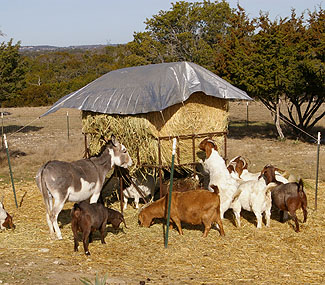

I build these for goats.

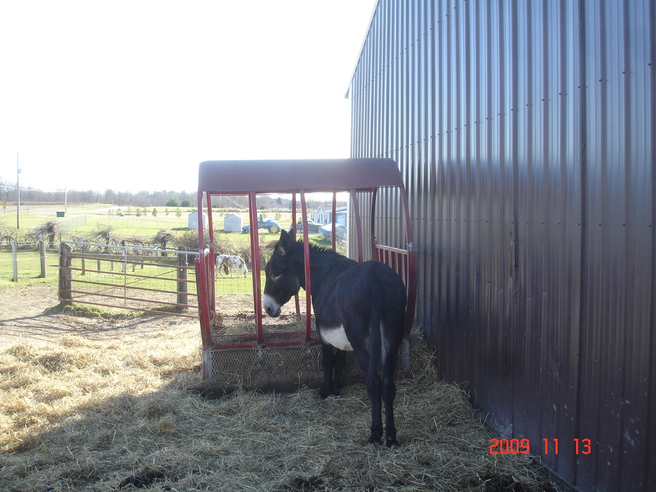

Here's an off ground bale feeder I built back in '06 IIRC. Made it out of conduit reels cut down to 5' diameter. Expanded metal in the bottom so as not to hold water. Sheet metal over top to shed rain & snow. Both ends can be removed to set a bale in. Mounted on skids, and made a 3 pt. tow bar, so as to back up to it, raise the hitch, and tow it to another spot.
Still using it, and have made a couple modifications. Other than needing a new paint job, it has held up well, and horses haven't hurt themselves on it... Yet.....

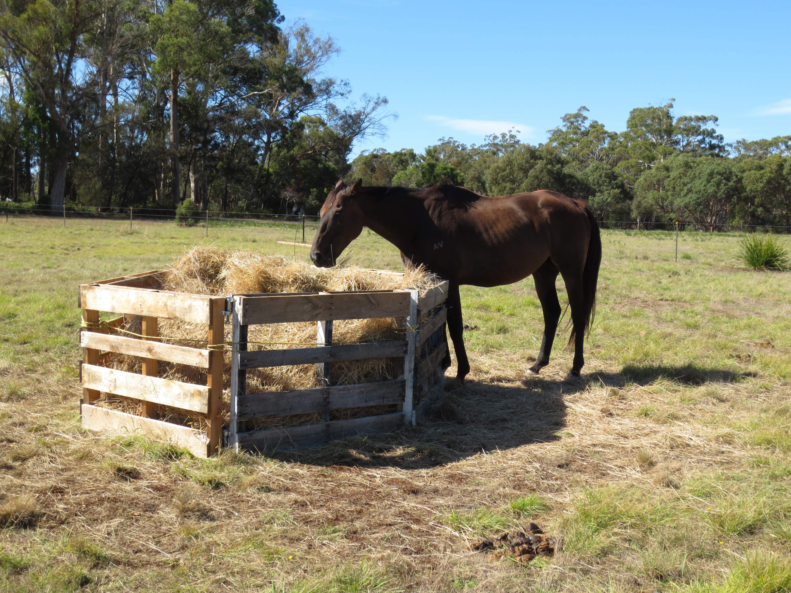

Yep, check out my thread "DIY Hay Feeder" from about a year ago.
I used/recycled 6 wood pallets and it's stood up great through all seasons.

Ta, Mate. I've tarted the assembly up a wee bit since... painted the top rail & linseed-ed the rest to weatherproof, but it works a treat.
I haven't come up with a better way of keeping it together except with the drop pins plus a 'measured' length of rope. The horses will lean/push on it in order to get at the last morsels (I've seen some weird geometrical shapes) but the ring has always stood up and held together.
I initially researched hay rings here in Aus and the prices were astronomical! Supply & demand in a small population. I borrowed a neighbour's cattle hay ring made from aluminium tubing to try it out but the amount of hay spreading = wastage was more than my DIY rig.
The beauty about making 6 sections is that it fits a large 5' round. If you're feeding a smaller round you simply don't use as many sections when assembling.

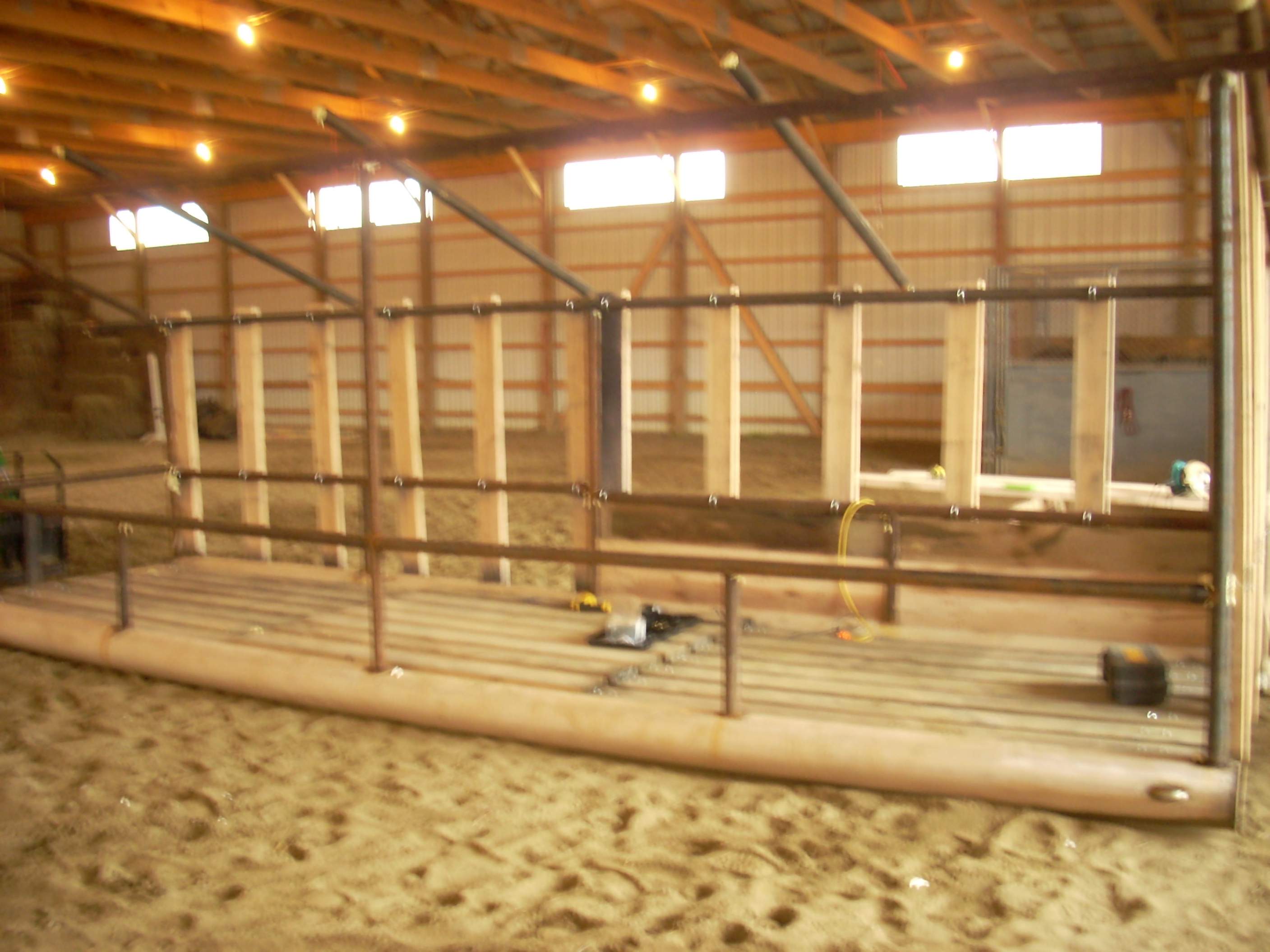

I got some 8" pipe and some 2" pipe to make one. Had to put in 2" plank for head stalls. I also put a roof on it but I can't find a completed picture. I just need to rent an auger and post pounder to be able to put it in and try it out. We have two smaller ones and one large feeder now that have doors in them and they all drive me nuts. The front of the big one in the picture is designed to be installed in the fence line so I don't have to go into the pasture to feed a round bale. Also, the openings are big enough that i can put a full 5x5 bale through. IIRC it is 22' inside and about 66 inches deep.

I don't see why not, Mate.
All I did was measure to the height of my horse's chest (mine are both 16hh TBs) and that gave me the height to cut the pallets down to. I'd use the shortest of your minis as your maximum then.
The purpose of the hay-ring is essentially to keep the animal from 'barging' into the round or bale of hay... the "good stuff" is in the middle and they will tear the bale apart getting to it. They will then foul the perfectly good, but less yummy hay that got in their way and the bale won't last as long as it could've.
If your minis can't reach the middle of the ring then, every so often, you'll just have to rake the middle towards the edges.
