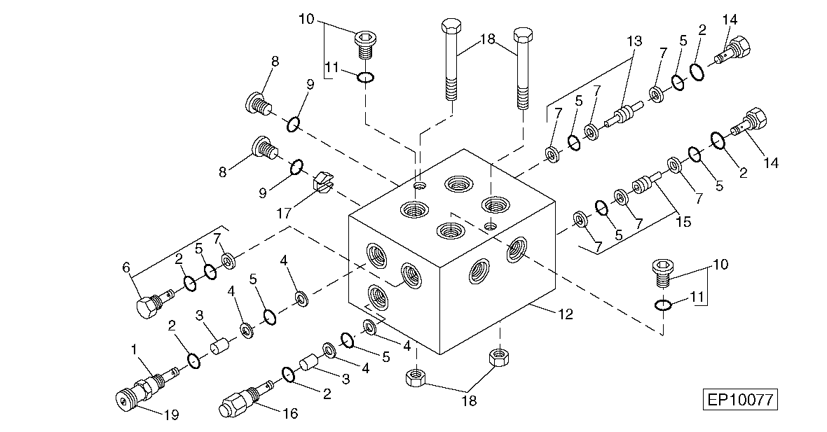

Jerry
Loose bales on a JD 567 baler could be a blown o-ring in one of the tension cylinders or the tension valve. Also it could be that operator does not have hyd pressure on tension valve(parts key 19) adjusted high enough to make a firm bale.
Jim,
Is that something that needs adjustment or checking on a regular basis throughout the haying season? This guy is really good about keeping his equipment in top shape and he takes a lot of pride in doing the job right. This is the first time we've had a problem with any bales he's rolled for us.
   / Round baler advise #22
There is a pressure gauge on RH front of baler. I run my gauge on my 467 at about 1:30-2:00 o'clock on the gauge and sometimes it's difficult to get a bale spear in the bales. What model tractor does he pull baler with as the scv's could be letting pressure bleed off?? My first 467 I put 30,000 bales on it and then traded it for current one to get Netwrap. The newer baler has 14,500 bales on it.
   / Round baler advise #23
I don't recall the model number but his tractor is over 100 HP . You've given me some good questions to ask him before he bales next years. Thanks.
