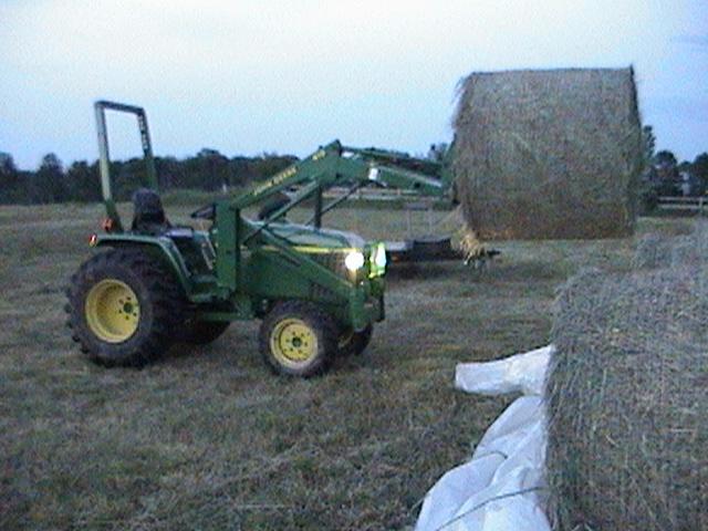

I made this last summer as an experiment. It worked great. Stacked 35 rounds in barn with know problems.

Here is a view without a bale. As you probably noticed I didn't have anything for ballast. The first picture was my first attempt at lifting a bale. I was so excited that everything held together I didn't move the tractor that night. When I started moving bales I had my #7BH attached.

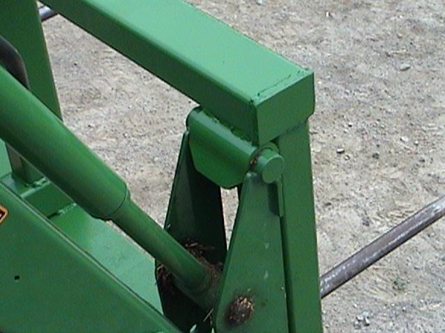

texredneck, Thank you for your praise. I noticed you are a welder/fabricator so I have found some more pics which may be of interest. Making this was a last minute decision. My square baler had a chunk of tree limb go through it which did more damage than I had time to fix so my neighbour round baled my hay for me. I added a receiver at the bottom of the centre brace and have used that as a boom pole connection point. I put that at the bottom so the load would be in tension and not compression. The pictures don't show it but I later added connections on the top corners to attach bracing for the boom pole.

   / Round Bale Spear on JD790/419FEL
Another pic
