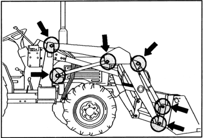

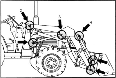

I'll second (third) what Fred and Bird said. I had about 30 or 40 hours on Lucy when I discovered that I had failed to grease the lower two pins on the bucket. Actually sheared the cotter pin when the mounting pin started rotating with the bucket /w3tcompact/icons/tongue.gif.
Somehow, as I had gone around with the grease gun and "missed" those two lower zerks. These days, I count off the zerks as I do them, and don't quit until I get to 6. /w3tcompact/icons/smile.gif
The GlueGuy
   / Rough Loader Hydraulics #9
<font color=blue>I count off the zerks as I do them, and don't quit until I get to 6.</font color=blue>
If I stopped at six, I'd only have one side done. Or is that what you meant? /w3tcompact/icons/crazy.gif
   / Rough Loader Hydraulics #10
Roger that Harv. /w3tcompact/icons/crazy.gif See? There's six little arrows on your drawing! It's just like that (only backward) on the other side.... I was missing the one labeled #6.
