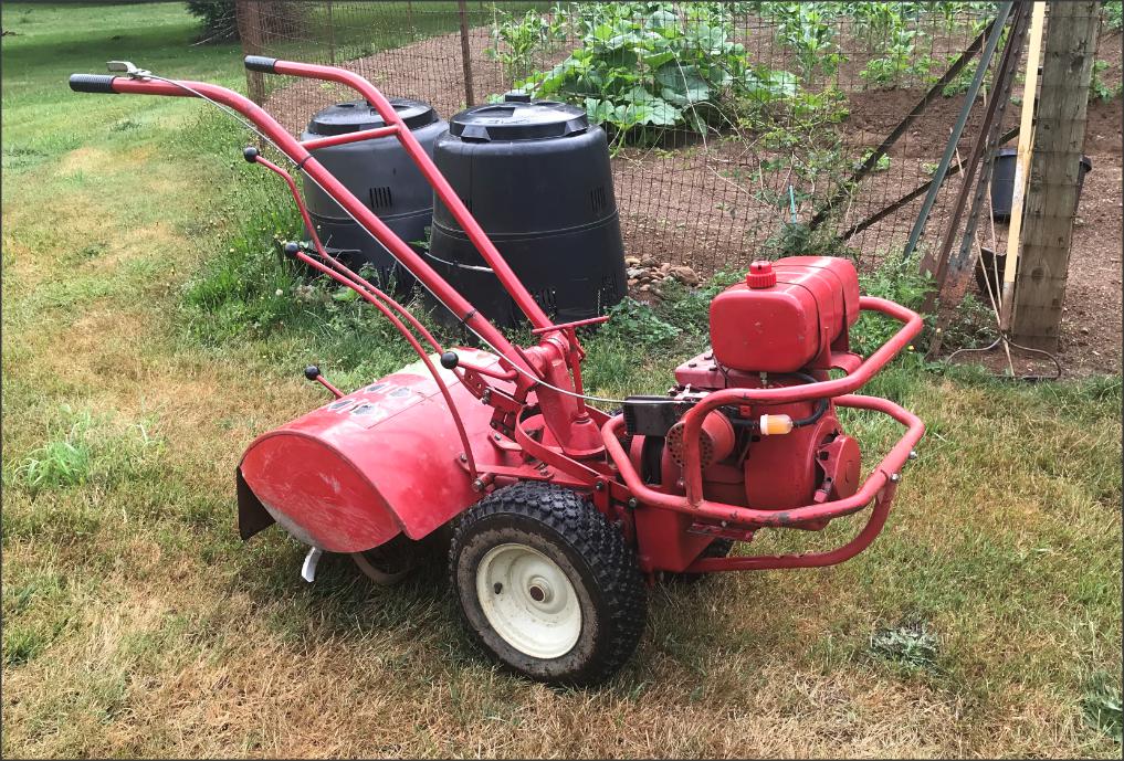

I use 48 inch PTO tiller at the start and end of gardening season and one of these in-between during the summer as needed!
It's mostly about weed control due to our long spring & fall and mild winters.
The name "Horse" fits:
It's kinda tough to hang onto when approaching 80.

I use my 60" PTO tiller to prep the garden and to get it ready for cover in the fall. It is also good for breaking up sod. The troy built pony is great for cultivation and prepping rows for planting.
Have had both horse and pony troy built tillers, both are a real handful trying to break up sod and unworked ground, the PTO tiller will not try to yank your arms off in that situation. You can get done in an hour what would take you days to do with a walk behind.
Both types have their place and I would not choose to be without either one.
   / Rototiller PTO vs stand alone #26
I have an '82 Troy Bilt 8hp Horse. True - at times it can be called a "Wild Horse". It can get up on top of tough unbroken ground and go off just like a wild horse. Not a creature to be handled by your little wife or a youngster. However - with a tight hand it can open remarkable areas.
AND the next day you just might feel like somebody tried to pull your arms out at their sockets.
I have never had a PTO driven tiller. BUT - there sure are those times when I wished I did.
