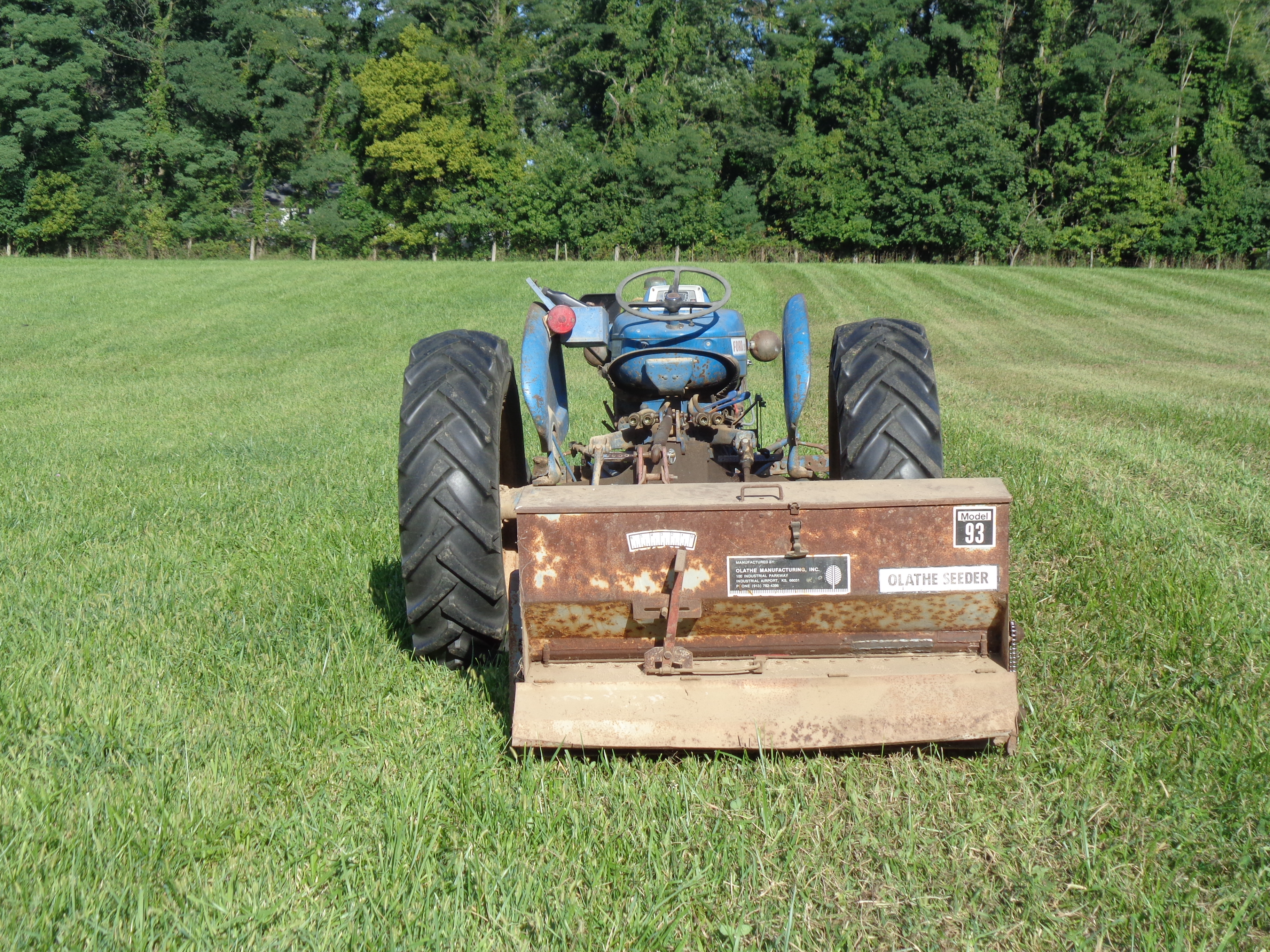

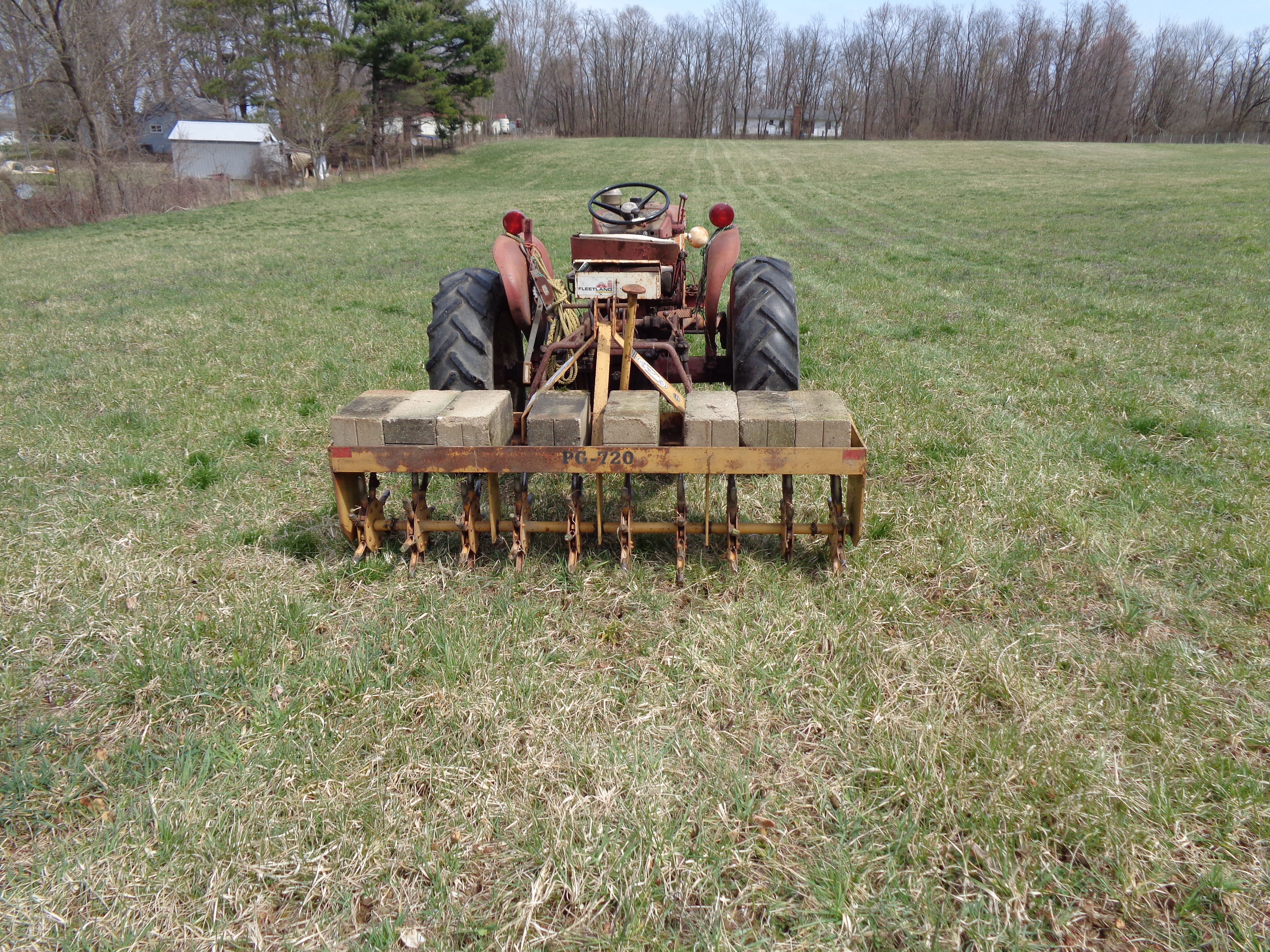

With my small acreage here, I keep everything in production all of the time. I seed in existing stands using 2 different methods. Frost seeding, and direct seeding using a slit seeder, which I own. Neihter are pretty, but work great. For eliminating compaction, I use a 6' aerator, normally in mid-April, when the soil has some decent moisture, yet pretty solid. I make 2 passes running perpendicular to each other, and makes a big difference. All of these tools are well worth the storage space they take up, to kep fields up to snuff.

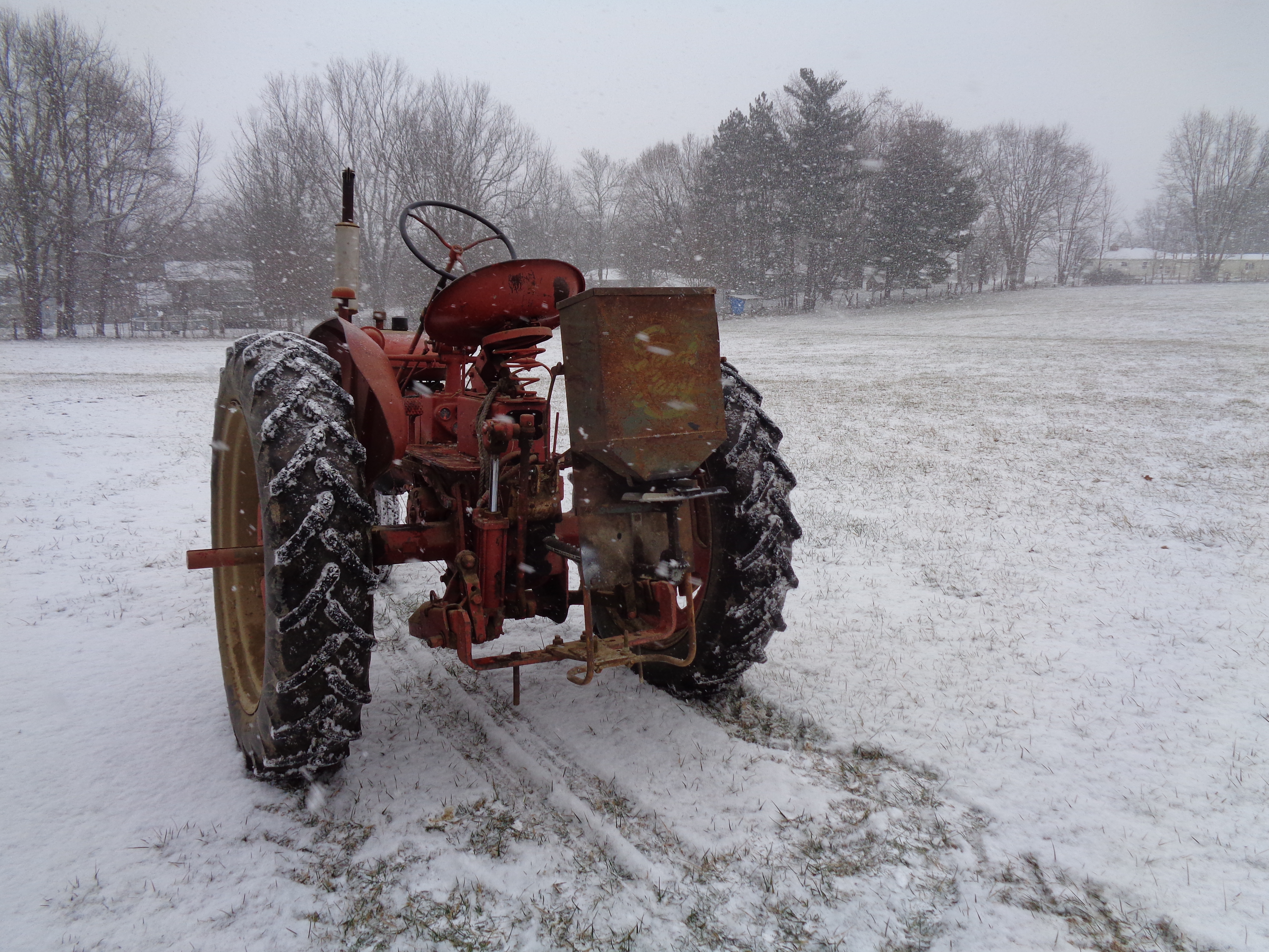

On Feb. 14th of this year, I frost seeded a section of the hayfield that had become infested with thistles, that had drifted in from a neighboring property. I'd done a total kill on it last Fall, after mowing it down tight. NOAAH Weather had predicted a 10% chance of snow, and temps to drop to 18コ that night. Perfect weather for frost seeding. As you can see in the picture, we got a pretty good skiff of snow. Temps did get down to 18コ, but the seed was on top of the snow. I gambled that from that point on,surely we'd get cold enough temps.after the snow melted, to get cold enough to honeycomb the ground, to pull the seed in. That didn't happen. And, this is the first year,in 20 some years I've frost seeded, that I had an 80% failure of frost seeding.I eneded up disking it up in the Spring, and re-seeding, but that,and another section I did the same thing too were pretty much out of production this year.
