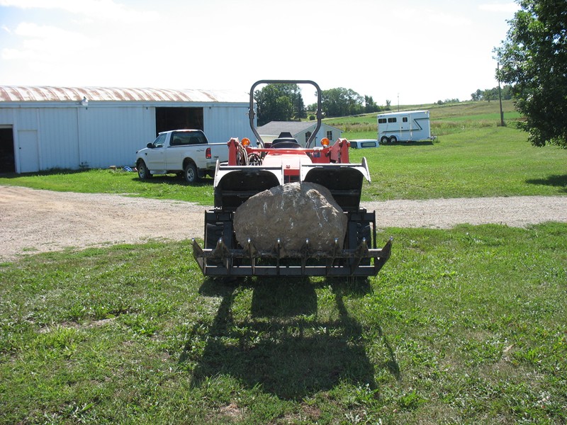

Talking about rocks: I find the very large ones are not a problem after you find them. It's the small ones that get thrown up and jamb between the teeth and the frame that really cause trouble.:D
