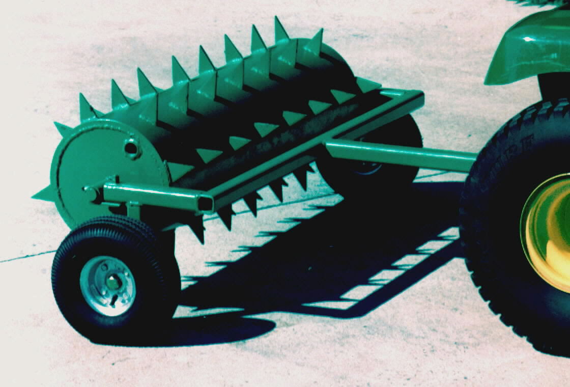

I'm thinking about making one of these (but much smaller).

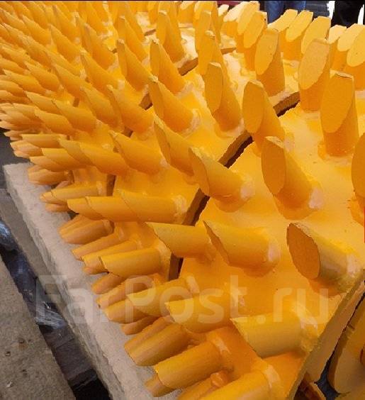

I'm thinking of making two 18" wide spiked wheels. I figure I could use two pieces of 12" pipe with plates welded on each end with flange bearings on each end. Each one would be articulating enough to make up for unevenness of the road. It will be 3pth hitch mounted so it'll have to have enough weight to break up the ice on the dirt driveway. It would look kind of like a harley rake but not powered and not the full width. What I haven't figured out is what to use for teeth. I would like find some that are threaded so they could be removed when they wear. Does anyone have any ideas?
Here's a look at a different brand. These are make for highway use by much heavier equipment moving at much faster speeds. This one just looks like you replace each wheel when they wear. One of the mfgs say they last 5 years but that seams overly optimistic unless they are harden steel.

I'm wondering if I use a cold drawn rod, say 3/4" or 1" in diameter for the spikes if that would work and last. If needing replacement I would have to torch them off and grind off any remaining weld. But I should be able to make the teeth like in that middle picture. I don't have any thick wall tube so I'd have to buy it. I'm thinking I could end up with $400 (or more) in steel into this so I want to plan it out.

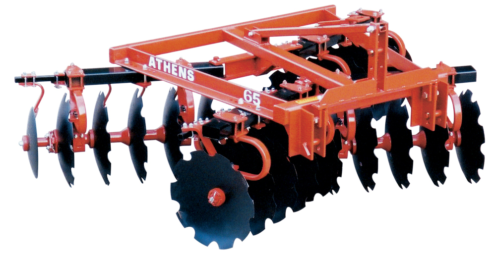

Disk harrows with spikes welded on the pans?

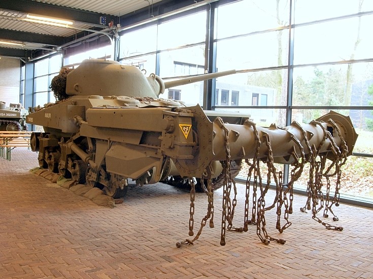

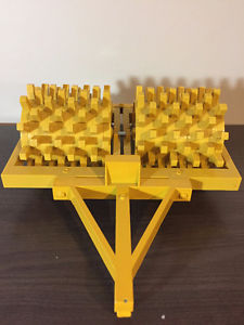

The first one should be interesting! The last one most easily tried. The in between ones come in different sises. Pulling uphill may be an issue with the last three.
/ rotating spiked ice breaker #12
Dude! I'd love to see a video of that first one in action!

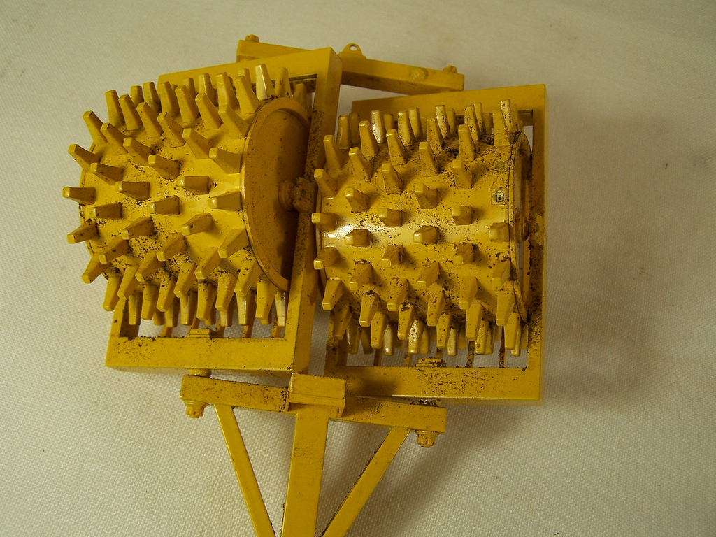

Egon those middle two are kind of what I had in mind but just less spikes and with weight above them. The two "wheels" would be spaced further apart to about the tread width of a car.

Looking at that second pic, how about a 45 gallon drum filled with cement, and then driving rebar spikes into the sides before it dries. Should be plenty heavy or a two foot diameter pipe instead.
