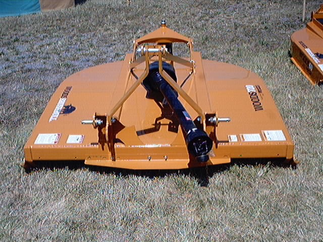

Re: Rotary Cutters-Woods BrushBull 60 & 72
Woods BrushBull 60 & 72 - Standard/Light Duty Rotary Cutters[/i]
"You are what you eat, drink, think, say and do..."
/ Rotary Cutters #43
Woods BrushBull 60
The rear discharge skirt on the Woods is a better design than JD X13 series, for AG purposes {not OSHA}, removing/opening the Woods rear deflector allows a better dispersion of debris...
Remember these are light duty units designed to cut intermittently up to 1" and should last quite awhile if used as their intended purpose and if not abused as in the above JD513 picture I had previously posted...
