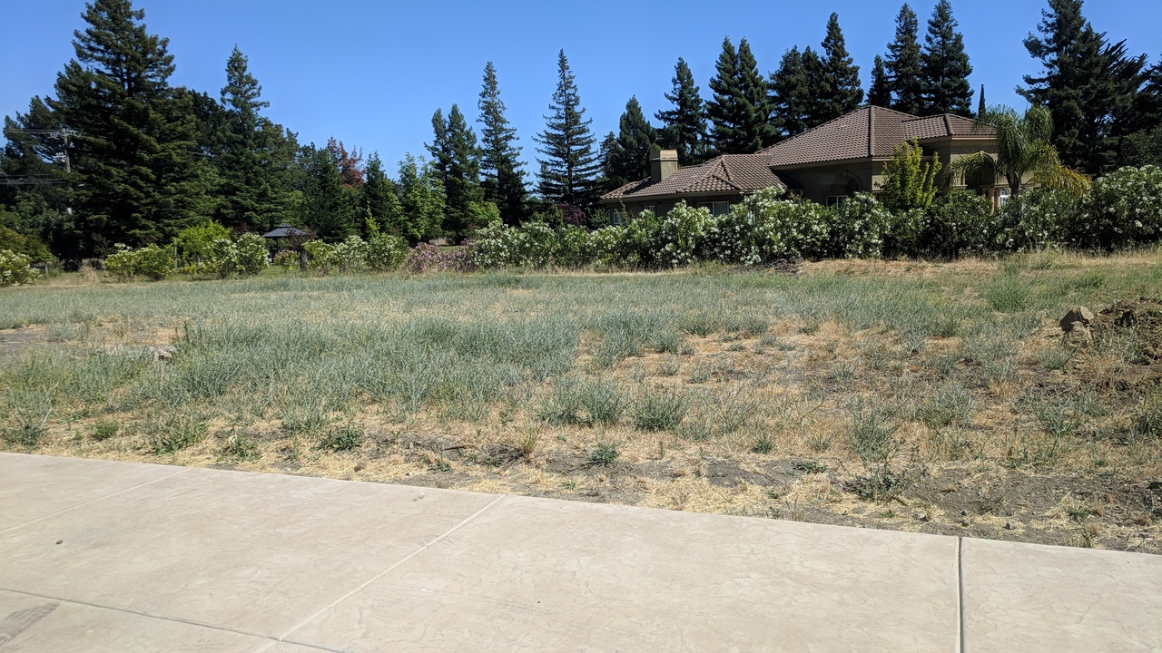

Hi all. I bought a rotary cutter for my subcompact to keep the weeds down until I can landscape on my two acre lot. I'd like to get as close to the house as much as possible. I plan to put 4 by 8s in front of windows and patio doors (I have a lot of windows) when cutting by house and then check the area for rocks and objects ahead of cutting.
My question. Do rotary cutters fling in all directions? I've read that the rear should be set higher to allow for material to escape so I was going to avoid driving directly away from the house and do most of the cutting runs in parallel.
My thoughts:
1. Check the area for objects that may fling.
2. Set the cutter high (no need to cut flush to the ground).
Put chains in both the front and the back, and you won't get much, if any, flinging.
Ralph
