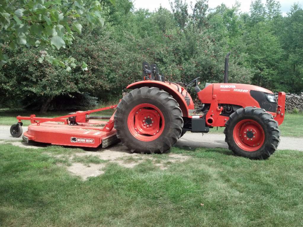

I've got a Brush hog BH 27 7' with chain guards and single tail wheel they are very long. If you have a lot of obstacles to more around get the single tail wheel even though it's longer. I think TripleR gave me this advice and I'm glad I did or I would have destroyed one or both arms of a dual wheel. And if your looking at a medium or heavy duty heavy. 1300 lbs and up they brush hog recommends a 55 pto hp and up for this series. If your mowing only field grass you might be alright start running over any 3" brush and you'll probably stall out I've. 6-7 foot adds $1000 to the price of new implements on the landpride, bh, woods. Light to medium duty also adds close to $1000.
You'd probably be happier with a 6 foot if you want the medium duty especially if mowing anything other than grass or light brush.
   / rotary cutter size & recommendation for 4047, will 7' work? #13
Yeah, I think a 7' single spindle is longer than an 8' dual spindle!!! My 10' dual spindle has 4 wheels. I gotta be very careful to keep them out of things when turning or backing into areas.
I'll bet your 8540 plays with the 7'.
Great photo too Dave. I always remove my FEL when doing any cutting. Hard enough for me to keep track of tail wheels without worrying about running the FEL into stuff.
   / rotary cutter size & recommendation for 4047, will 7' work? #14
Thanks Richard,
Taking the FEL off for me is a must as well If that Brush hog was any heavier i would definitely have to have weights for the front. I would have bought a Dual spindle but 8' is to wide for most of my paths used ones were more abundant that the 7 footers in this area. seems like everyone either gets a a 6 foot or moves up to an 8 or 10 footer
