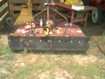

i made a guard out of 4 bucks worth of semi-truck mudflaps.. and about 11 bucks worth of perfed angle iron and nut/bolt hardware... works awesome.

I also built mine with truck mud flaps..work next to a trucking co. They told me the flaps get replaced on a a scheduled basis ( they buy them by the skid ) so they had a pile of junks one , but some were in great shape..got'em for free. I used some angle steel , bolts/fender washers. The flaps cut like butter on a band saw, had about $40.00 into it both front and rear..

The chains do not get hung up on anything, however, I bent the metal on the back of my RC and the blades do slap the end of the chains occassionally when I am backing up.
My cutter originally came with guard on the back made of conveyor belt, however, after backing into brush and thick stuff this material did not last long, thus the reason I replaced with chains. I also added optional chains on the front of the RC and they do a great job of eliminating debris from flying out of the front while cutting.
I thought about adding the screen material to the back of my ROPS, but decided on the chains for the front of the RC instead and am glad I went this route. If you use a winch on the back of your tractor you may want to consider the heavy screen though to reduce the possibility of a flying winch cable slapping you if you operate the winch while in the tractor seat. I operate my winch while I am standing beside my tractor.
The chain option for my RC (Brown 484) was appx. $150 for each end

If you are mowing around anything valuable (people, vehicles, buildings, livestock, etc.) then I wouldn't leave the back open. At a minimum, use the inexpensive mudflap idea.
