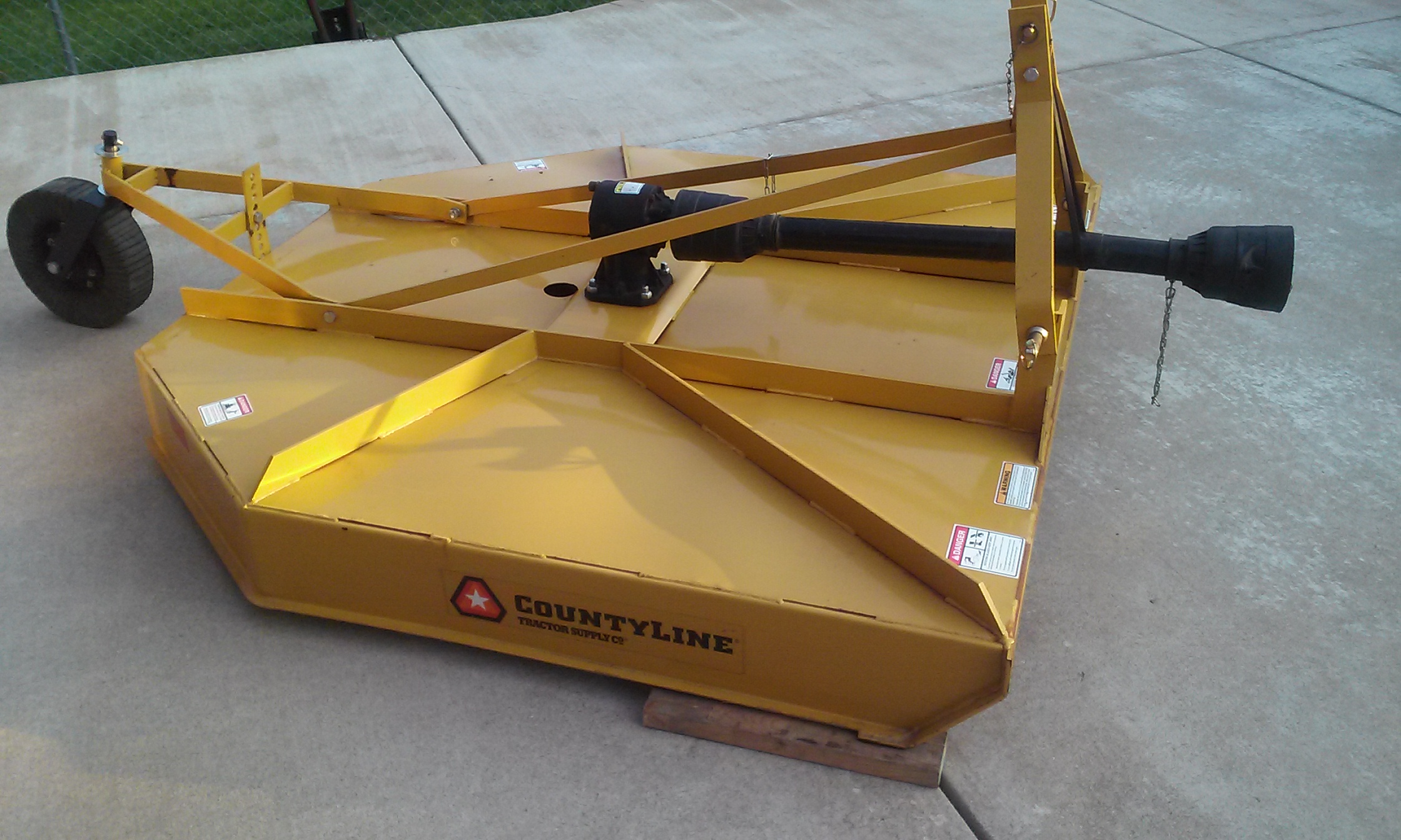

That is a good thought and you are on the right track. The blades are free, no binding or sticking. I think the problem is prior to engagement of the PTO when one or both blades are resting in toward center of cutter the initial centrifugal force throwing one or more blades outward is too much for the shear pin. I would suspect one blade toward center and the other one in normal position prior to start up creates an imbalance causing the violent shaking of the deck and the sheared pin.

I don`t think most of these people know how hard these ptos hit with the electric pto switch. My tractor has electric pto switch, but my bushhog has a slip clutch. I can see how this would shear a bolt. The best remedy is to install a slip clutch.

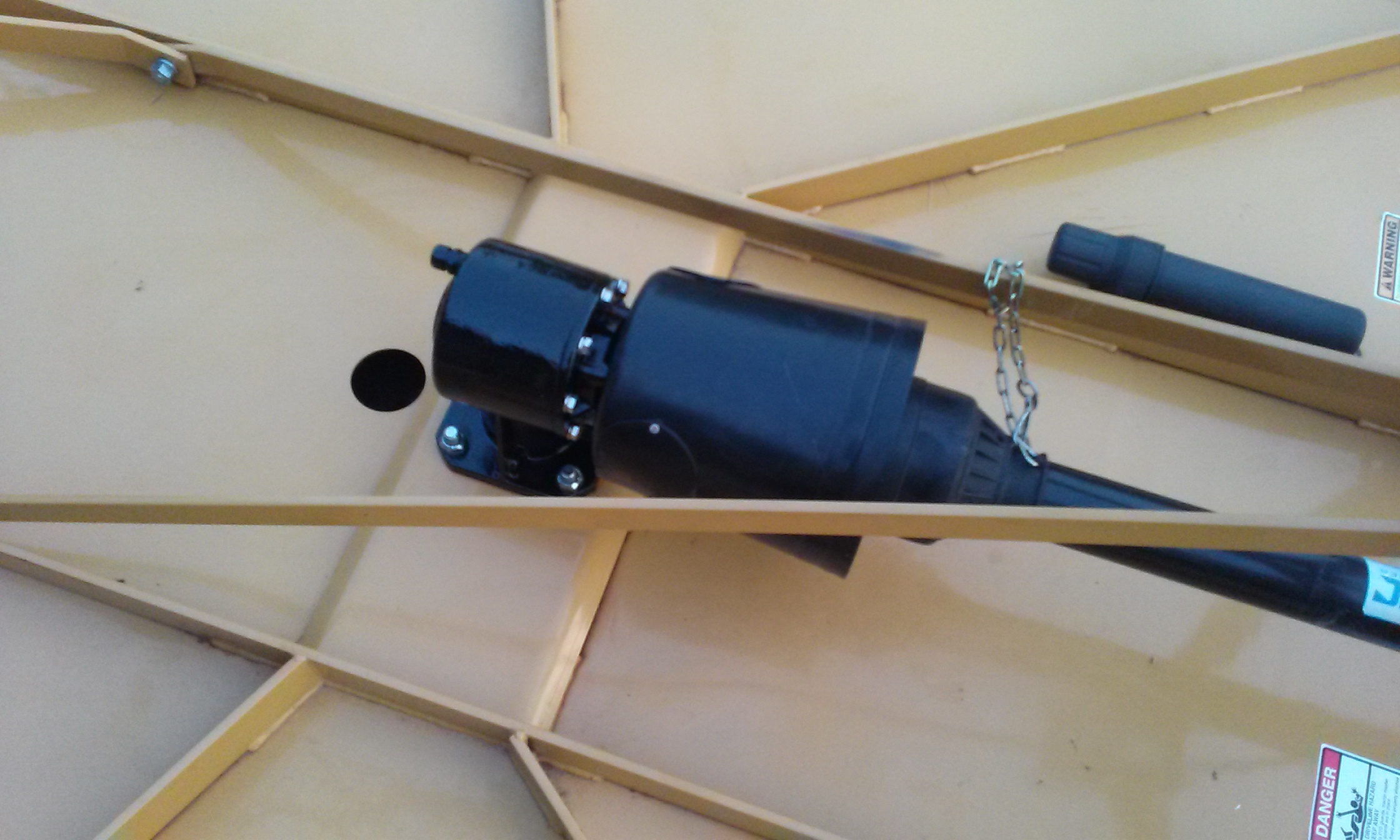

I installed a new slip clutch today. I repainted the mower gear box and replaced the rusted bolts on it with stainless steel. Installed a drum shield and shortened the PTO shaft 4". I haven't used it yet but probably will in a week or so if the rain holds off.

Before and after adding slip clutch.
