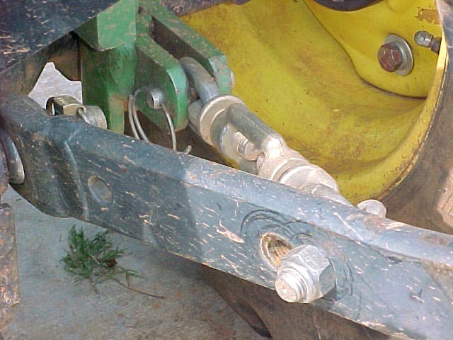

I need some help. Just got a 4 foot KK rotary cutter and mounted it on my tractor. I'm having trouble with the 3 pt arms contacting the inside of the rear tires. I've got the R4's and the eye bolt connection to the arms is hitting on the tire cleats. I'm sure its an adjustment....but can't figure out how to do it.
/ Rotary Cutter Problem #2
Each lift arm has (or should have) a sway "chain" (eye bolt is probably part of the sway chain) that limits how far the arm can swing toward midline. A turnbuckle arrangement is common, but there are others as well. With the tractor off, and the cutter in the air, push the cutter to the right. If it can contact the tire, then the left sway chain needs to be shortened. Shorten it until the cutter can no longer touch the tire. Then do the same for the opposite side. You see, the sway chain on the left lift arm limits implement motion to the right and vice-a-versa.
What if you shorten the sway chains as short as they will go, and the arms still contact the tires? Your lift arms may have another hole an inch or so away (toward the implement) that you can attach the sway chain to. You can see, I have done that on my tractor. Make the change and readjust. That should do the trick. If contact still occurs, then you may need to try to shorten the sway chains somehow.
Good luck.
OkieG

Thanks OkieG.....shortening the turnbuckles did the trick! It does look like the 3 pt pins could be turned in if necessary, but I think this will do the job for now.
