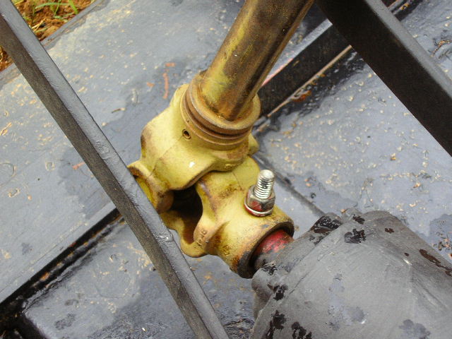

HEre is a shot of my TSC brand BH. Smooth shaft and a shearbolt.
Rob
