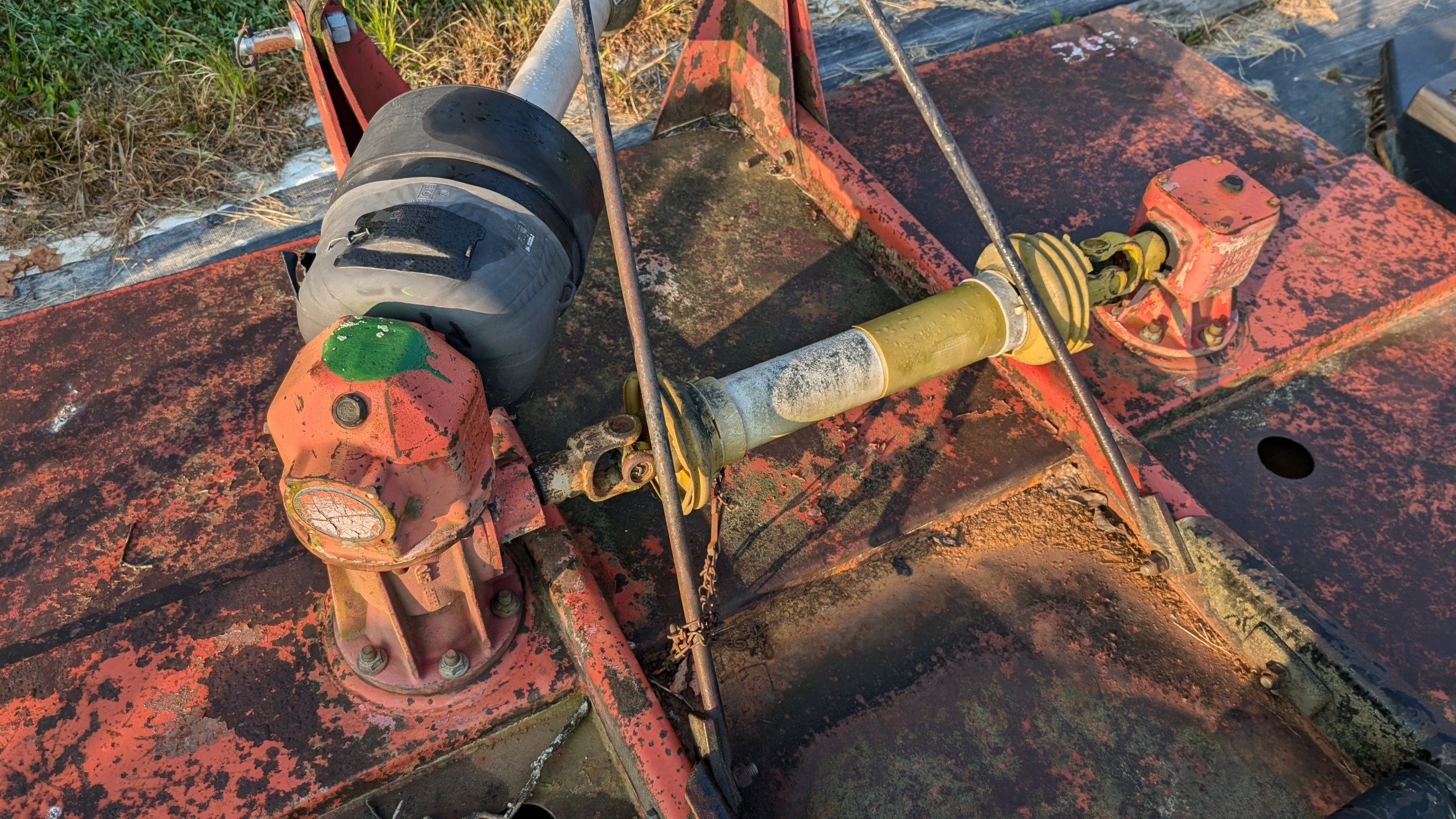

Was it new from the dealer or used? I watched a Tractor Mike video where he said he's seen guys pack an old gearbox that might have been leaking or worn with grease to get more life out of it.
Apparently it is a thing and works, as you are now testifying also.
   / Rotary cutter gearbox
#12
It came new from the dealer like this. Quite a bit of time passed before I checked it and saw that it was grease. Now 10 years have passed and it just made me curious. I’m going to do some mowing today and check to see what it looks like immediately after use.
   / Rotary cutter gearbox #13
I don't have anything to add to your specific situation, but if I had a gearbox that was leaking (with 80/90 oil), I would add a little cornhead grease. grease, or straight STP just to keep things full and "oily".
   / Rotary cutter gearbox #14
Some guys fill the gear box with grease because they have a leak and
grease don't leak out
willy
   / Rotary cutter gearbox #15
John Deere Corn Head Grease is the best solution for leaky seals. I put a green spot on the gear boxes with grease to remind myself.
No problems in 20 years.
   / Rotary cutter gearbox #16
   / Rotary cutter gearbox #17
I've been using corn head grease in gearboxes like that for over 25 years,no problem so far.You could always add a little gear oil to thin the grease if you wanted.New Holland for example originally used gear oil in their hay rake gearboxes but now say to use corn head grease.
   / Rotary cutter gearbox #18
My cutter uses the grease, and that's what is specified in the owner's manual. But I couldn't find a source for the grease - no one around here carried it. So I called the cutter manufacturer for advice and they told me if no NLGI Grade 0 grease is available then just use the heaviest gear oil you can find. Been running that mower for 25 years now; no leaks and no problems with the gearbox.
Most John Deere dealers carry what they call "corn head grease." I bought mine online (ebay), and replaced the 85W90 oil in my Ironcraft cutter.
   / Rotary cutter gearbox #19
Its been covered on other threads here - people open their gearbox or chain/gear drive on roto-tillers only to find grease rather than oil. I can't quickly find threads but people got responses from suppliers that the book may say oil but they made the change to Type 0 grease (which is most commonly found as John Deere corn head grease) due to customers seeing oil seeping past seals. Type 0 grease is a popular solution to leaking - all the similar gearboxes of my farm equipment have been changed to grease and I keep a supply of the grease on hand. Remember, it has to be Type 0 or John Deere Corn Head Grease. There are equivalents from other manufacturers like AGCO but I can't identify them all.
   / Rotary cutter gearbox #20
00 corn head grease. It will remain a semi fluid and lube wwll without sneaking away through seals. I use it in all of my gearboxes and it is available in grease gun tubes from JD.
